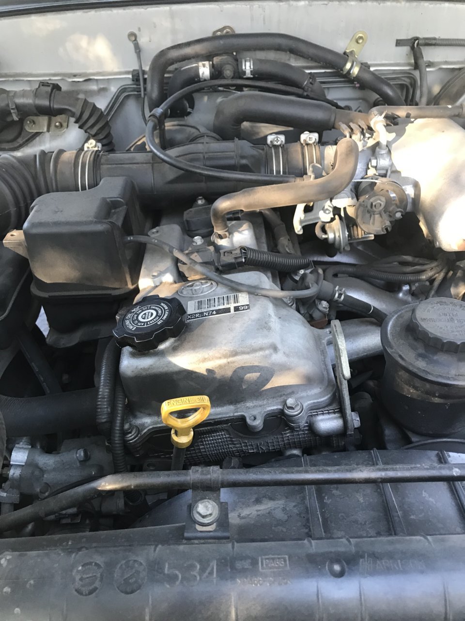

    2003 Tacoma 2.4l, 118k miles. Noticed engine tilt lately. No other symptoms yet, really. Cause for concern? Anyone had there’s replaced? Any idea of cost? So.Cal.

    These motors have a tilt to them normally. This looks just like mine except cleaner.

    Pry up on the right side of the engine near the mount. if it lifts time for a new mount..
    The cost depends if they flat rate or bill by the hour
