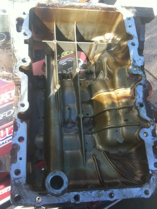

    Since I last changed my oil, I have since noticed slight drops of motor oil on the garage floor. Got under the truck and looked and its surely coming from the motor oil pan but I'm unsure where exactly. Nearly all the oil pan bolts as well as the drain bolt have oil on them. I did not replace the drain plug gasket last time so this may be it. But there is oil all around the seal of the pan too so I'm unsure if that could be it and it is just flowing downwards to the plug causing that to be wet. The pan looks like its sealed with silicone rather than a gasket so I didn't think this was possible to leak here!
    Does anyone have any suggestions or ideas? It's such a small amount of oil loss I haven't been concerned but now it's finally time to change the oil again so I wanna get it fixed. I have cleaned up the whole area really well and am gonna check it again tomorrow to hopefully see more clearly where the leak is from after driving it.
    The truck is a 2010 with the 4.0 and just over 60k on it. I've been using full synthetic oil the past few changes.

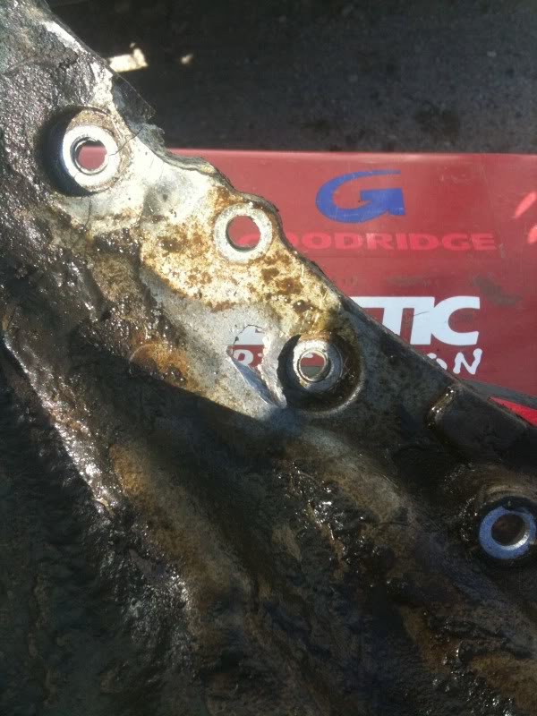

    I just looked at it underneath it today and oil is definitely seeping out of the seam of the oil pan where the silicone/gasket is towards the bed of the truck. Apparently my Platinum Warranty is coverage up to 65,000 miles, so I'm taking it in tomorrow! Ill keep y'all posted
