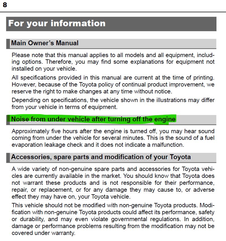

    Like Page 7?
    Edit, close!

    Leak check

    Hey, does anybody know how to disable this feature, or to create a condition where this check does not occur? -- I go car camping a lot, and I sleep in the truck bed in a camper shell. This stupid goddamn fuel evap check always kicks on in the middle of the night and wakes me up. I would LOVE to be able to disable this thing so it doesn't kick on and wake me up in the middle of the night. -- 2014 4 cyl 2.7 --- P.S. I live in Utah, no state inspection here, so I'm not concerned about passing/failing emissions inspection.
