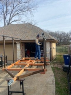

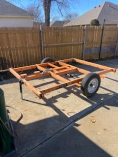

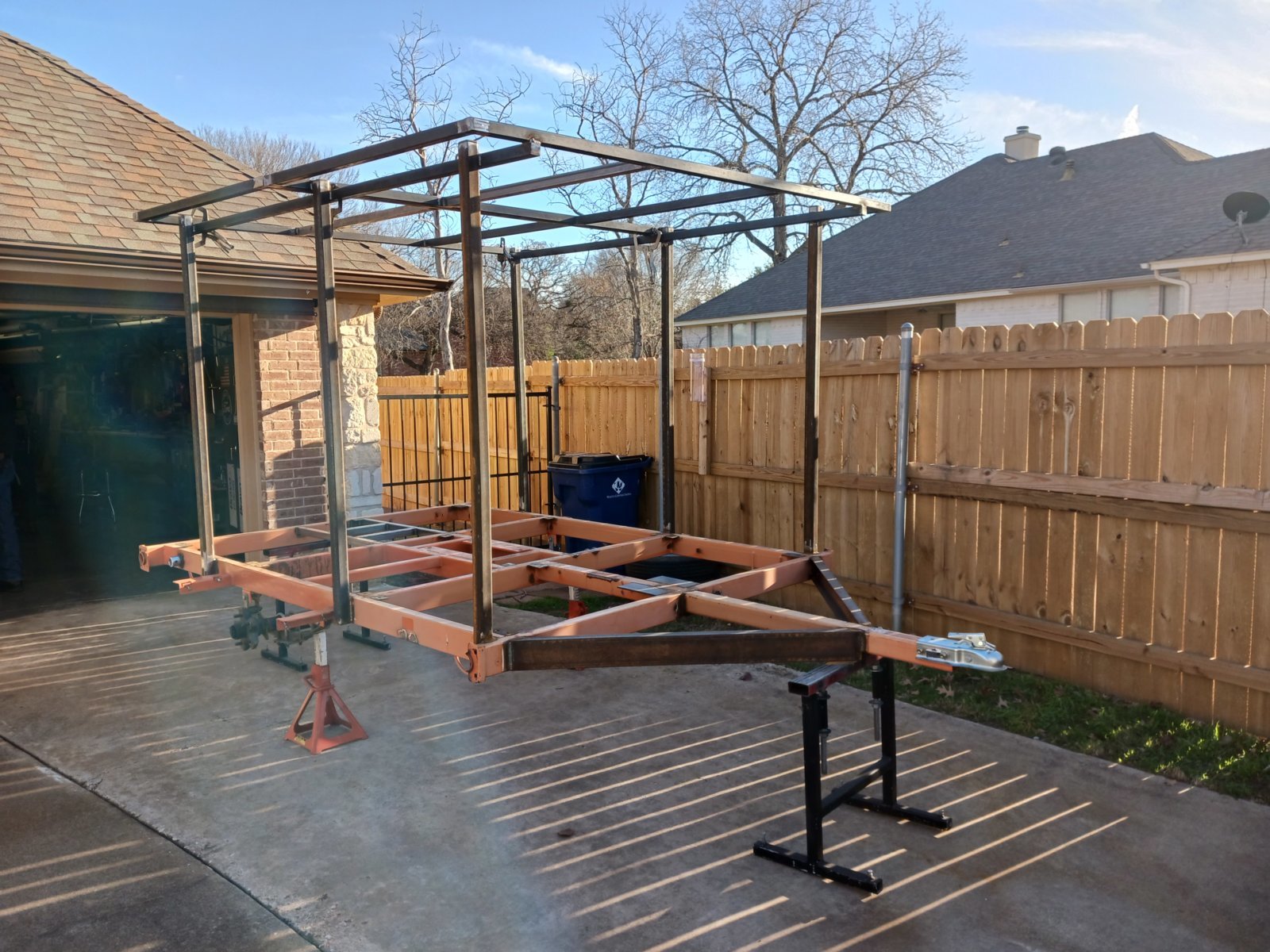

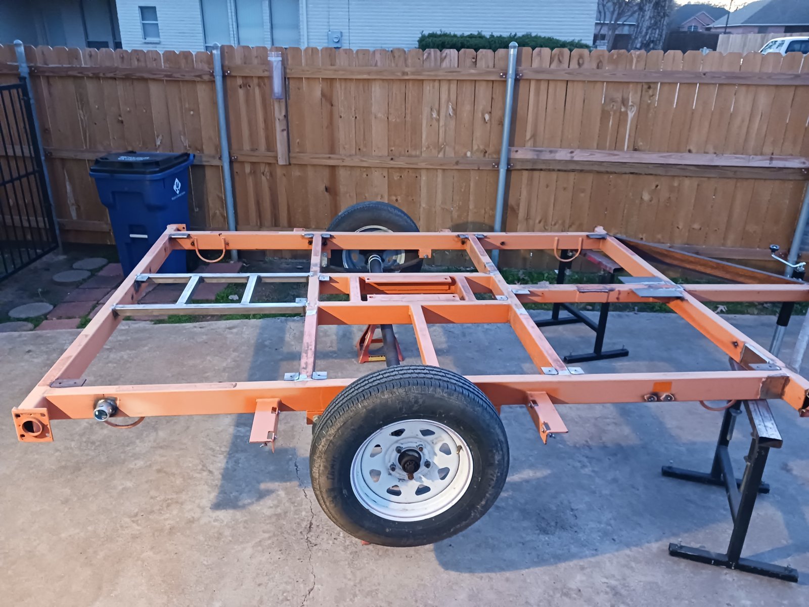

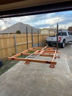

    Hey taco bros, I was looking and trying to get out camping and enjoying my bike. I wanted to create some thing that is a dual purpose trailer. I started looking through endless forums and images. It was like a rabbit hole. So with a bike in the garage and a taco in the drive I started to build. I'm don't have the bottomless wallet so it had to be a budget build. I listed what I needed and wanted for the trailer to do. Haul bike. Platform for tent. Now I don't have a grand to shell out for a RTT, so I made a platform for a conventional ground tent. A place to keep gear, water, gas. So I started to collect pieces to do this. A buddy had a old road closure sign trailer. After looking at it, it will work. I flat topped it and made a new tongue for it. I had an old toolbox from a previous truck that will work for storage. I had some metal from some previous work, and started. It's a weekend project and is not finished but in progress. But I will be able to ride my bike on to it strap it down. Go anywhere and camp and have whatever I need to have a blast. Hope this helps out anyone out there looking for similar trailers
