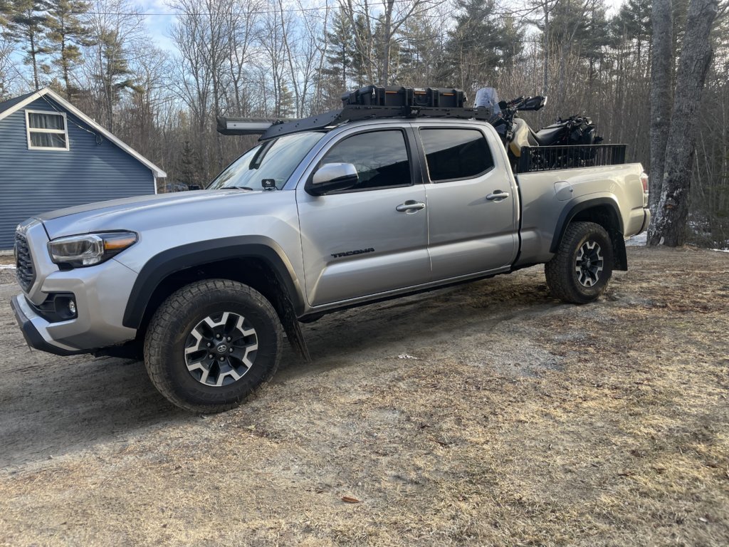

    In the bed
    Obvious answer.
    Photo by kywoodsrider
    Pros:
    • No additional gear required
    Tradeoffs:
    • Don't think it will fit under my Leer 180 shell
    • If it does, limits what else I can put in the bed
    Question:
    • Has anyone had success loading a motorcycle in a bed backwards and leaving the tailgate down? This approach would let me fit 90% of the bike under the shell and leave the handlebars/front tire exposed since they don't fit but seems sketchy.

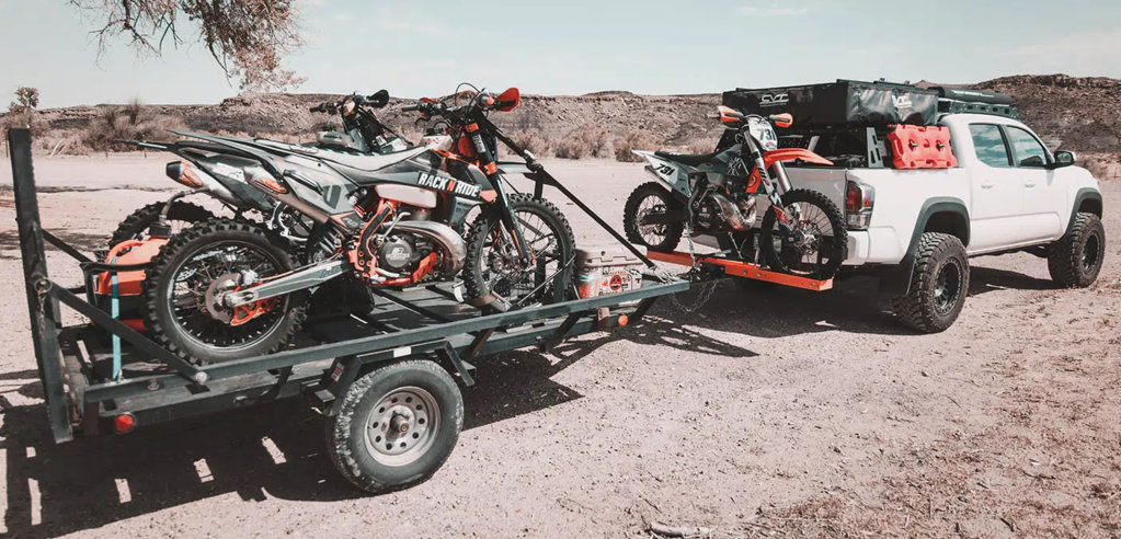

    Trailer
    Obvious answer.
    Pros:
    • Secure, stable platform
    Trade-offs:
    • Price ($1k+)
    • Limited storability depending on model
    • Target for theft?
    • Reduction in off-road capability while towing
    Questions:
    • Open vs enclosed?
    • Reviews on the kendon foldable?

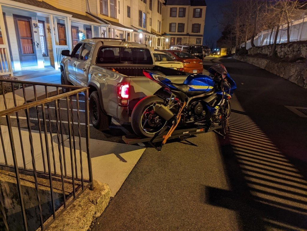

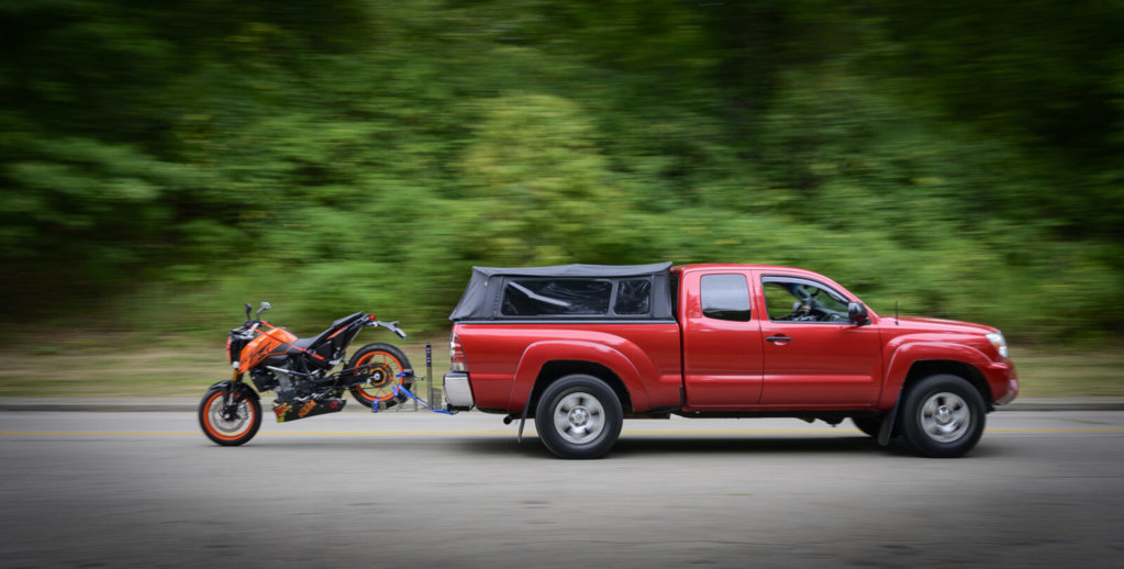

    Hitch Carrier
    I want this to work but it seems sketch
    Pros:
    • Like a bike rack, but for motos
    Trade-offs:
    • Bike + carrier = 578 lbs = 90% of 3rd gen tongue weight max
    • 578 lbs is 40-50% of payload capacity, getting truck close to max with other items
    • Forums suggest high moment load on an extended lever would make that 578 lbs feel like 1200+ lbs over bumps to your hitch and rear leafs. Best case it works rear suspension and body hard. Worst case it bends/breaks the truck or the carrier itself breaks and the bike falls off.
    Question:
    • Has anyone used a hitch carrier on a 3rd gen on a 300+ mile highway trip? How did it go?

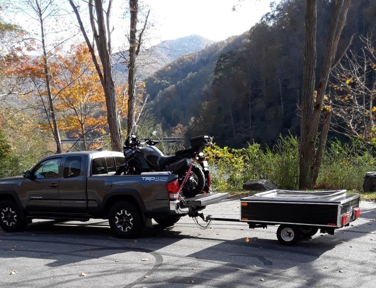

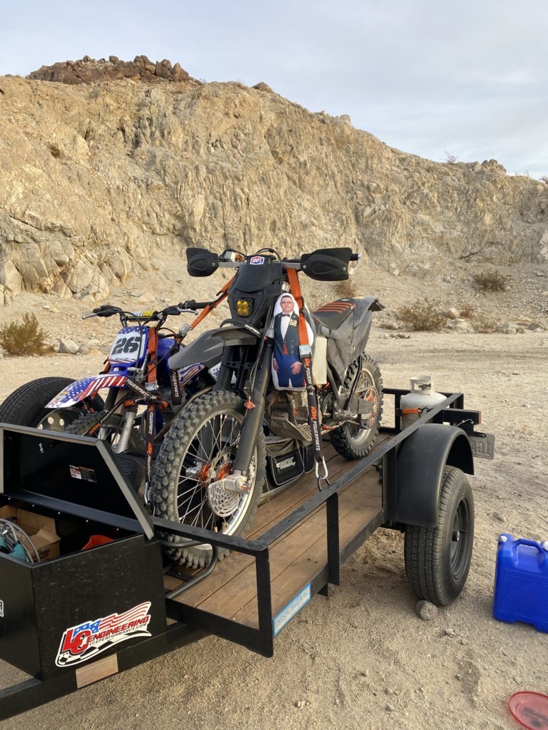

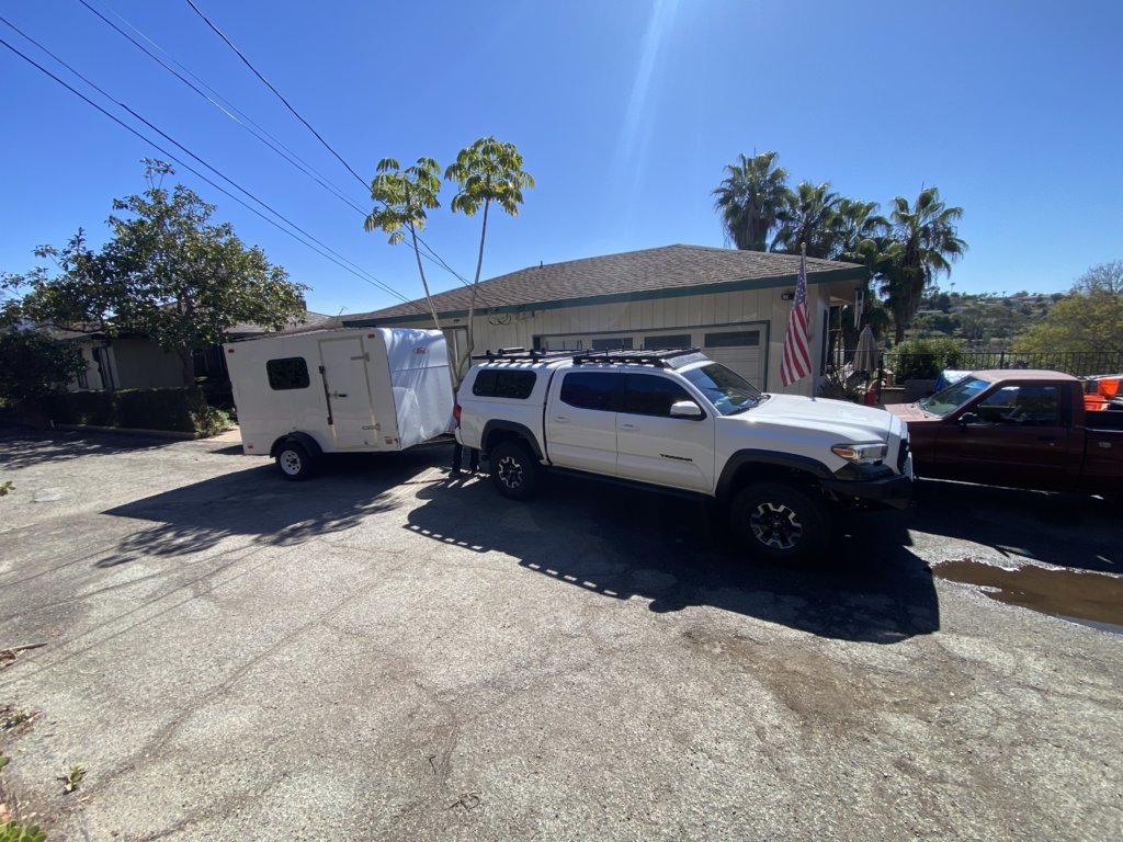

    IMG_8653.jpg IMG_8481.jpg OP- Bike will not fit under a shell, the “hitch hauler” method “works” but rides horribly and bar ends will contact camper shell window(bye bye window). I have a 5x8 utility trailer for day trips and an enclosed cargo(converted) 6x10 for overnight dirt bike camping.
    IDK about a wheel dolly, but id assume you’d prefer to save the bikes rubber for actual riding?

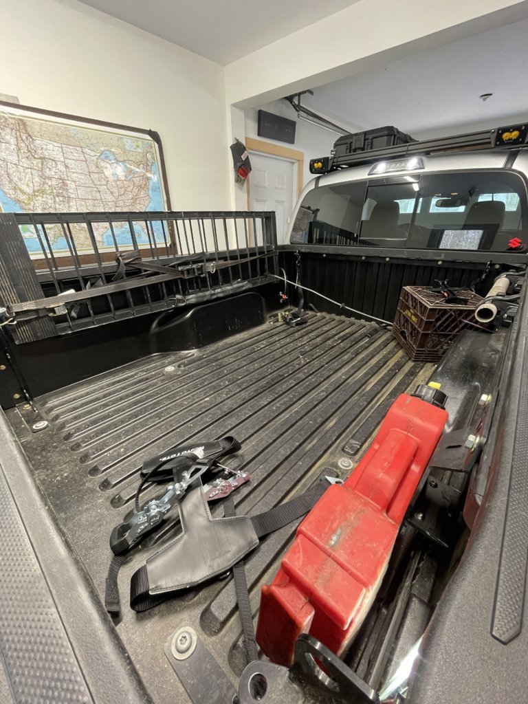

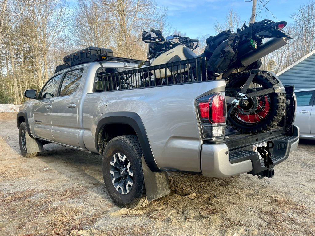

    Putting mine in the bed so I can still haul the lightweight camper. Ramp is bolted to the side rail for transport. Also have a small flatbed and enclosed. All good option IMO. My bikes are too big for hitch haulers.
