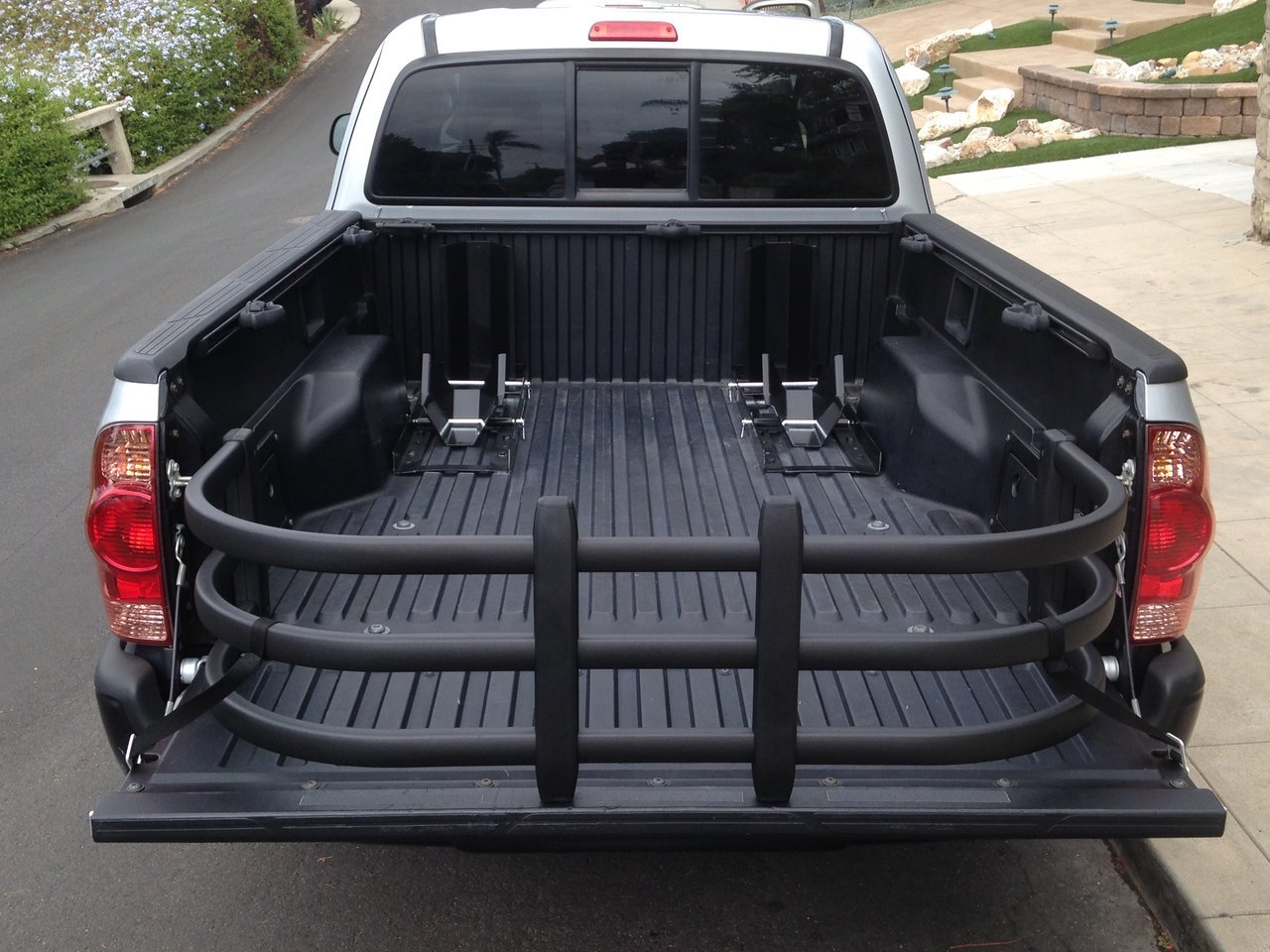

    Thanks guys, and that really does look like a longer bed. In order to fit the bike in my bed with that extender, the extender would need to have an angle in the vertical portion...not a 90 degree as the rear wheel would interfere.

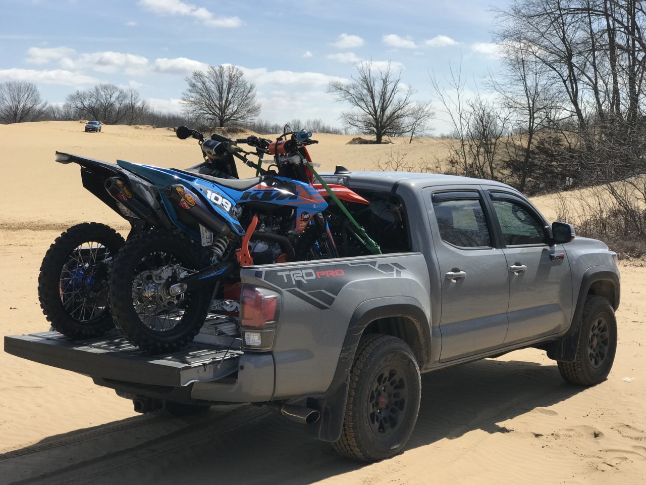

    I haul bikes on the tailgate all the time. No issues 923B0C3F-E916-47B6-B94E-22175444A859.jpg

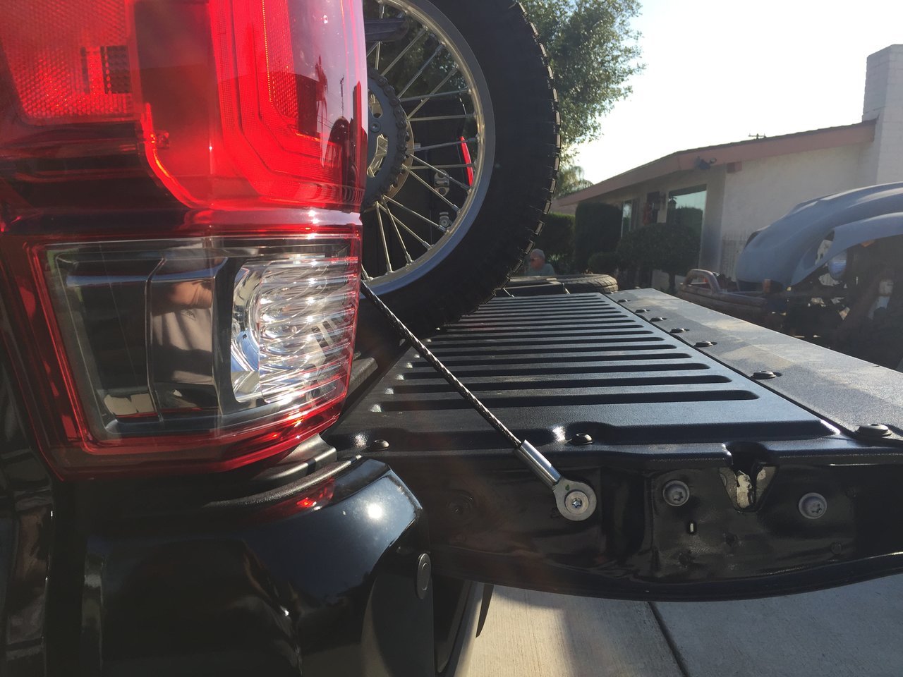

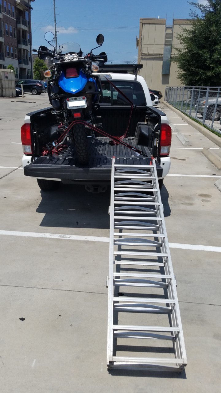

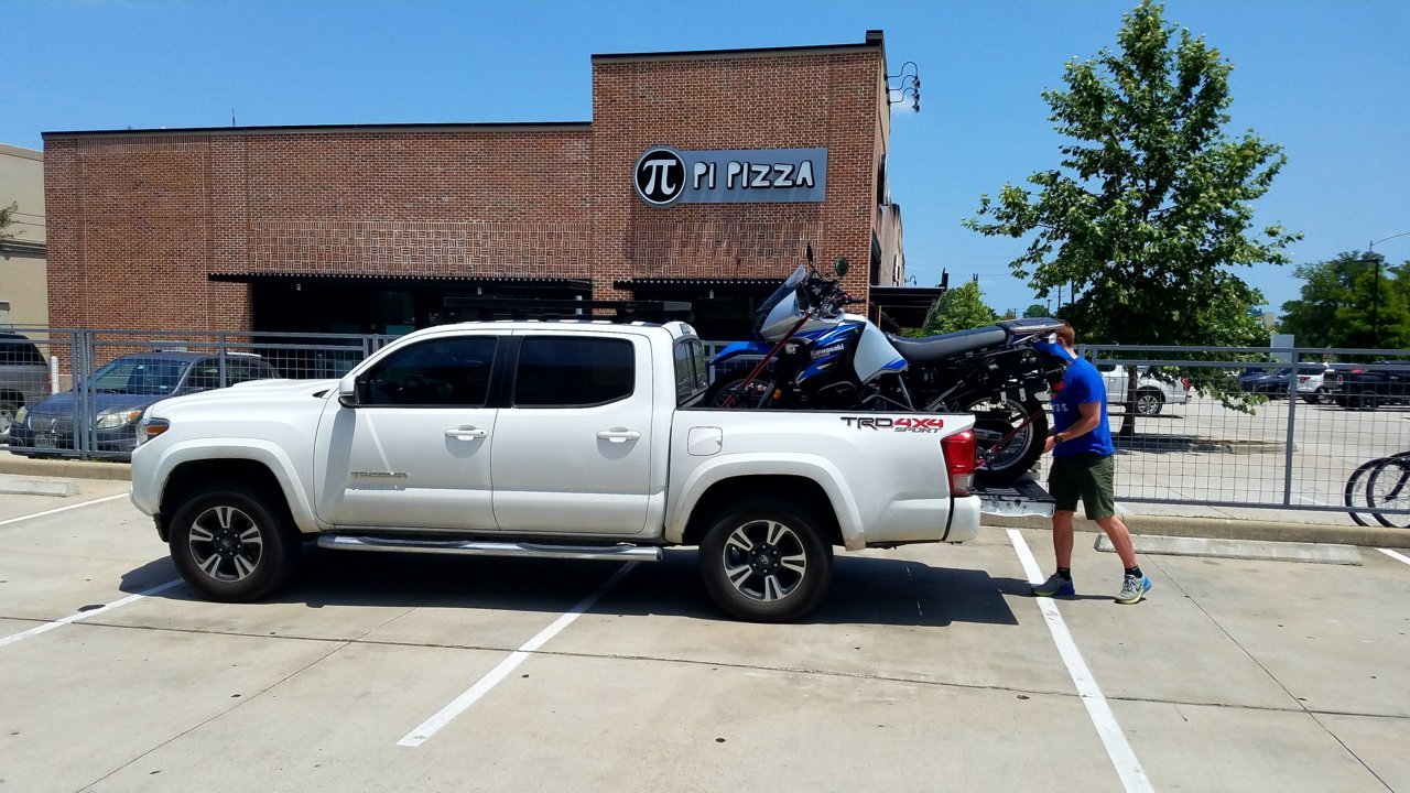

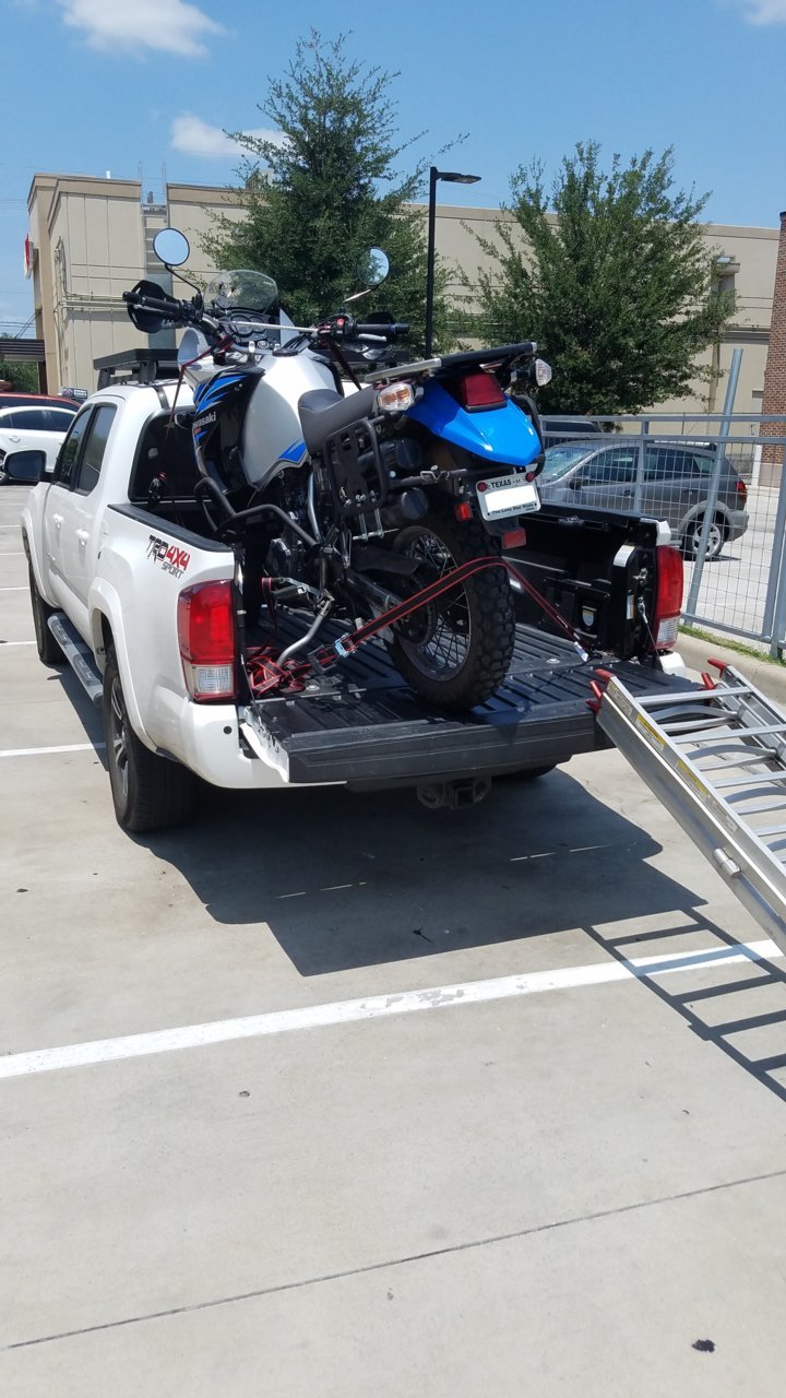

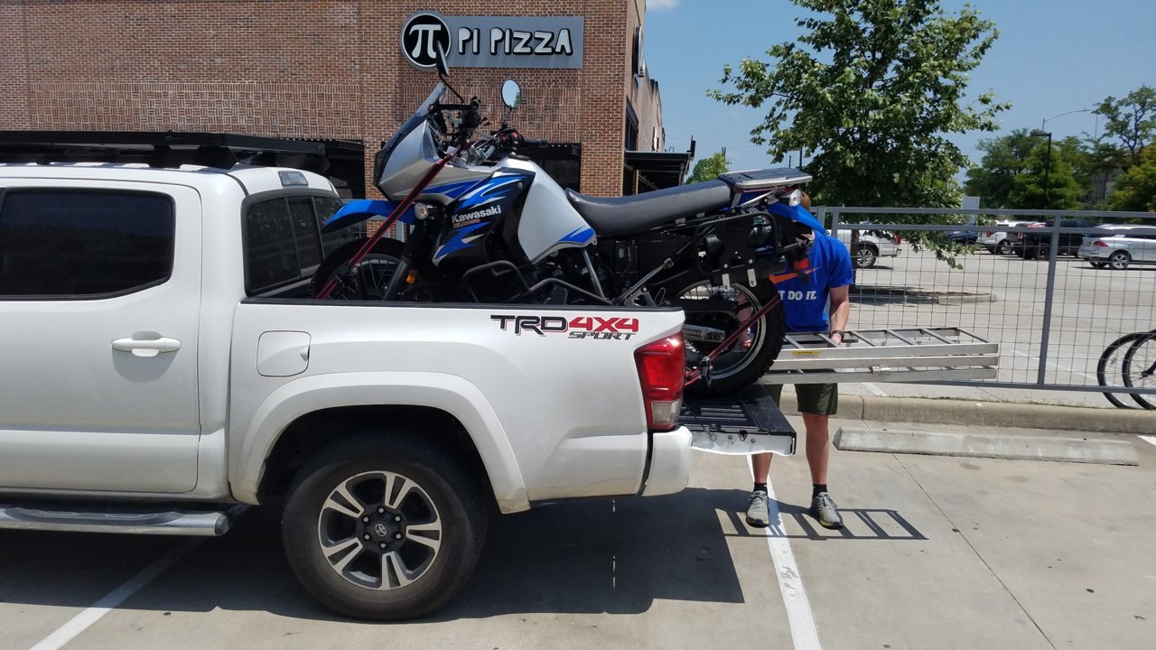

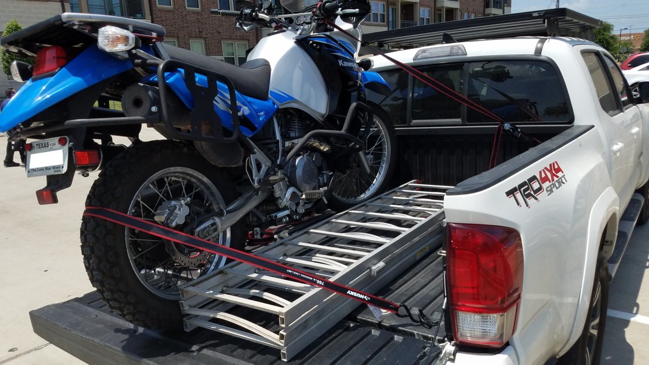

    Any of you guys think I'm pushing the tailgate limits on a 700 mile trip with both a KLR650 and a XR650L? They are heavy, tall dual sport bikes and I'm just worried about tailgate and bed limits. Here are a few pics of the KLR in my truck so you can see the overhang onto the tailgate.
    The KLR weights ~430lb and the XR weighs ~350lb and with a ramp I'd round up to ~800lb in the bed. Not sure how much weight would be on the tailgate, but the KLR is halfway onto the tailgate with a 58.3in wheelbase and the XR wheelbase is 1in shorter at 57.3in.
