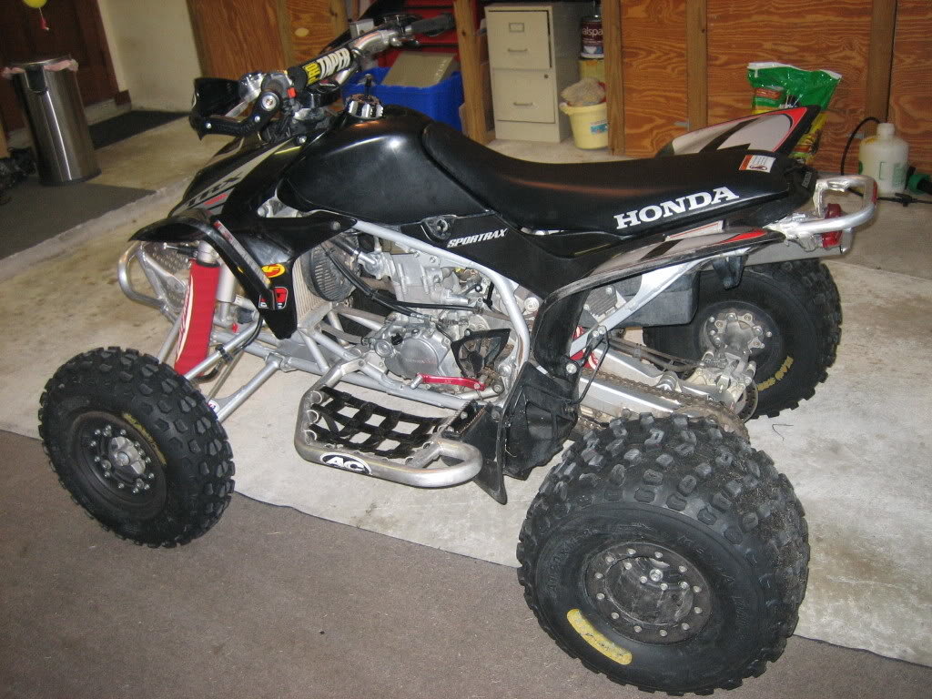

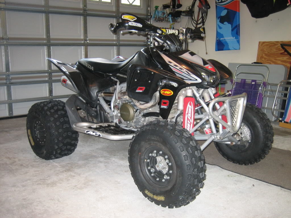

    I have loaded my Honda TRX450R Sport quad with a aluminum ramp and my 08 tailgate held fine.
