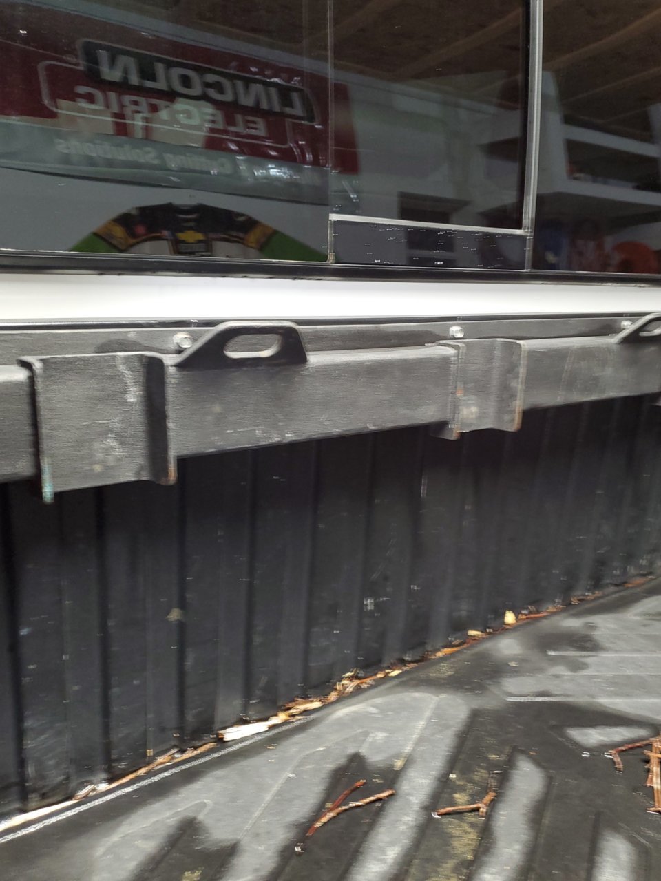

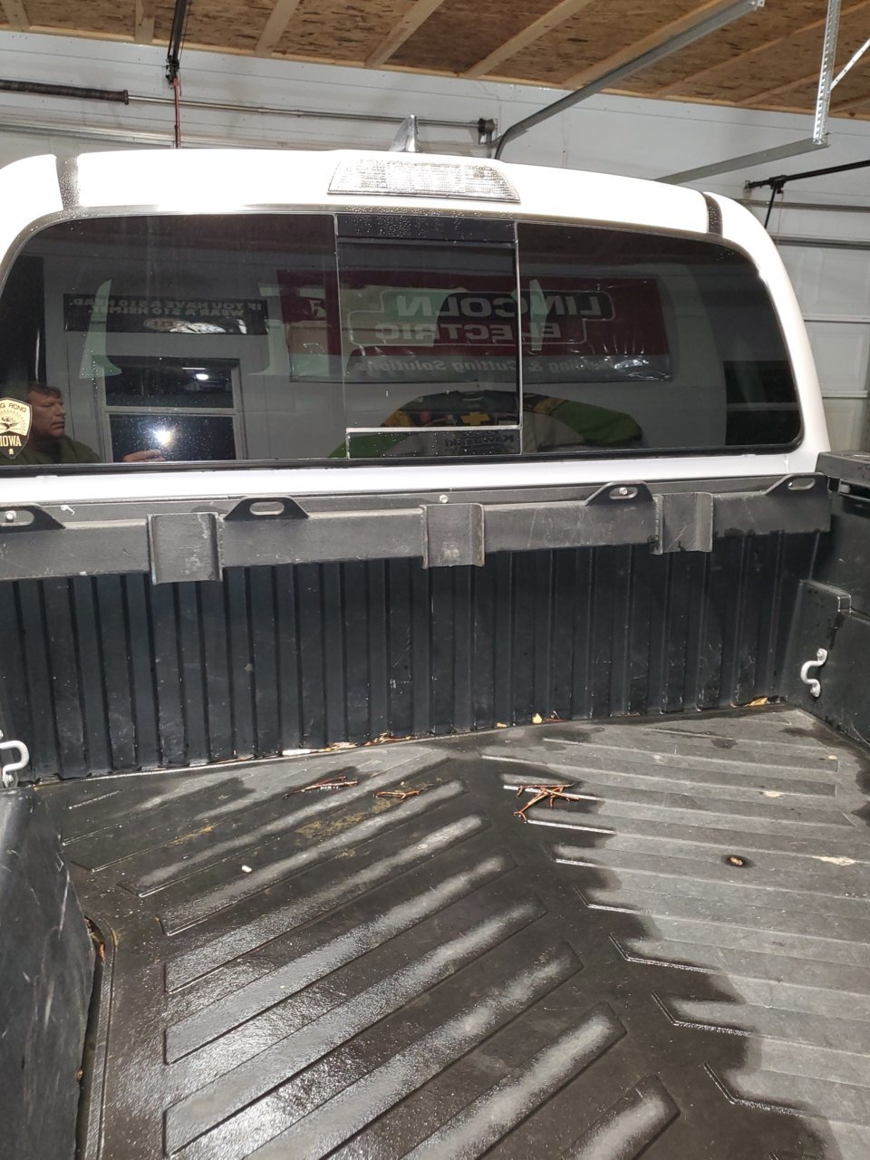

    I took the track off the front of bed to use the mounting pattern already there then cut out a flat with that pattern. Took a piece of 2X3X.120" wall rectangle tube to go side to side, marked locations for front wheel(s) cut 4" channel for front wheel to sit in. Then cut tie down mounts with multiple locations so tie downs don't cross over wheel.of other bike. Added a coat of truck bed spray and good to go! Total investment of $25.0020200908_194419.jpg 20200908_194411.jpg

    Looks good, great idea. Been thinking of doing something similar.
