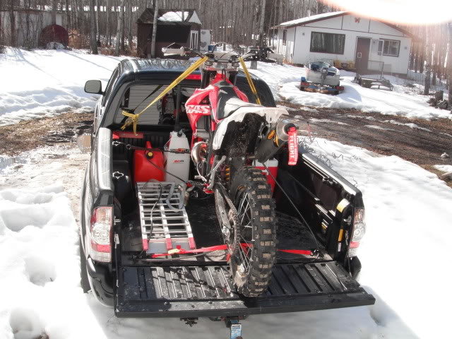

    Not the best picture but it is angle iron welded into a 90 degree piece and bolted to the front and side rails. Rock solid so far.
    If you know a welder it only takes a couple of minutes to make up.

    mx bike no problem.....heavier bike i wouldnt unless i had eight bed cleats

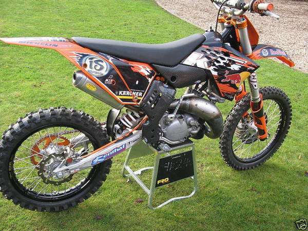

    99superjet 11ktm350
    that is a sexy bike youve got there

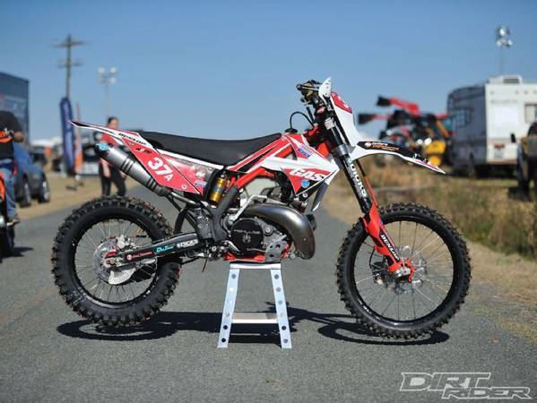

    I guess that's why dirt rider just gave the 250 version the "most photogenic award" this month. :D

    99superjet 11ktm350
    yeah its no ktm though :p

    That's a nice bike also. I was considering a blue KTM (Husaberg) but a couple of my old riding buddies convinced me that I would love the GasGas..... they were right!
