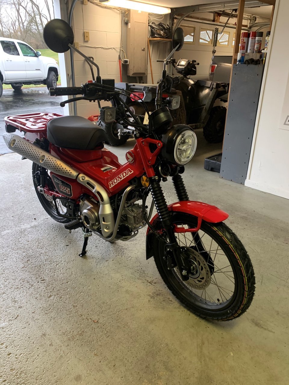

    Just added this to the stable a few weeks back!

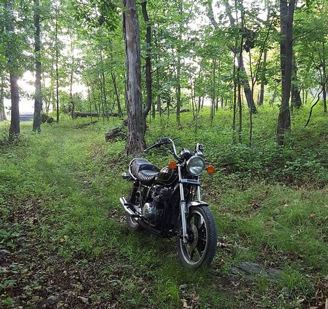

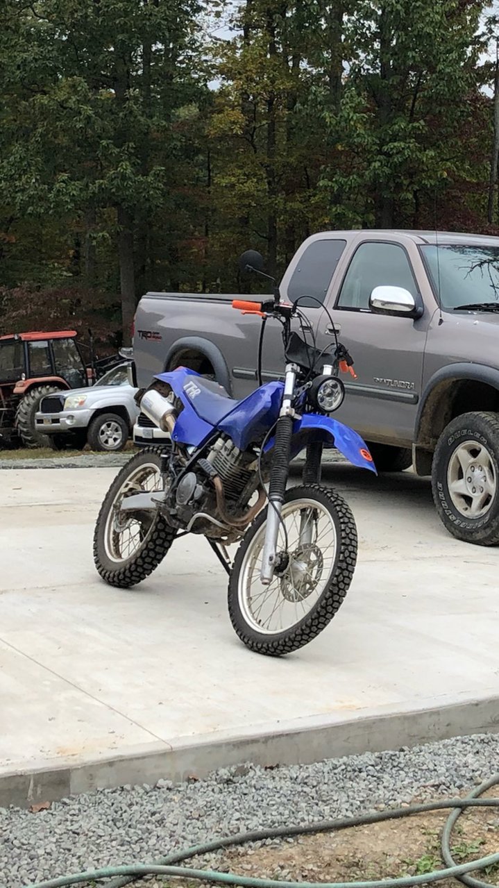

    Hey y’all! Love seeing all those bikes! Here are my scrap heaps:
    2003 Yamaha TT250R
    1980 Kawasaki KZ 750 LTD

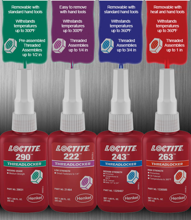

    Went on a scoot...noticed the damn bolt that secures the exhaust pipes to the mounting bracket is gone. This is the second one, or maybe the first if I never installed it initially. But any who, it had loctite and all...so now what?

    what color loctite?
    could drill a hole and safety wire tie backside of bolt??

    Lock nut with a nylon insert? Maybe a heavier duty bolt you can torque the F@$& out of? Worst case, perhaps a dab of jb weld on the remaining threads that can be chiseled off should you ever need to undo it again.
    My exhaust bracket has a threaded hole for the silencer mount and I also added a nut on the back, so it’s torqued from both sides.

    Used some blue loctite. I thought about the JB Weld. HA!

    maybe try some red, that is their strongest

    Keep in mind red loctite require serious heat if you need to remove it. I would limit its use to hardware with NO chance of ever needing a field repair. I'd go with blue loctite and add a jam nut. Muffler on my Buell is set up that way, regular nut, then a second thinner jam nut. No issues and that thing shakes pretty good.
