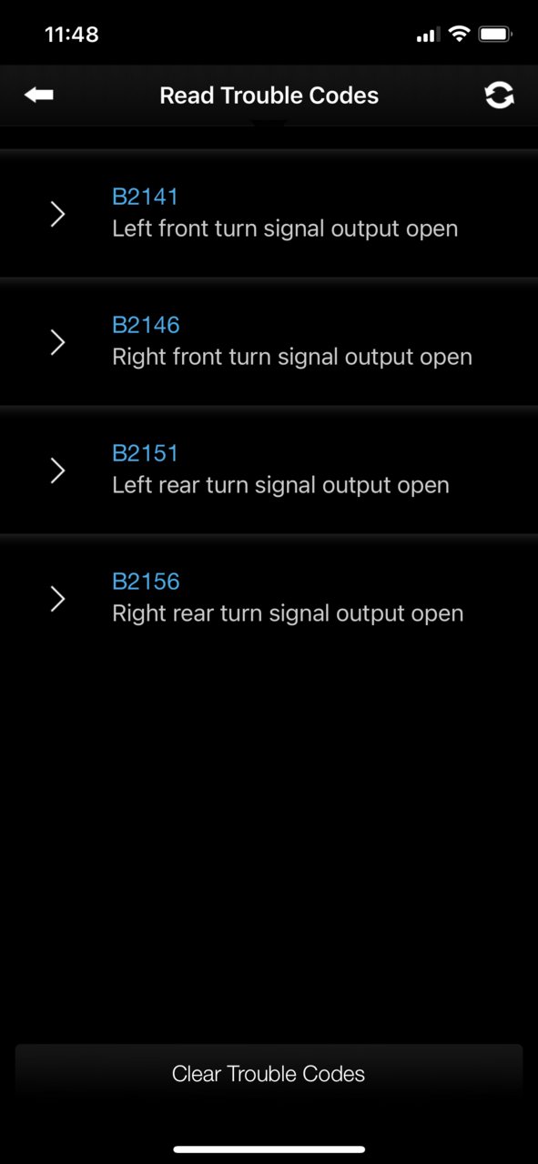

    Took a quick scoot before work. Did all my precheck stuff and all is working. Wife was behind me for a bit before she headed to work, and she confirmed lights are all operational. However, if I check codes, it shows the turn signals are out of whack. Any ideas??

    Did you replace incandescent lights with LED's and didn't put in a resistor?

    Yes I have all LED lights and I did not install a resistor. However, I’m not getting the hyper flash I did in my truck when I replaced to LEDs....:notsure:

    I'm guessing that's the issue then. Hyperflash normally only is a thing if it's an analog flasher module, like one that heats up, releases, cools down, closes the contact, heats up, releases etc etc. If you have a digital flasher relay it won't be necessary to have a load on it for it to function at the correct speed. ECM is probably looking for a specific resistance or impedance or something in the circuit its not seeing and thus sending up the code.
    You should do some googling and see if that's a setting you or a dealer can change in the computer. I know on my BMW I can set the signals to LED or regular bulbs using a OBD2 interface and an app or the dealer software.

    Make sure the self cancel feature is still working! On some models of Harley they rely upon getting a signal back to the module registering a certain amount of resistance and heat generated by the system working. LED might not provide that so you signals may not shut off as they should.
