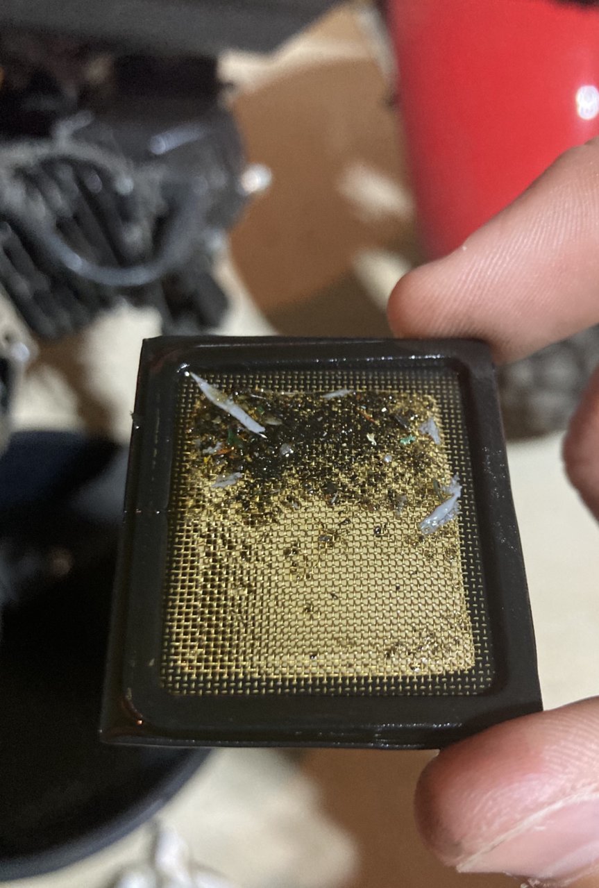

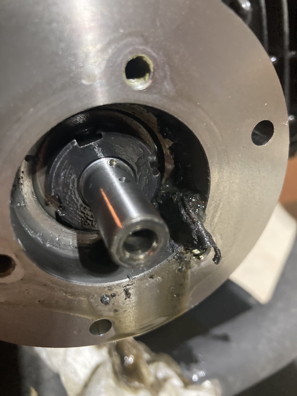

    Finally did the Groms first oil change. Oil spinners are a lot more work and it’s crazy how much metal sludge there was from the first 650 miles. Hopefully there is less next time.

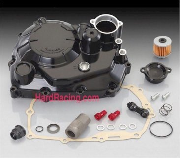

    Given much thought to putting on a Kitaco clutch cover? Lose the spinner, gain an oil filter.

    :confused::notsure:
    Oil spinners?

    I had to look it up too.
    Apparently it’s an alternative to an oil filter. Uses centrifugal force to “spin” the metal particulates out of the oil instead of forcing the oil through a filter. The metal gets captured in a small cylinder behind the clutch cover. Means you have to remove the clutch cover to clean it out which would be annoying (handful of bolts and some brackets in the way) as opposed to a conventional filter and drain plug. On the upside, there’s no filter to buy at each change and you literally just wipe it clean and reassemble. But I imagine that gets offset by having to buy a clutch cover gasket.

    Yeah, I want one but didn’t want to spend $300 on one. After doing the first oil change I will probably get one in the near future if/when I get stiffer clutch springs.

    What Ghost Ship said. It wasn’t hard cleaning the oil spinner, just time consuming. There is a company that makes a clutch cover that has a oil filter but it’s $300. It’s $11 for the 2 gaskets needed to remove the clutch cover and clean the oil spinner, probably the same price as a filter.

    also gains you increase in the oil volume, and the oil site glass is a nice feature as well

    When you think of it as being about 10% of the cost of the bike to purchase, it’s a tough thing to justify. But in my view, the convenience, and the time savings...I figure my time is worth something...bribes the cost gap that my mind struggles with. I had planned to get a Kitaco for mine, but I sold it and my other street legal bike. I really regret not hanging onto the Grom, and I’m on the search for another one.
    Also shave off some weight, rotational mass at that, by removing the spinner.

    Yeah. The struggle with me was I only put 650 miles on it in the year I have owned it so far and I have a lot of other projects going on. Having done the oil change with the oil spinner now I will be installing the cover next time I have to break open the engine. Excited to put the Kenda KD1 tires on next. Been using the Maxxis knobbies for the last 600 miles and they just aren’t fun on the street.
