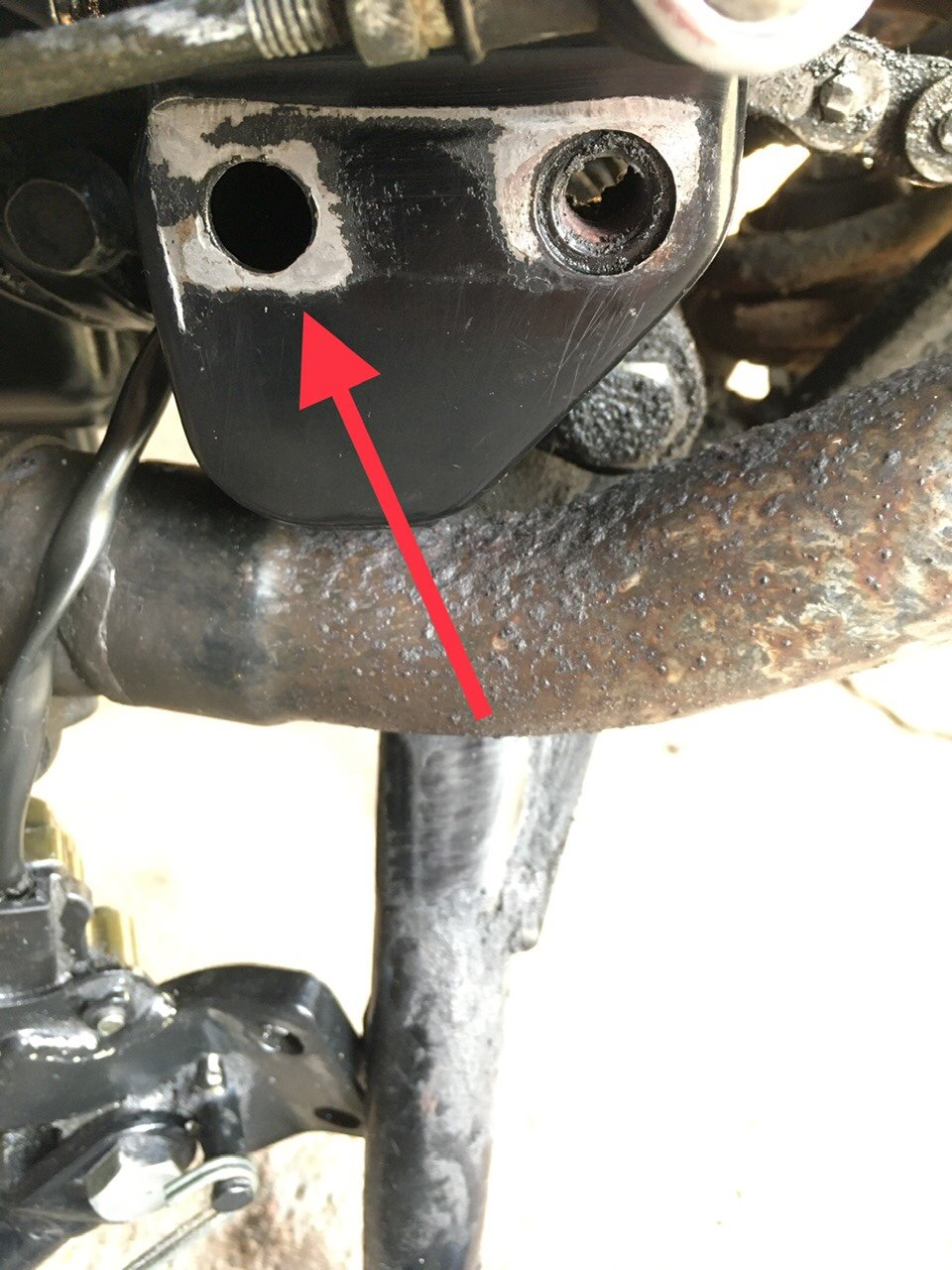

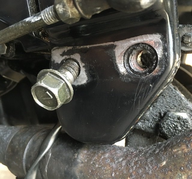

    It looks like the back of the bracket is open so I presuming the nut is gone and the other is stripped out. If correct take a punch and knock the remaining stripped nut out. Get a pair of grip nuts and grade bolts and install a new stand. As you tighten down on the grip nuts they will grab and not need a back up wrench. If you ever have to remove you will have to break off the bolt with an impact wrench.

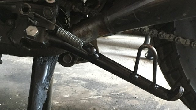

    Definitely need a replacement kick stand as yours looks bent. How thick is that plate? Looks to be about 1/4 inch give or take. I'd grind the paint off it and get another piece of mild steel plate about the same thickness and weld it over top that one then just drill and tap it for your mounting bolts.. it'll change your lean angle when on the stand a little but should be okay.
    Those grip nuts look interesting as well. Never saw those before.

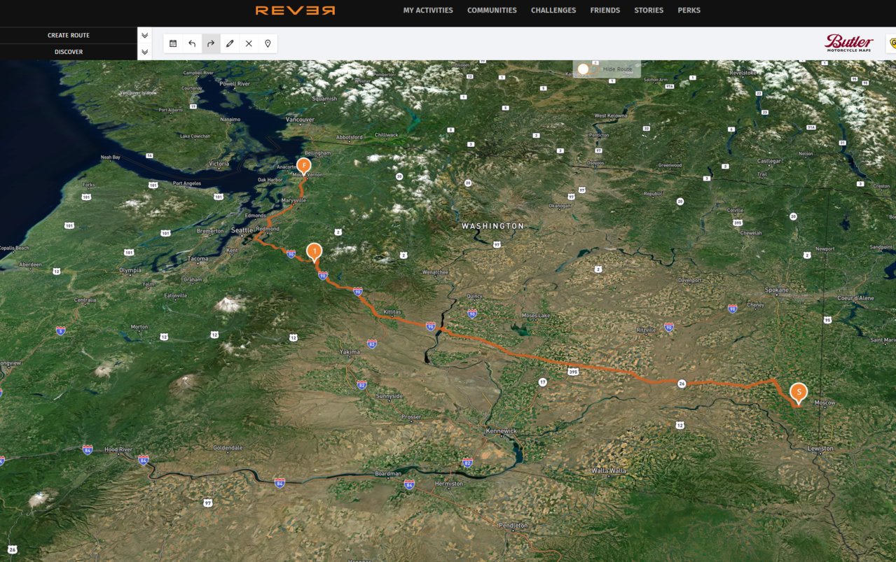

    I'll be riding through that area tomorrow. Doing about 6 or 7 hours and 350 miles tomorrow to head to my parent's for my niece's graduation party Saturday. Then the same trip home Sunday. Almost going the entire width of Washington. First long trip on the bike in a couple years, and I'm excited. Put on my larger front sprocket today and cleaned/adjusted the chain with it. Checked my fluids, tools are packed, bags are on. Only regret right now is not buying a tank bag. Just sitting here thinking how convenient those are for little things on long trips. Oh well. Next one.
