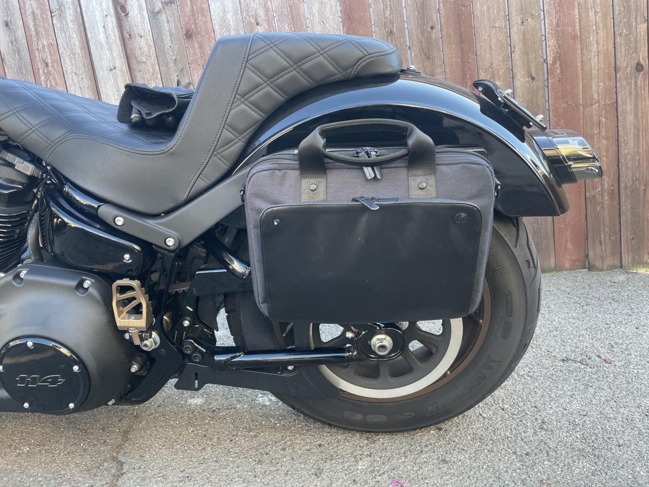

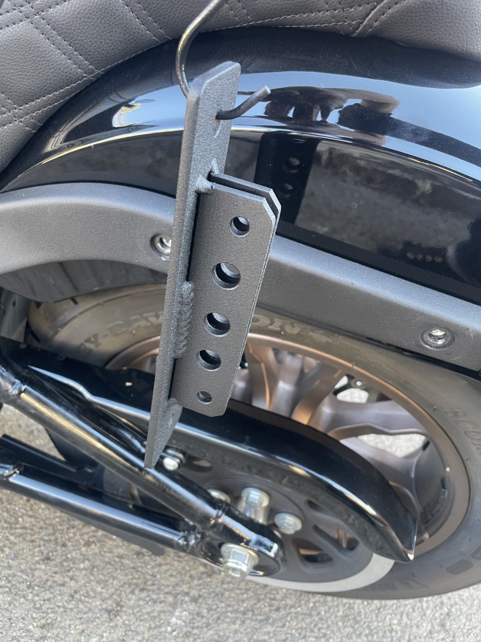

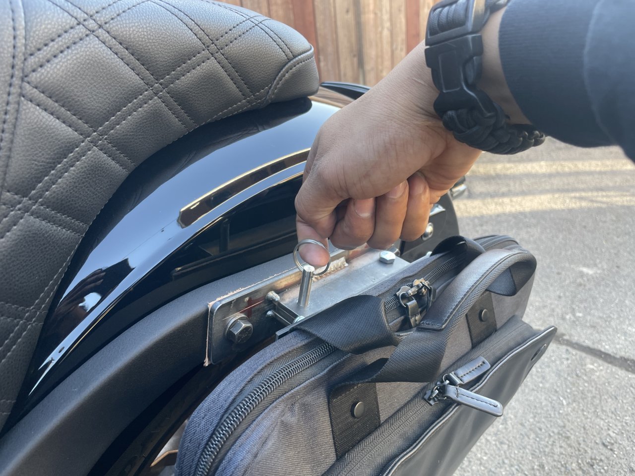

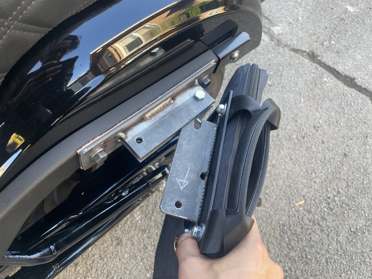

    After serval iterations I finally have a quick release bracket finalized for the scooter. For now I’m testing with a laptop bag, but this is a perfect platform for me to attach any bag or case without having to buy or modify hardware for each “bag”.
    This is the third style of mount that I made. The first was a traditional panier style frame, the second was a molle style panel but ultimately this style (inspired by a quick release fire extinguisher mount) ended up being the easiest and sturdiest.
    After some finessing on the bracket to lighten it visually and literally.
    and finally some texture matching with a wrinkle finish.
    This is still in a testing phase and I may try to minimize the bracket further as I get more miles with it.

    8,522
    Georgetown, TX
    2015 TRD Sport DCSB
    Dope!
    GHOST SHIP[QUOTED] likes this.
  13. Jan 27, 2022 at 9:03 PM
    GHOST SHIP
    GHOST SHIP hates you.
    Mar 9, 2015
    #150537
    22,398
    GHOST
    Looks a lot better all painted and cleaned up. The wrinkle paint blends in with the struts really well.
  14. Jan 27, 2022 at 9:28 PM
    spencermarkd
    spencermarkd Well-Known Member
    May 15, 2016
    #187025
    3,914
    Spencer
    07 Driftwood Pearl 4Runner
    Super clean looking, nicely done man.
  15. Jan 27, 2022 at 9:30 PM
    GHOST SHIP
    Mar 9, 2015
    #150537
    22,398
    GHOST
    Thanks Spencer! I might try adding one of my old pelican cases tomorrow.
  16. Jan 28, 2022 at 6:51 AM
    cynicalrider
    cynicalrider #NFG
    Jul 25, 2012
    #83399
    17,160
    Jersey
    01 SR5 TRD 4x4, '23 Bronco Wildtrak, 2017 HSQV FE350
    Drop bracket lift and booger welds
    Love it! Not sure if you are planning on it or not but a lanyard for the quick release pin on the bag side of the bracket will make life easier too.
    These are the ones I grabbed and have held up well:
    https://www.amazon.com/gp/product/B07TCS5J82?ie=UTF8
    Can see a similar setup on my rack:
  17. Jan 28, 2022 at 7:07 AM
    GHOST SHIP
    Mar 9, 2015
    #150537
    22,398
    GHOST
    Thanks dude! I was going to use a paracord lanyard. I do the same thing when I build my tire carriers for the hitch pin to prevent unnecessary rattles. Those stianless ones would actually come in handy for some other projects I have though! Ordering some now.
  18. Jan 28, 2022 at 7:30 AM
    Fulton246
    Fulton246 Well-Known Member
    Feb 20, 2016
    #178841
    1,232
    NC
    2019 TRD Sport 4x4 DCLB
    Looks great. Nice welds! Only thing I would change is the mounting hardware. Rounded allen head bolts over hex head.
  19. Jan 28, 2022 at 8:04 AM
    GHOST SHIP
    Mar 9, 2015
    #150537
    22,398
    GHOST
    I was just using what I had on hand but it’s a grade 8 shoulder head bolt so it’s enough for now. If it bothers me later I’ll probably swap it out.
