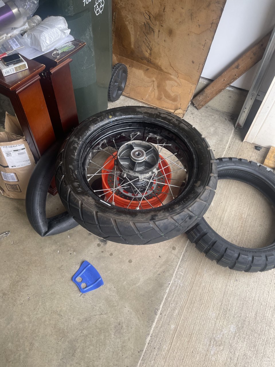

    Tube out, need to dismount tire still

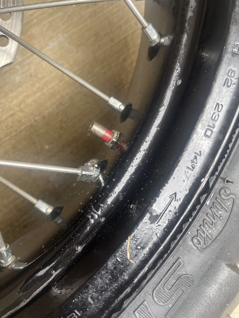

    I think i pinched the tube. Spoke next to the valve stem has some bubbles. Ill order a front too so when i have to do this again, ill be prepared. Ugh.

    Bright side is you should just be able to un bead it and not have to get one of the sides over the rim again to replace the tube. Did you have the tube slightly inflated to a couple psi when you were spooning the tire back on? That's always helped me to avoid pinches.

    Yes i did that. I even tried to debead it, and reseat, because I figured out how to mount the tire without killing my strength. But it didnt work. Still have small bubbles coming from the one spoke next to the stem :mad::mad:
    pissed because so much work learning it and trying to be careful.

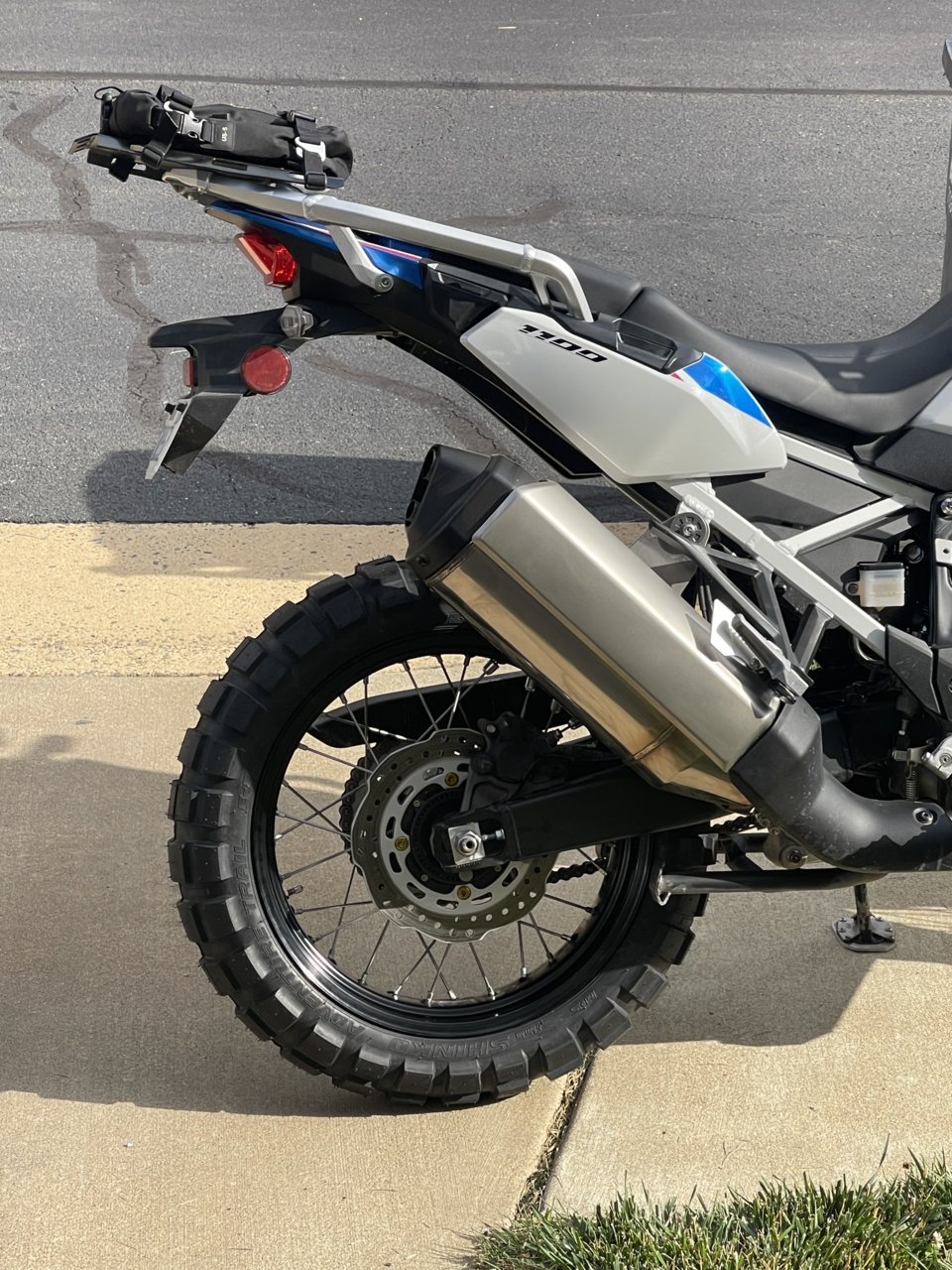

    Well it looks good

    IIRC when the bead seats, as the tube expands the air between the tube and tire needs to go somewhere so it squeezes out of the spokes. I think that happened when I did my DRZ. Could be wrong? Is it holding pressure over time?

    Thats what i will monitor overnight. I put 40psi in, and going for a small test ride now. Also, i have the spoke protector rubber strip in there..

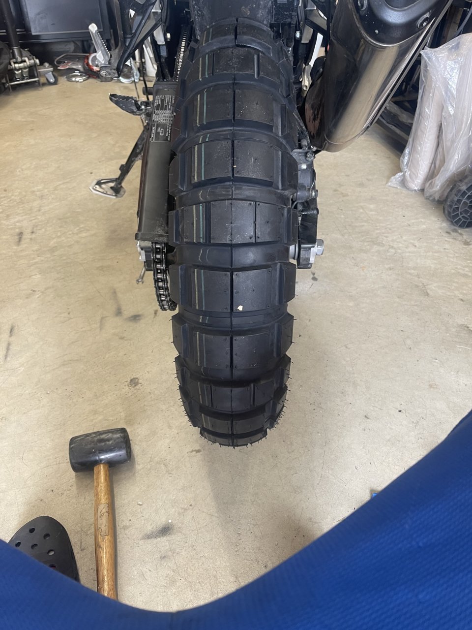

    Look at all that meat

    Since it's got a possible leak......that thing is totaled. I'll give ya freefiddy for it and I'll even trailer it home.
