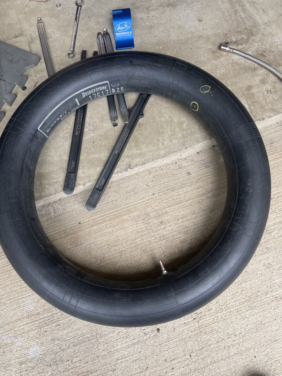

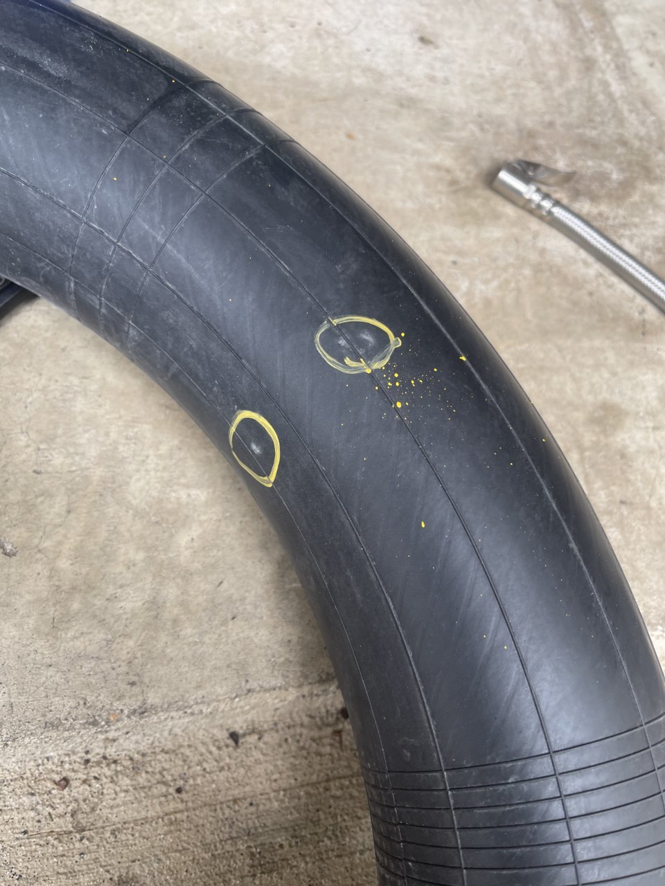

    @cynicalrider now all the spokes have bubbles. Granted i didnt replace the tube, i just covered the two spokes next to the valve stem with gorilla tape, under the spoke protector.
    :annoyed::notsure:

    Tube definitely has 2 pinches

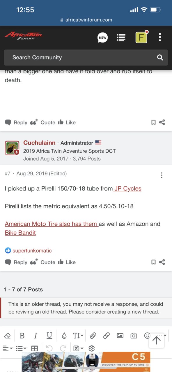

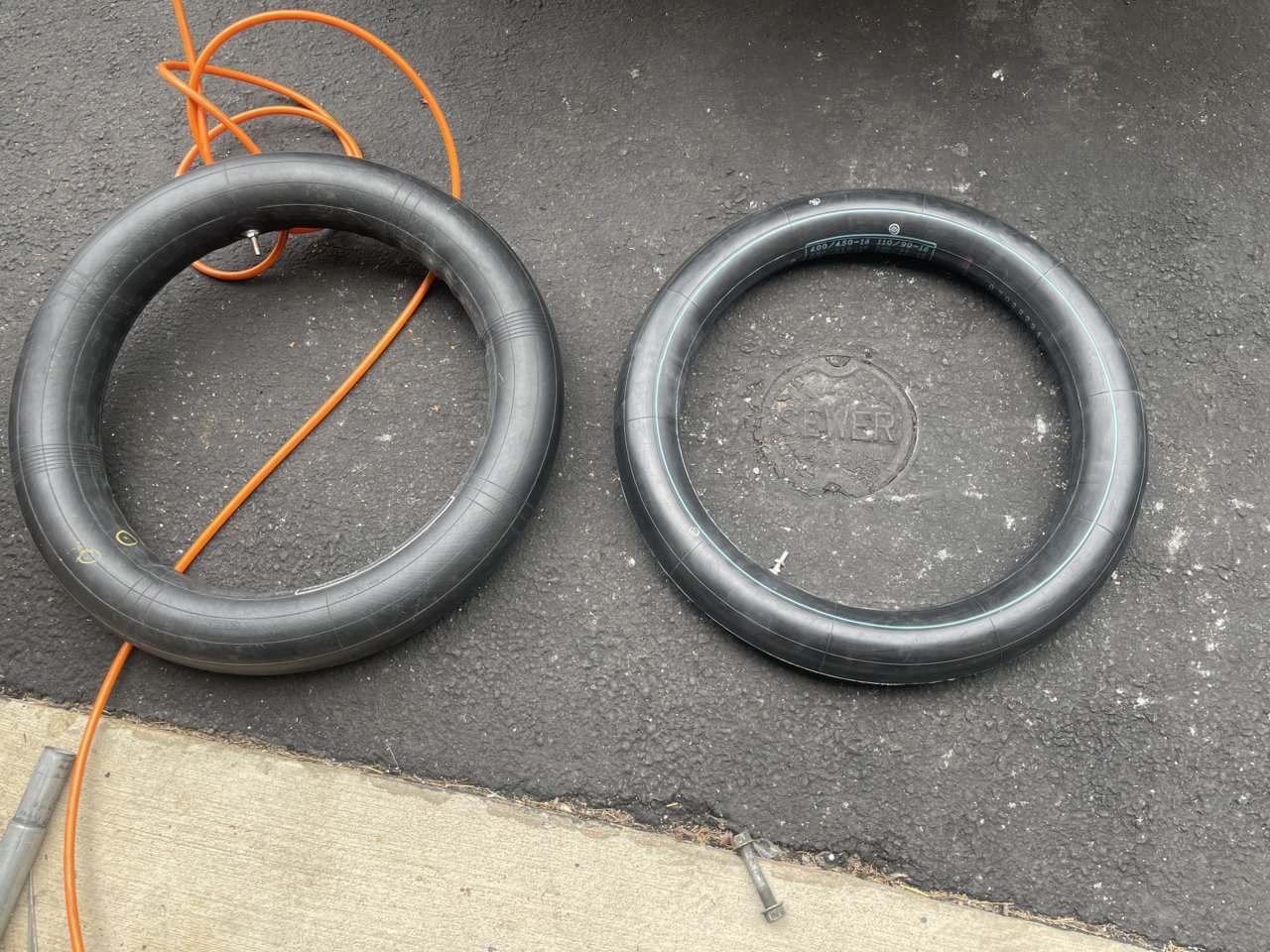

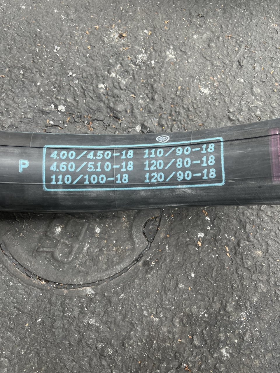

    So the new one was sized a little small, in my opinion. AT forum says it will work, but post is 3 years old. My tire size is 150/70-18
    I put in the new one, set to 37psi, and no bubbles at all. Will monitor overnight. I will also get a better gauge. Going to attempt the front too
