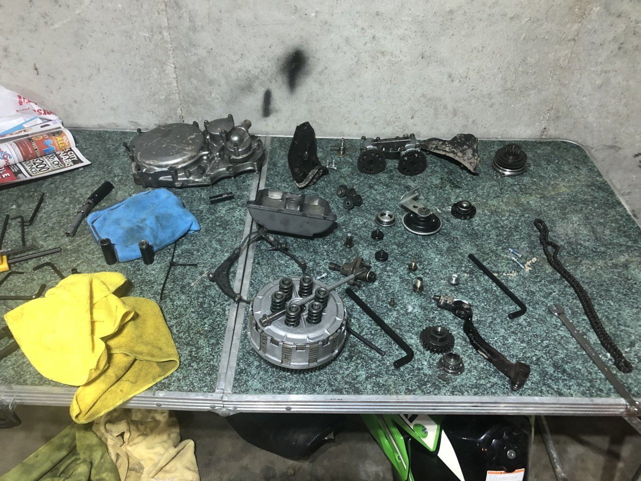

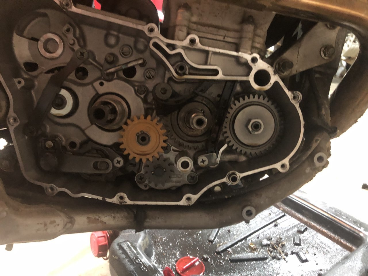

    Just a few photos of the current status of the klx got to take more apart tonight I wish I had more time but raising a puppy I don’t get much time haha

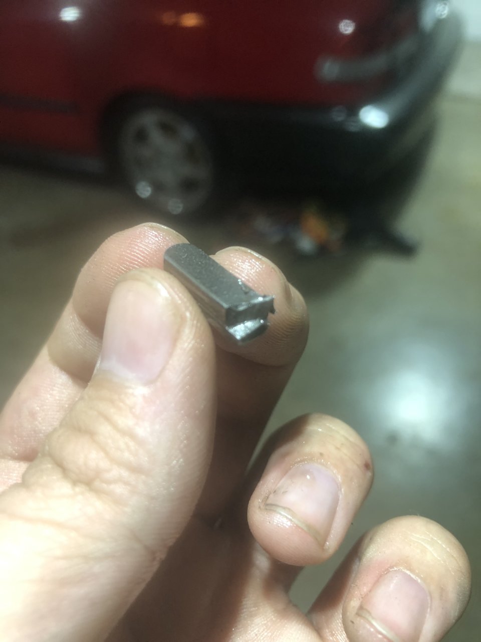

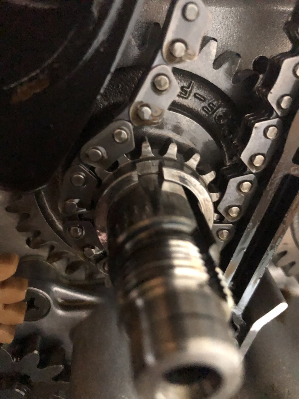

    Well everyone the issue has been found… after taking the clutch pack off I went to find a socket for the primary nut but sadly it wasn’t needed… the primary nut was so loose I spun it off with one finger…. So for those that don’t know what the primary nut does.
    thr primary nut sandwiches 3 sprockets together and the cam sprocket and outer sprocket have a woodruff key that keeps them aligned from what I can see. Well when the primary nut comes loose the outer sprocket starts to walks away which causes the cam sprocket to come out of the woodruff key and spin freely which then throws the bike out of time… if this happens while riding it can have your piston meet the valves and it’s no fun.
    so after that explanation my key did in fact come out and get part of it sheared off so my hope is since my bike stalled and then wouldn’t start is that my piston didn’t make new friends but that will come tomorrow when I pull the head I ran out of time for tonight so I’ll post the pics I have and will update you all tomorrow!

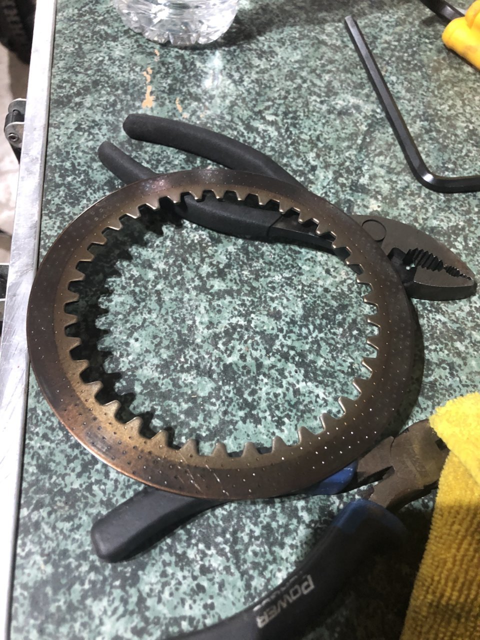

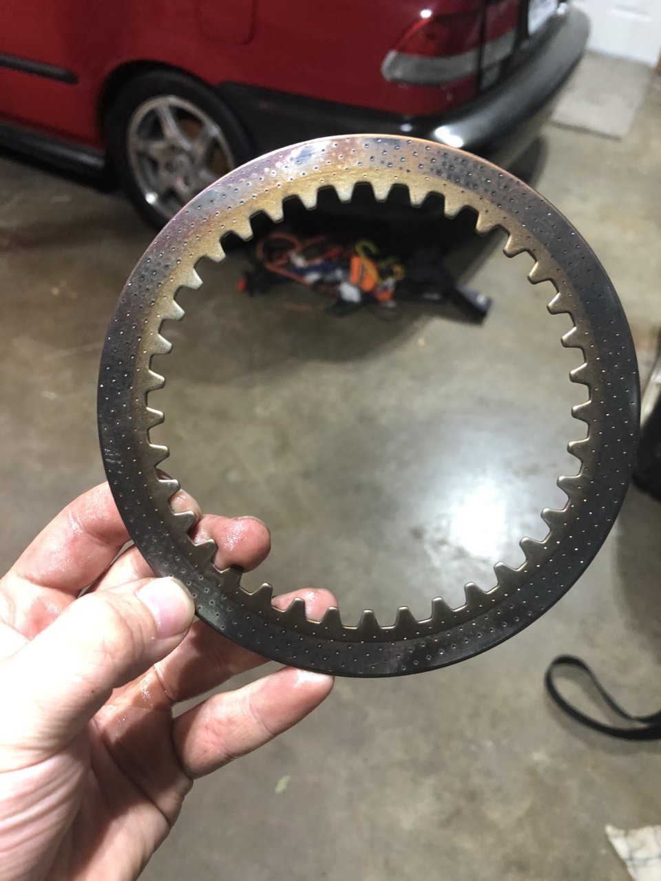

    oh also I’ve never looked at a clutch disc on a power sport before mine has a tiny bit of blue on the edge (pic attached) should I replace this now or does it look fine?

    Might as well replace the clutch discs while you are in there. Try having 2 kids under 5. All the 2 year old wants to do when he “helps” is move around all of the sockets and hit stuff with the ratchet.

    the clutch on these bikes is pretty easy to access just wondering if its bad or something i should be worried about here soon? since atm im trying to save up the money to fix this bike haha
