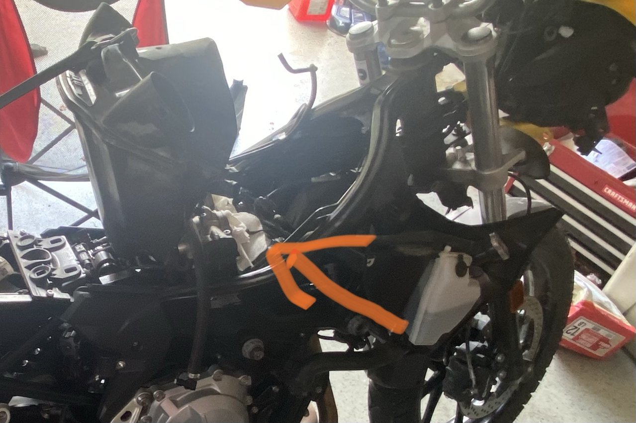

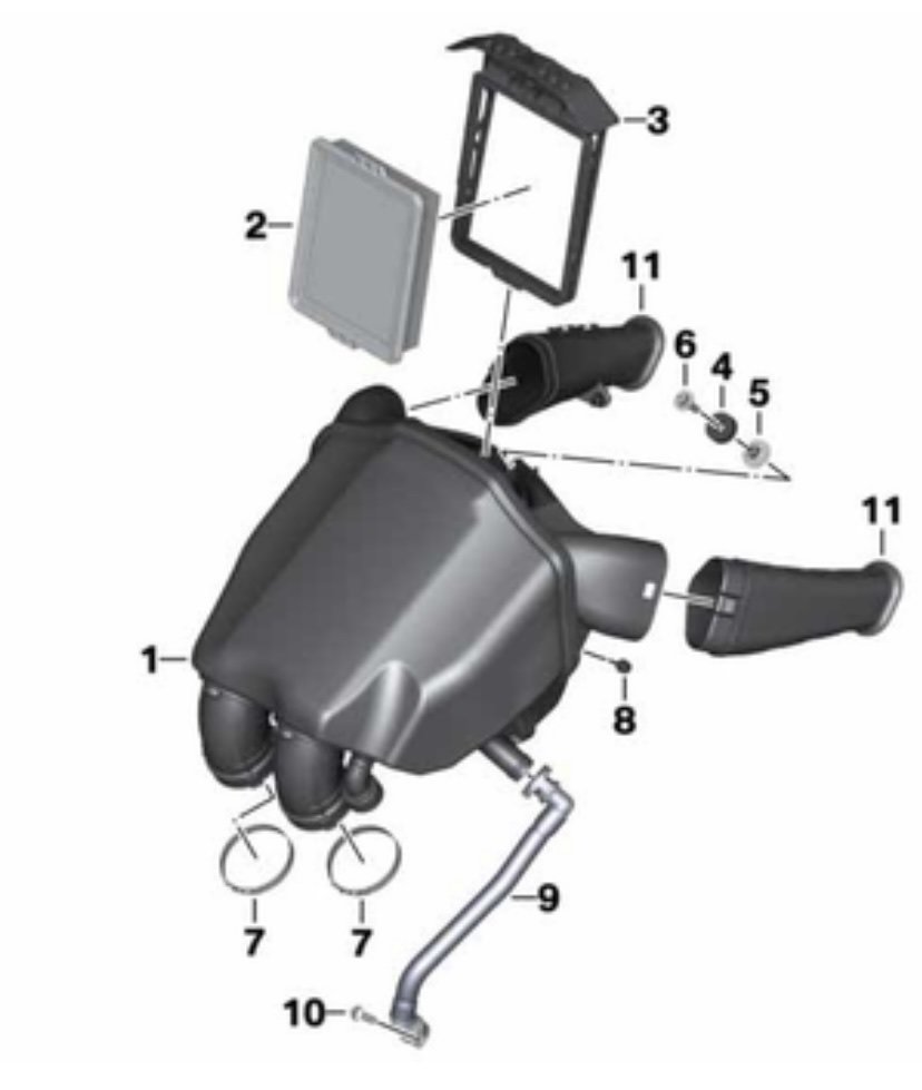

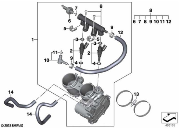

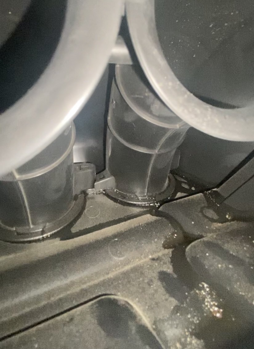

    Update - completed the service and we noticed the bike starting to misfire under acceleration. No codes popped and there’s oil behind the air filter in the air box.
    I remember the rubber boot for both intake tubes slipping off when doing the spark plugs. You can see where I had paper towels plugging the hole they popped out of.A6B0C4AC-5F01-4C09-8ACE-2AAF3CD8FF07.jpg
    I’m guessing #13 in the top pic or #7 in the bottom pic is to tight or to loose. Does anyone know why that would cause oil to make its way to the air box and misfire?

    Seems like the logical source. Id keep an eye on bottom #9/10 as well as a potential source.

    Things that I'd check for the misfire would be the boots going from the airbox to the throttle bodies or throttle bodies to head OR check and make sure that the fuel lines arent slightly pinched to where they'll run at idle but constrict at higher RPM's.
    For the oil in the air box.. my f800 almost always has a bit of oil in the box when I do filter changes, pretty sure it comes in through the crank breather or the SAIS that is routed into the box for emissions or whatever. That'd be 9 in your lower picture.
    where do hoses 14 go off the throttle body? Looking at the rest of the fiches I couldn't figure it out.
    Also wild to me how different the air intake is for that compared with the F7/800 series. 16 and 22 in the upper diagram were the ones I originally warned about. Here is the 08-12 f800 fiches. super different.

    Are you absolutely sure the valve cover gasket is sealed and not leaking? Quick Google search lead me to a F800 forum post about a very similar issue to this. Valve cover gasket hadn't 100% sealed and owner still had a small oil leak and some was being drawn into airbox. The clamps to the throttle bodies and the airbox could cause a slight misfire but that still wouldn't explain your oil being there.
