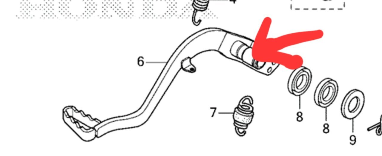

    I've checked the lever, and both switches(the one that pushes up at the master cylinder and one that has a spring attached to the inside of the lever) for the rear. Everything is hooked up correctly. I'm gonna try to replace the bulb and if that doesn't work......I'll call the shop.
    All stock wiring and connections. Nothing spliced into it.

    Pull off the connector at the end of the switch and put a multimeter on it to check the continuity? My bet would be it's stuck closed somehow.

    Have you lubricated the pivot point? Doesn't have to hang up much to keep the brake light on.

    I will see if I can find the multimeter
    Yes, lubed the shaft that goes through the frame.
