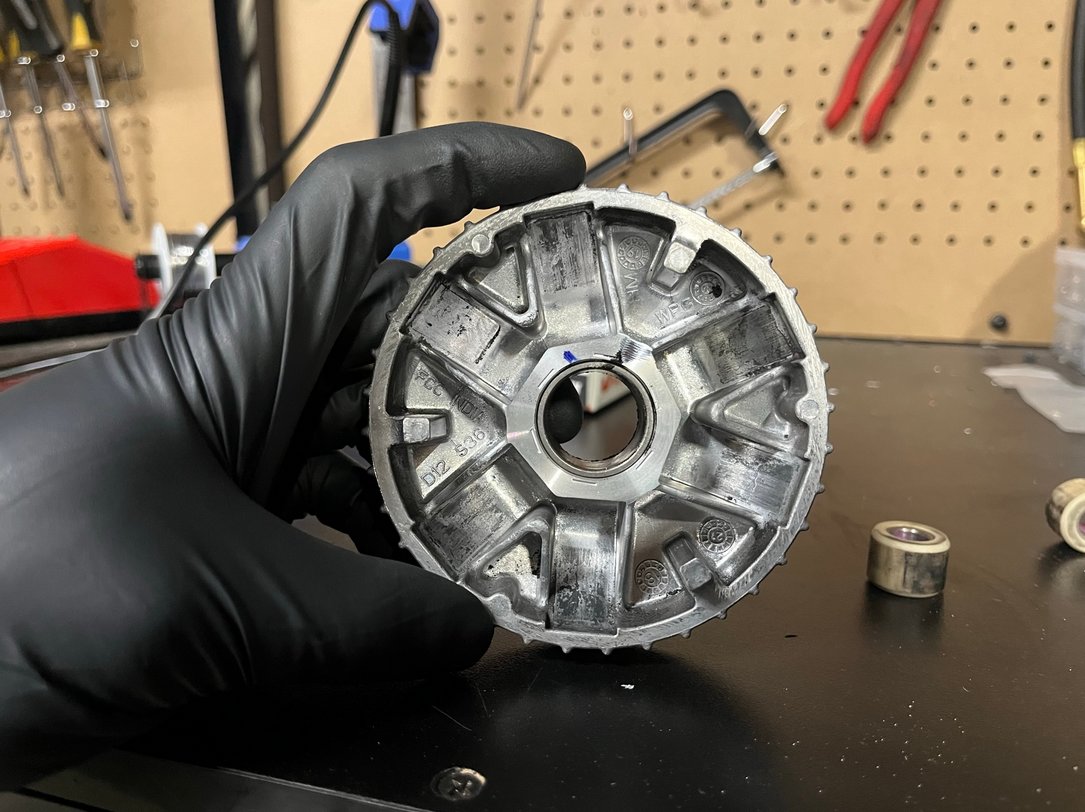

    I finally swapped the variator weights in that @spencermarkd gave me. I think I did it right and just alternated the 11g and 15g weights in the variator?
    I gave the variator nut a few zaps with the impact and put it back together and it seems to be running well. Definitely accelerates harder but haven't tried top speed yet.

    Interesting. Usually heavier weights will mean lower motor rpms (more centrifugal weight tries to close the variator quicker).

    Yup, just alternate them. Gave me a huge boost off the line and I didn't lose any top speed that I could tell.
    @nd4spdbh stock weight is 17g, so this gives it an effective 13g weight. Stock weights were too heavy and chuuuuugged.
    Here was the reddit post I did forever ago on it: https://www.reddit.com/r/hondanavi/comments/t7qawz/i_did_a_little_bit_of_work_on_optimal_roller/

    AHHHHHH OK. that makes sense then. your post made it seem like you re-used stock weights or something along the lines of heavier.... though i have had a couple of beers sooooo drunken math.
    yeah 17 to 13g of weight is a big diff, let that lil motor rev.
