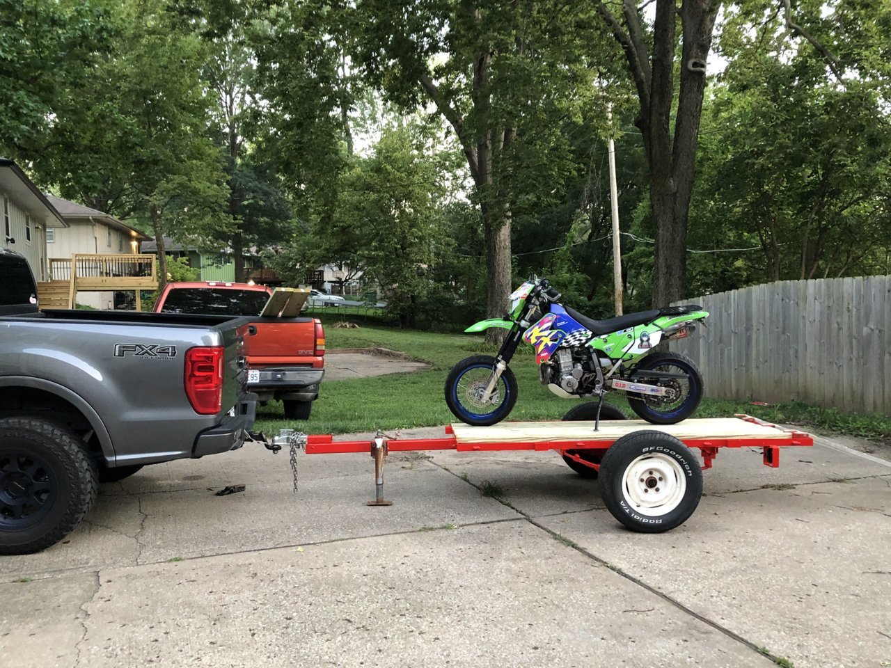

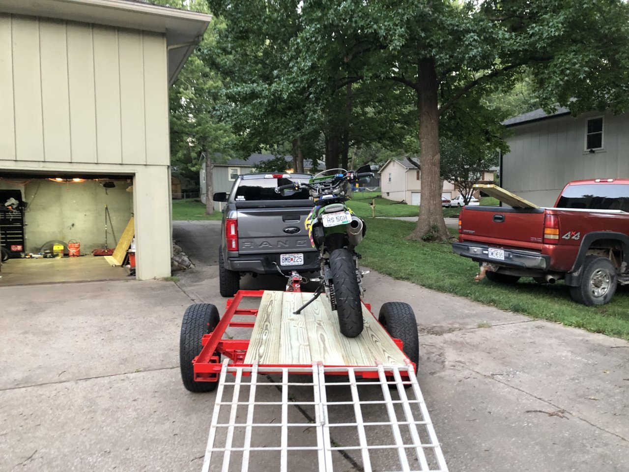

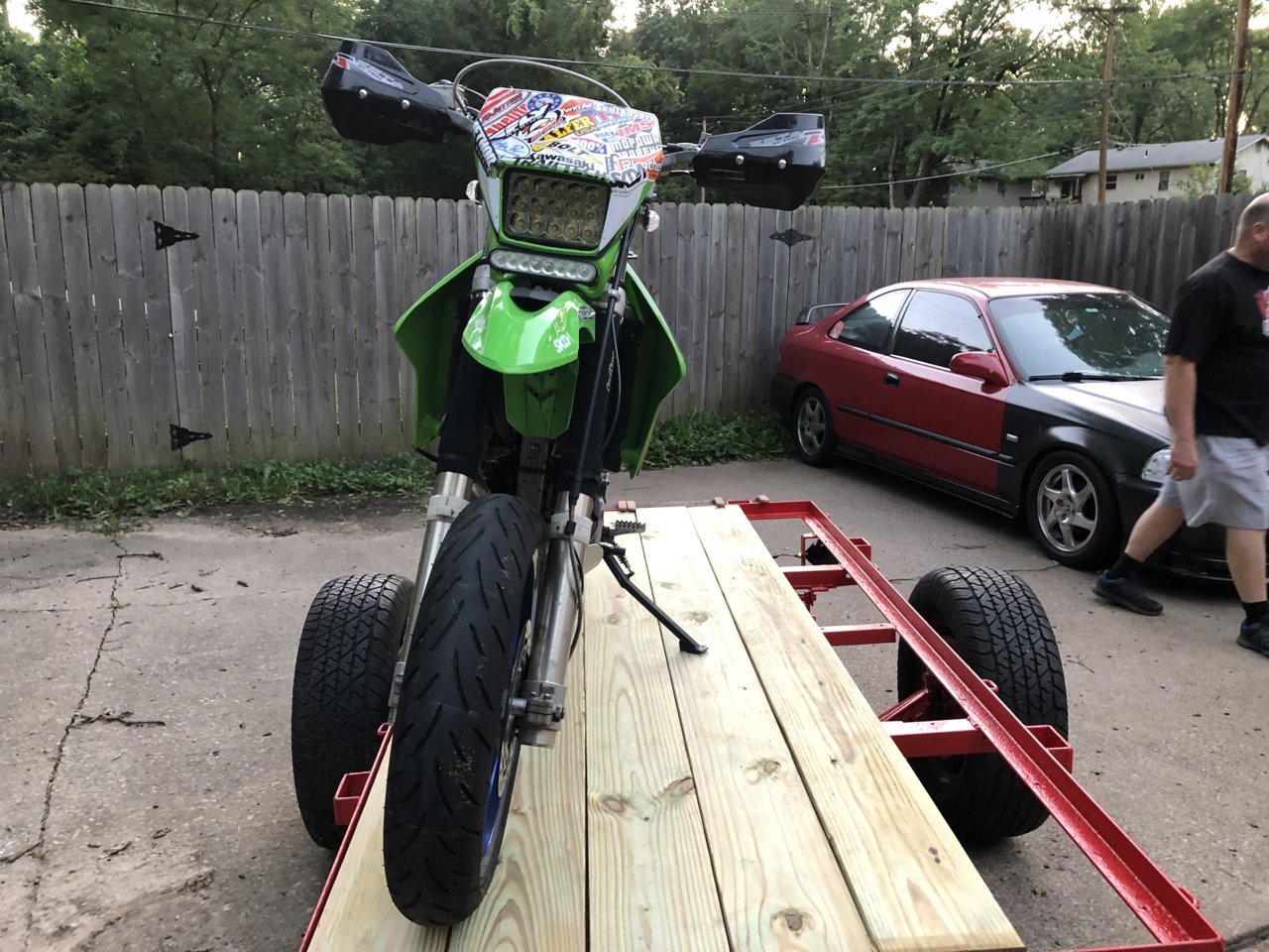

    Been working on this little utility trailer to tow bikes and also be universal for anything. It’s still got more work to go but it’s getting closer

    A little trailer like that has so much utility. I have one mainly setup for my stand up jetski and the GF's smaller sit down jet ski, BUT under her skis bunks (which come off the trailer in ~10min) is a motorcycle rail for solo trips with the stand up and a motorcycle of my choosing.

    yup thats kinda the plan with it! ive always needed a small trailer that can carry stuff that doesnt fit in my bed or i just dont want t put in my bed! it will also be helpful to my dad or sister since they can both use it for what ever they might need and wont have to drive 20+mins out to get my dads larger trailer.
    funny enough this trailer has been around in the family since the late 80s? first my dads to haul some mowers on, then my uncle to haul a old harley then buel on it, then my grandfather for a small utility trailer on the property and then was given to me when i was 16 to haul an atv on but it was never used back then lmao im just now starting to mess with it.

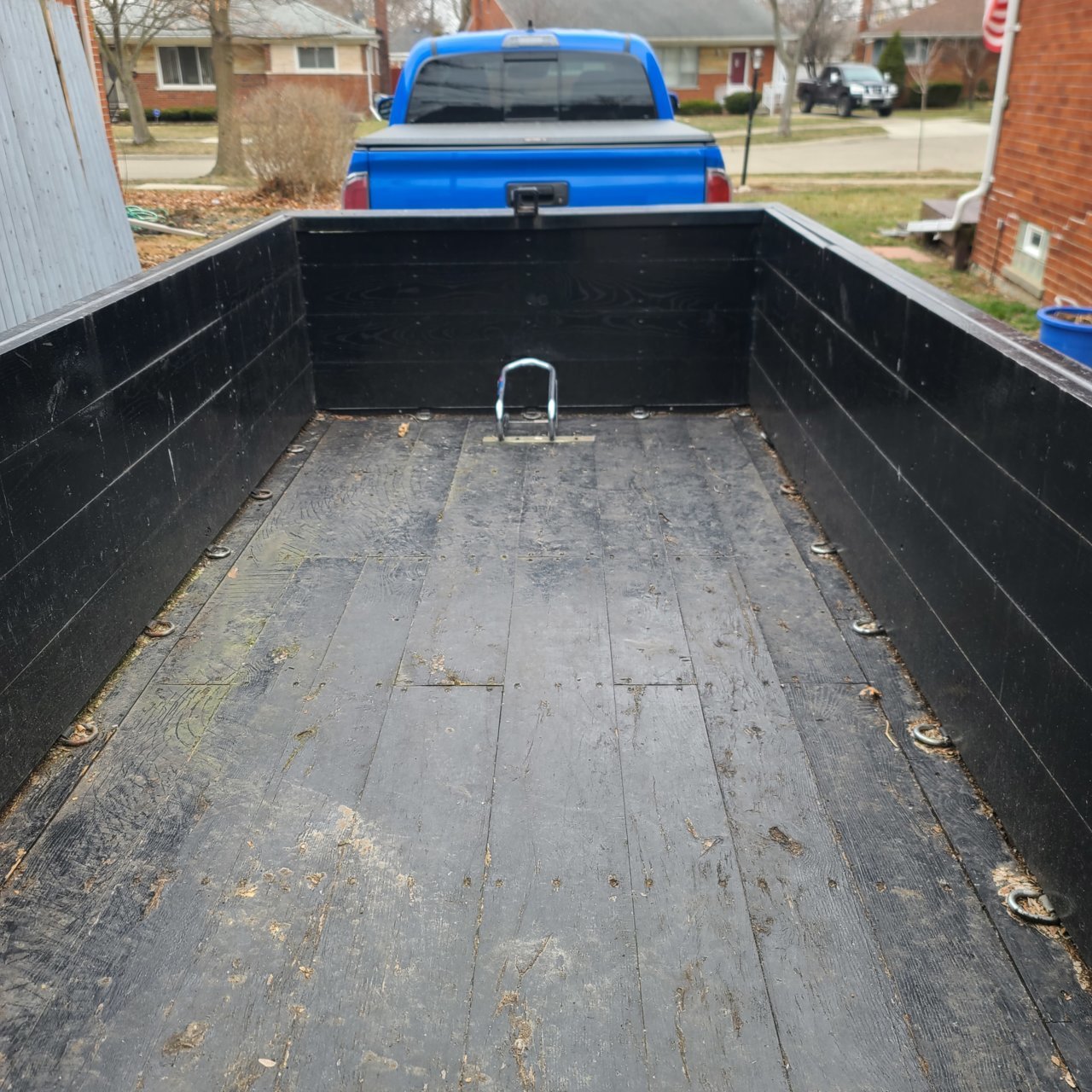

    Yeah small utility trailers are very useful, and it's better to beat up the trailer rather than your truck.

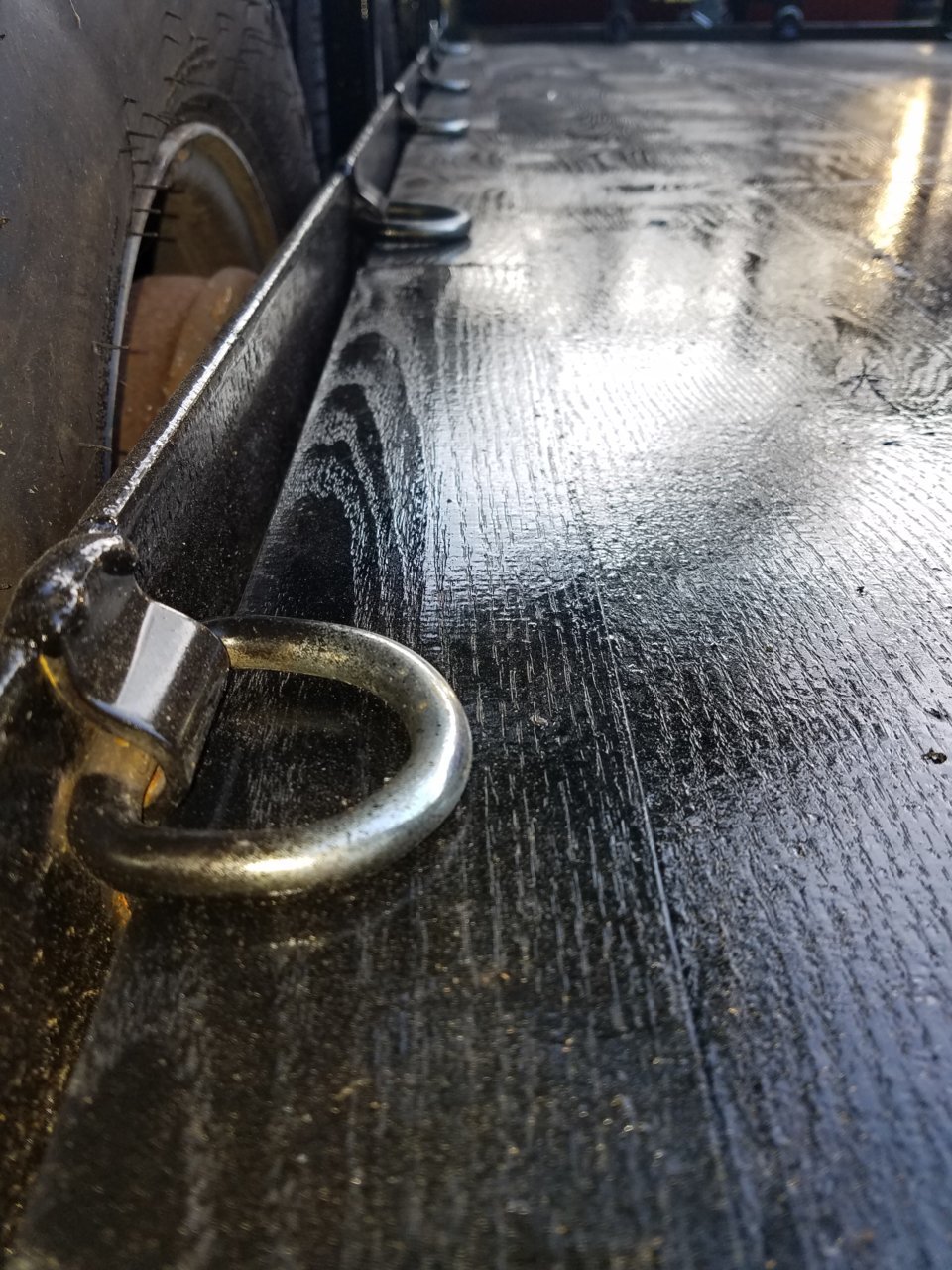

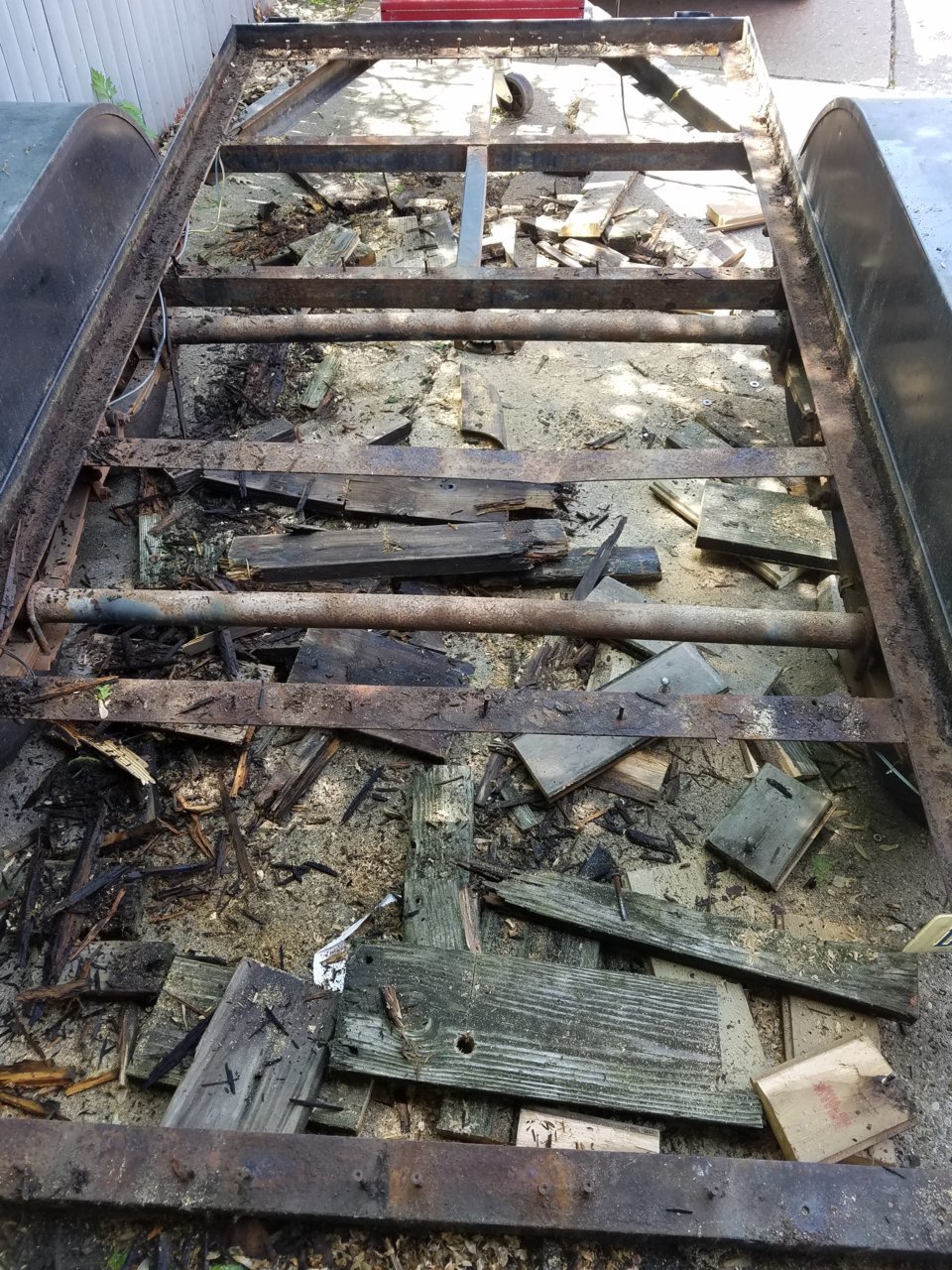

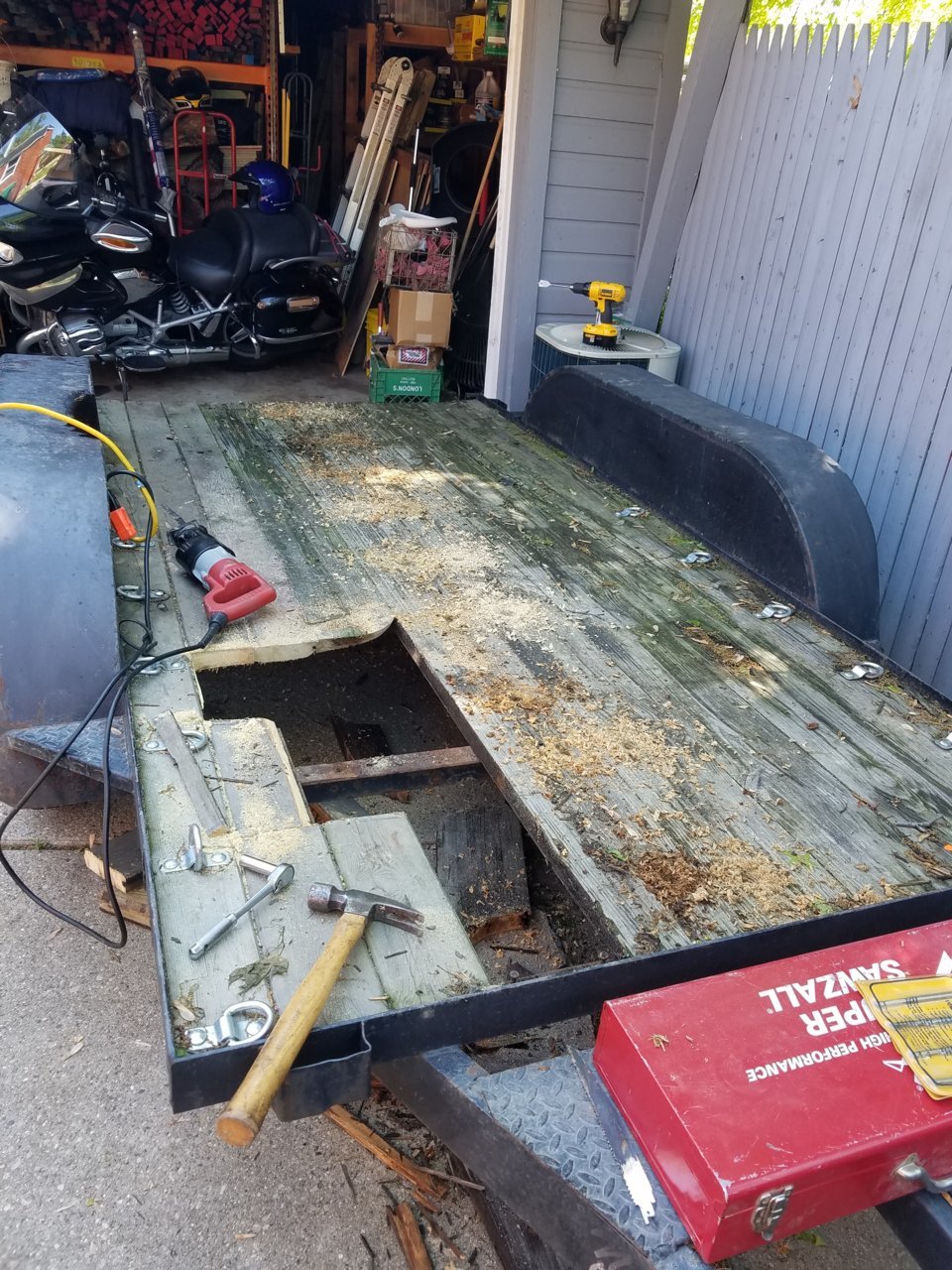

    I bought a 5x10 tandem axle trailer for $600 it had brand new galvanized wheels and new tires, worth it for just the wheels and tires. But you could poke your finger right through the rotted pine deck. So I stripped it.
    I found 1 bent crossmember, cut that out and replaced it.
    I welded in heavy duty d rings every foot all the way around.
    I welded up the sides with 1-1/2" square tube. Floor is now 2 inch oak, sides are 1 inch ash. Trailer now has removable Dutch doors. I welded on brackets for mag lights. They are now up nice and high and I will never lay under a trailer again fixing light wiring. And I can see the lights in my rear view mirror to see if they are working. If they take a shit it's only $30 for a new set.
    Loaded with 2 tons of lanscape bricks.
    At menards picking up shingles, better to beat the trailer than the taco.
    Wheel chock is quick detach, notice the d rings for tie down.

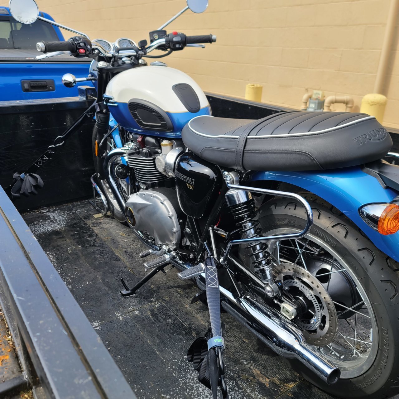

    Perfect for bringing the new bonneville home.
    I have hauled dirt, broken concrete, roof tearoffs, lumber, you name it. Yup a utility trailer is very usefull. And the taco has no problem towing it with a 2 ton load. Although I wouldn't take it on the highway with that much weight.

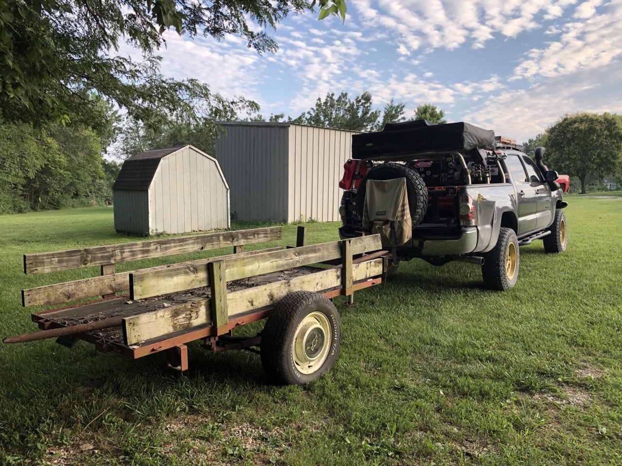

    thats a great deal for 600! i think i have a pic of mine when i pulled it out of the overgrowth 3 somethin years ago let me look lol.
    the end goal is a lot of work to be done on this trailer. sides being built, new wheel bearings, fenders, another coat of paint, side lights/corner markers, and then eventually a dove tail and a small ramp built into it, and eventually as well adding a rtt rack at the front so when i go camping with the bike i can use my tent but i want it so it can come on and off my dad wants it just welded on. but for a free trailer thats roughly 4x8 its gonna be great to use
