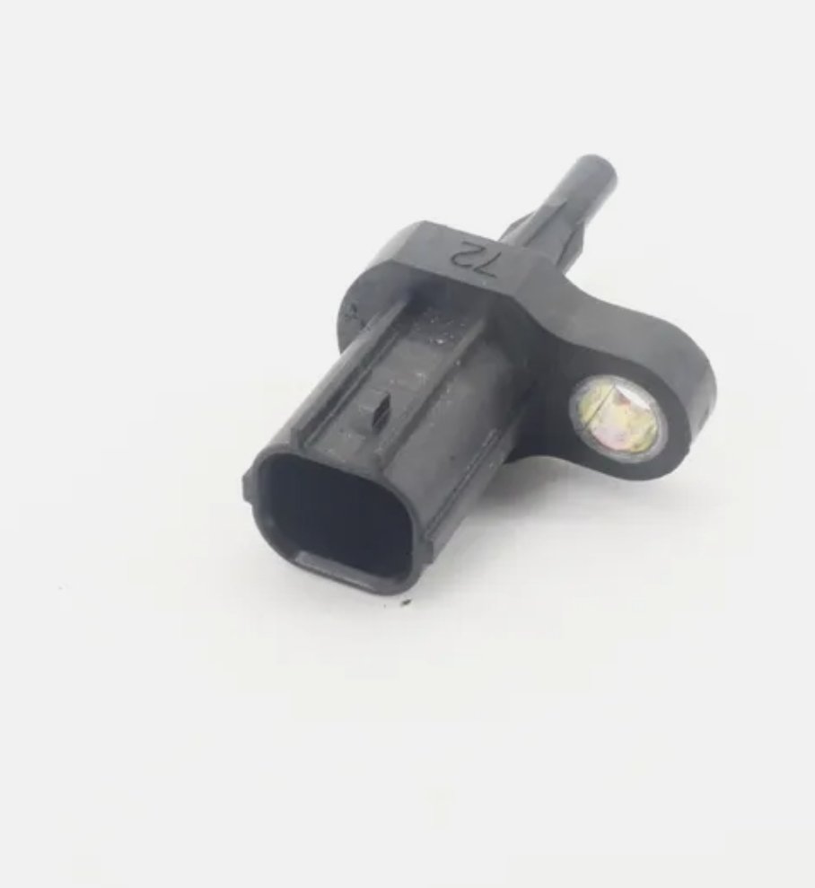

    Also does anyone know the name / source for connectors that would plug into this. I wanna try an experiment but need to make an extension harness so I need a male and female plug to plug into this intake air temp sensor. (2 pin)
