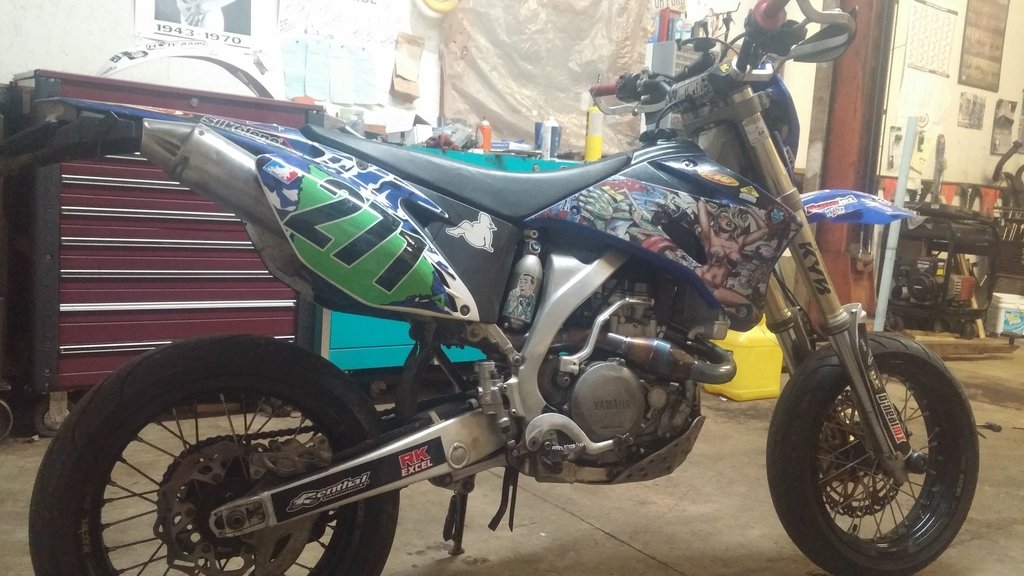

    Heres a couple shots of my motard.
    07 wr450
    Venom head, hotcams, bored carb to 44mm,
    Hi c piston, slipper clutch, brembo radial master cyl, braking sm caliper, steel lines. .
    Other stuff im sure im forgetting

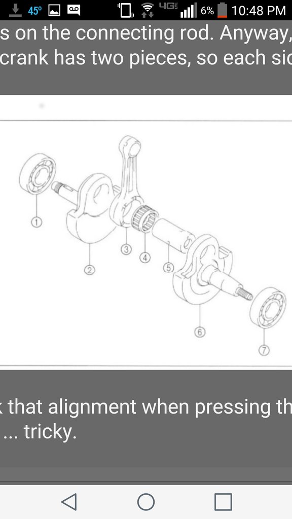

    Im talking about the pin that connects the two crank halves together and the big end of the rod rides on.
    #5 in the pic
