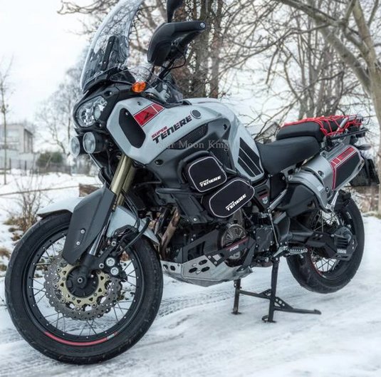

    Any thoughts on the little bags that go in the Givi frame?

    Not my cup of tea because of exposure during a fall etc. But could definitely be a good option if you needed extra storage!

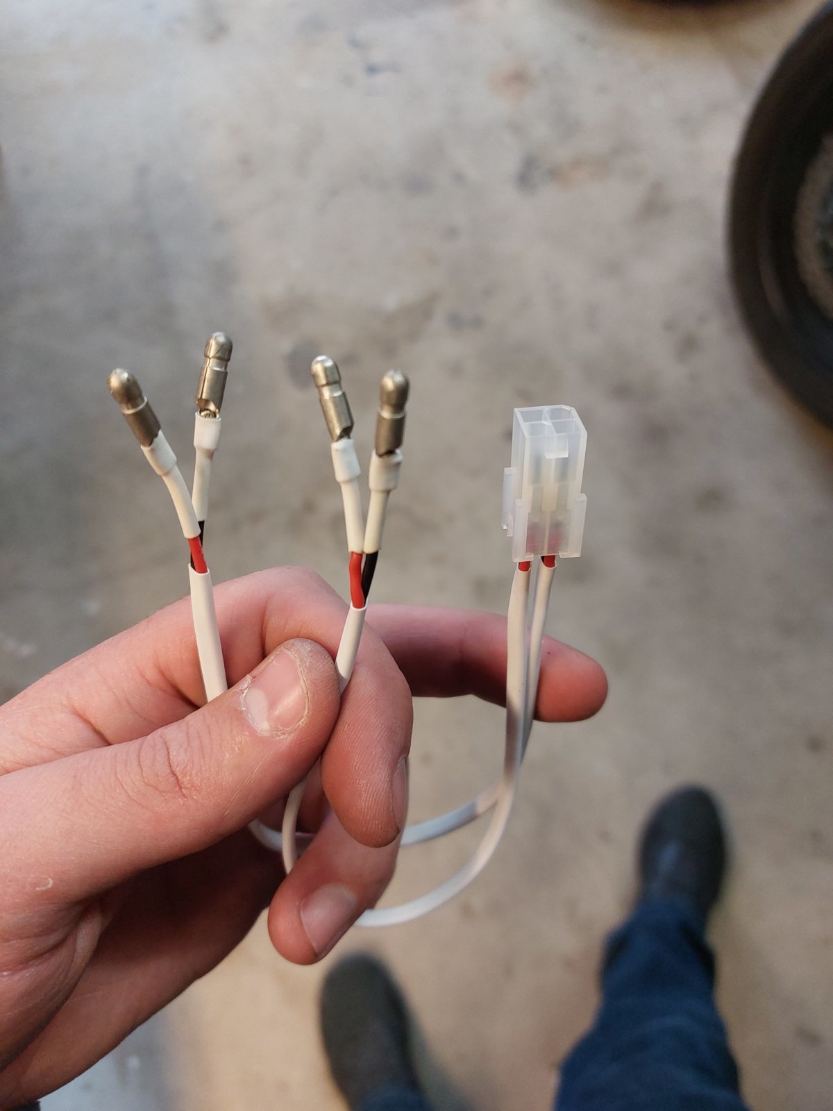

    Alrighty! More XT225 updates.
    Got a battery n blinkers so I could button things up. I wanted to mount blinkers to the promoto billet rack, wanted something small n out of the way but bright enough to be seen. I wanted to mount to the rack as I removed the entire huge stock rear taillight/brake light/ blinker assembly that's known to break the first time that falls over. As well as making it so the blinkers can come off easy via rack removal (4 bolts).
    This meant I needed to make a little harness so that the blinkers could be unplugged easily via one plug. I just so happened to have a nice small 4 pin plug at my disposal and other various supplies. I actually, honestly, really enjoy wiring.
    Moto side of the mini sub harness to plug into the stock bullet connectors and put the single plug in a spot much more easily accessible.
    Plugged in under the side panel (accessible via one simple cap head Allen screw)

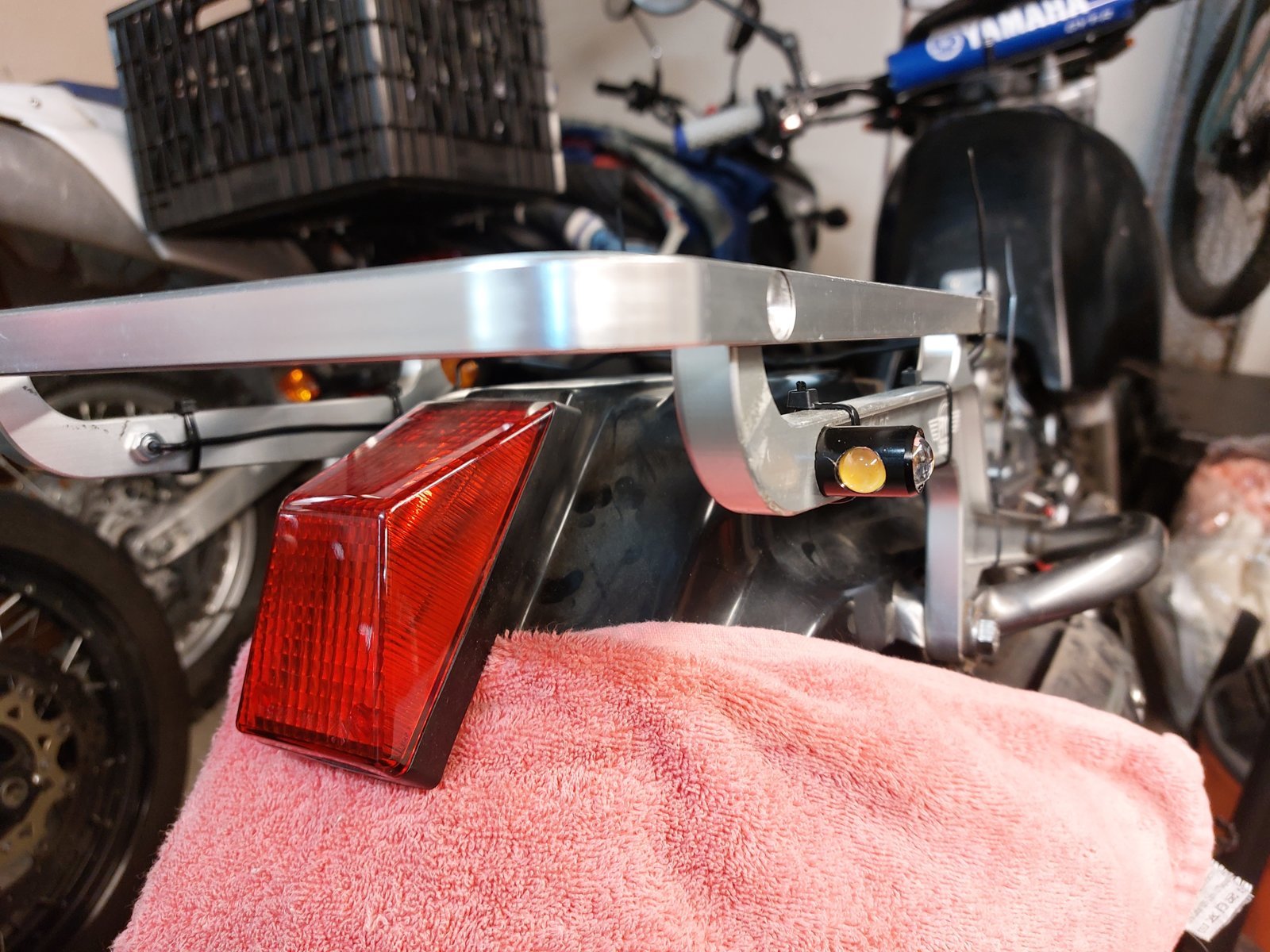

    And the lil blinkers!
    These little blinkers are neat! They have a rearward and side facing LEDs and are STUPID bright... Brighter than the DOT approved OEM led blinkers on my super tenere.

    Friend of mine has something like that on his BMW. As already stated you don't want anything in them breakable. Blaine uses his for extra gloves, micro fiber towel for face shield cleaning, stuff like that, light in weight and soft that would take up space elsewhere.

    I wanted to put my tools in there but I’m guessing that’s not a great idea.

    Given that your radiator is under the left panned right behind those bars, I wouldn't put a bag there that can fit through the holes in the bars. Same goes for bag contents. Punching a hole in the radiator is a crap way to end a ride.

    So long as they're not breakable or packed with anything breakable it won't hurt. My only thought is having any real weight hanging there and how to deal with it if bike would be dropped. I'd rather use them for softer yet bulky items that I need access to.

    The super tenere standing still / moving slow is top heavy no doubt. I have ridden motos 23 yrs and VERY rarely fall in the dirt *knocks on wood* and have only dropped/fell over on the 919 once in the 13yrs I owned it.
    In the just over a year of super tenere ownership, I have fully dropped it twice and definitely had a few ohhhh shit moments as I caught it. One as I went to leave going through some soft dirt and got off balance, and another time trying to make a U turn on a small road slowly. The crash bars saved the bike both times, but I definitely wouldn't of wanted anything on them to get smashed. The givi crash bars have some of the shittiest welds / construction I have ever seen BUT with some extra weld and a smidge of bracing make for good crash bars.
    Also @50Buck makes a great point. Radiator being on the left side you need to have that area open for the bike to breathe. Stock the tenere will turn on the fan at 220 (and it gets there quick without much airflow, not much thermal mass from a small amount of coolant) so you want to be able to get things cooled quickly

    Shit, I didn't even think about the airflow. LMAO. That's a way more likely issue than a puncture.

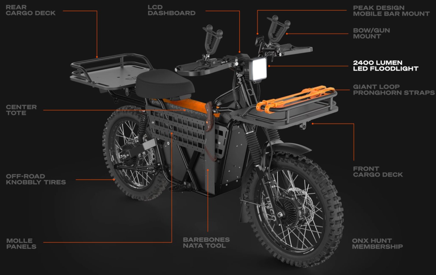

    Rokons are sweet. If I were looking for something like that though, personally, I'd go a bit more modern with a Ubco 2x2.
    https://ubco.com/pages/2x2-electric-bike
    Their hunting edition is sick, IMHO.

    Very cool, but definitely not what I'm looking for.
    I need something that I don't need to charge, as we go into the bush for weeks at a time and is capable of climbing 60deg slopes, as it is something I'll be taking to Moab with us.
    I also need something that is extremely robust and want something that doesn't require or rely on modern technology.
    Also, I need something that can tow over 1500 lbs as we will also have a need to mend/check fences and haul things around my buddies property that is pretty undeveloped and rugged.
    I'd also really prefer something that was capable of over 30 mph as well if possible, although I see the Ubcos top speed is 30

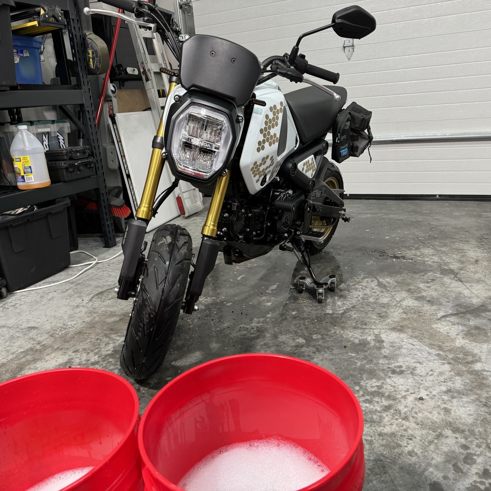

    Grom got a sponge bath, then gave it and the F800GS some very much needed chain-love. Figured out where I'm mounting my lights when they get here, and then spent an hour pondering switch placement. Still haven't quite figured out what I'll do. I don't love the mounting points available to me behind the dash. Don't love putting another set of switches on the handlebars, either, as I rock the hippo hands and there isn't much room nor are they visible. All in all, solid Sunday afternoon.
