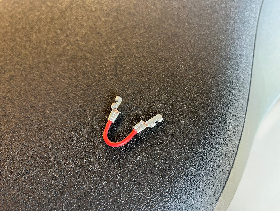

    I also decided to make a jumper to cycle the ABS pump so I wouldn't have to fall off the bike on a gravel road. I had a few female spade connectors lying around so I just cut two down, crimped them onto a piece of wire and plugged it into the plug and it works! I'll have to take a video of it later.

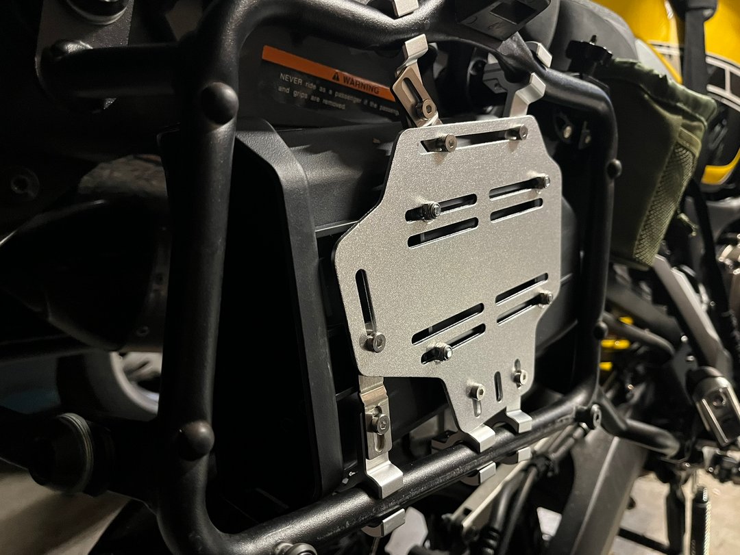

    Then the Aliexpress Givi S250 tool box knockoff arrived unexpectedly so I decided to tinker with that instead. Got it all mounted up:

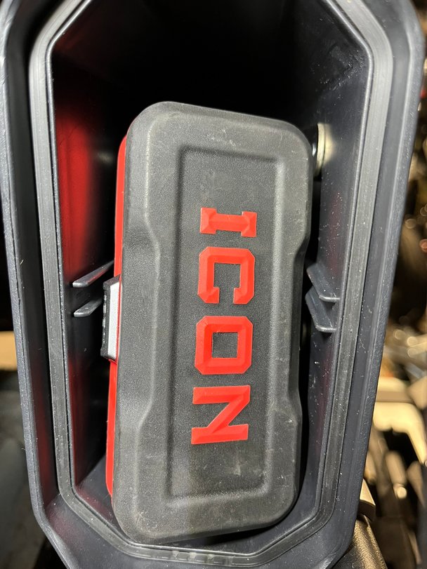

    The box fits my portable air pump, Cruz tools wrench, Knipex pliers wrench, Icon tool kit and a rope plug kit. I also stuck the key underneath my seat for easy access.

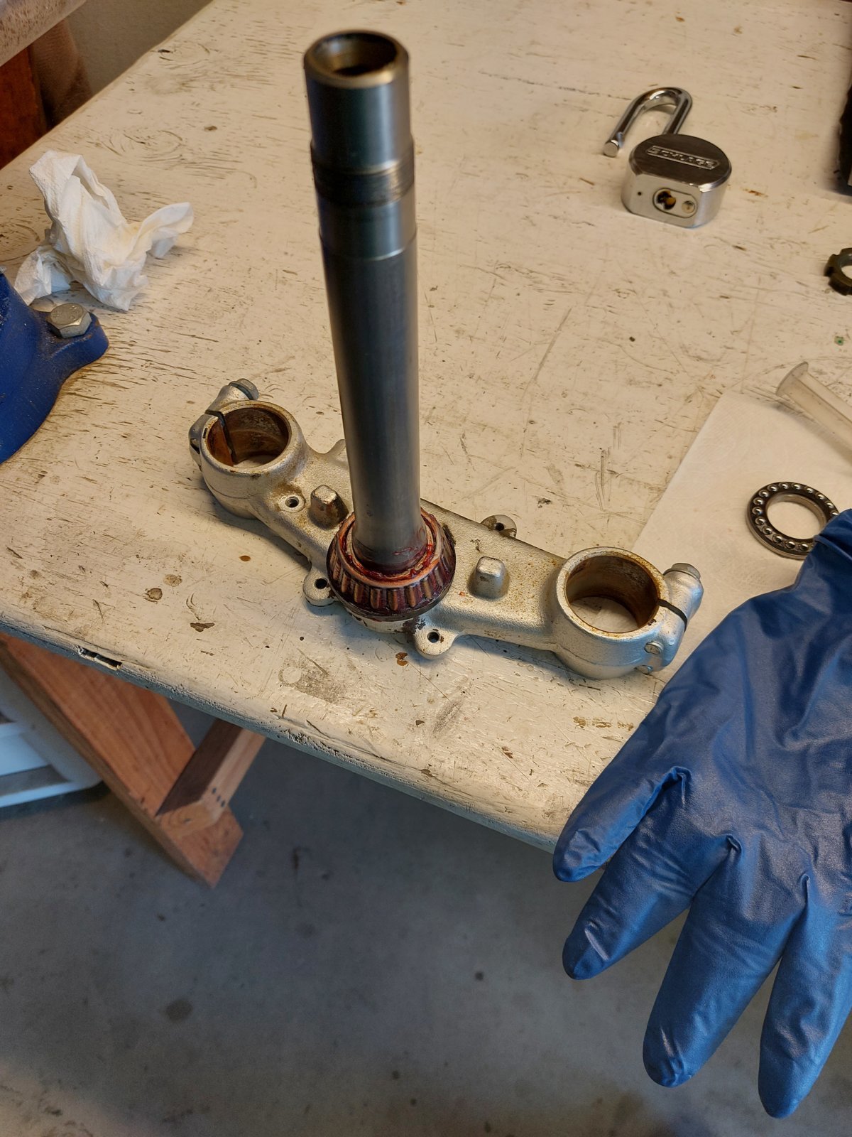

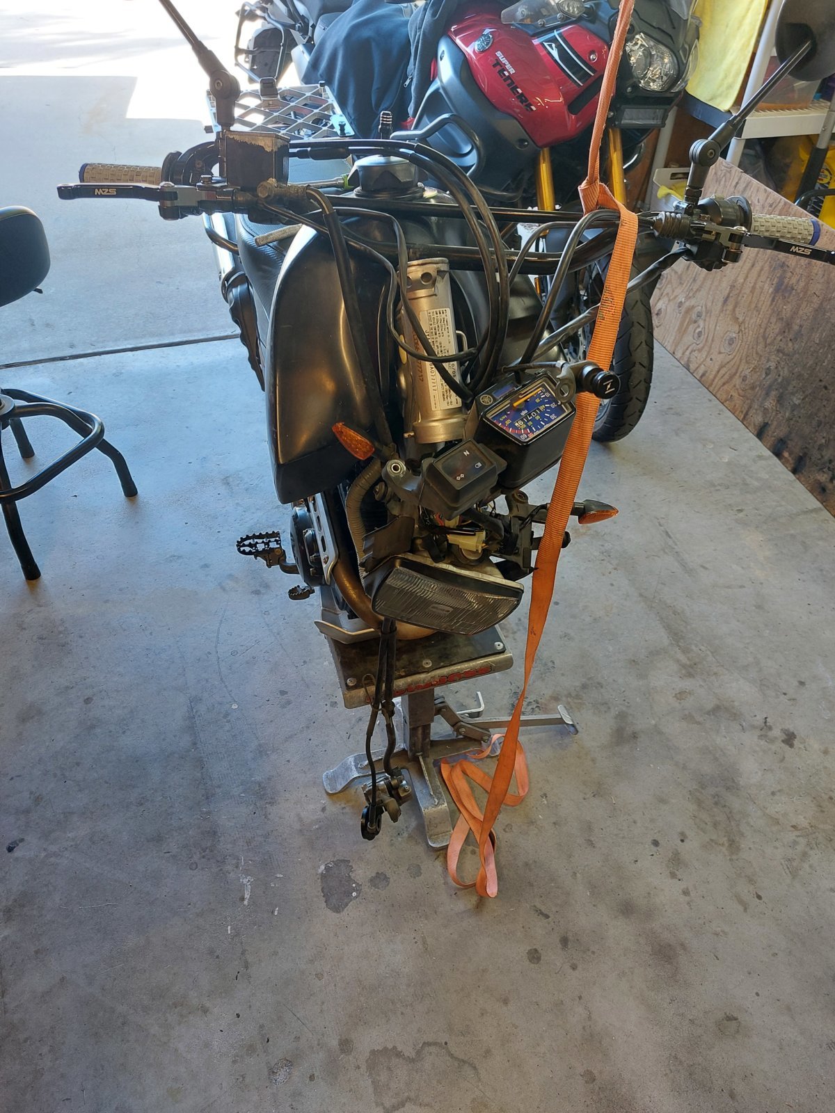

    XT225 things. Steering stem bearing inspection and greasing. Definitely a pain as EVERYTHING is mounted to the triples and front forks (unlike the super tenere... the S10 was actually easier to do this job).
    Pulled everything apart, bearings looked good everything was smooth with no seeable notching or issues. Grease was definitely there but old and somewhat dried out. Cleaned up everything and greased heavily with red-n-tacky and spun bearings randomly to help with any notching. The same special socket I had bought for the super tenere also worked for the stem nut of the xt225 so I was able to go through the torque sequence properly. @but why tho LMK when you need this socket for your tenere. Torqued back up and its smooth but there is an uber tiney SMIDGE of notchieness rather far from center but I really think the wandering "bowling ball bumpers feeling" nature is from the SKINNY 2.75in front but it was stupid cheap so.... cant complain to much. Its was worth my time to make sure everything was proper and in the end steering is properly tight, smooth and greased.
    Bearing setup is interesting on the XT225. Bigger tapered bearing on the bottom and a standard small ball bearing on the top
    I THINK, I might be at the point of "just ride it" with the XT225, I could keep tinkering on it (and probably will) but the major things and changes needed to get me to project grom replacement are done. Ive already put more miles on it in the last 2-3 weeks vs the prior 4 years so thats a win haha.
    Come to think of it... should of probably got some fork oil and changed that out while I had forks out. Add that to the list, as well as the tenere!

    Here is the link to the box:
    https://www.aliexpress.us/item/3256...st_main.5.cb3b1802etdccO&gatewayAdapt=glo2usa
    It came out to ~$70 with shipping and tax, which is still like $50 cheaper than the Givi and the Givi doesn't come with mounting options (I think that's separate as well).

    Retorquing the front steering stem nut is pretty quick and easy and wouldn't have any impact on doing the valve job or not. Lots are under torqued / loose at even your mileage. When you do change the front tire you are already half way there to pulling the forks to pull the front apart for clean / inspection / grease and torque.

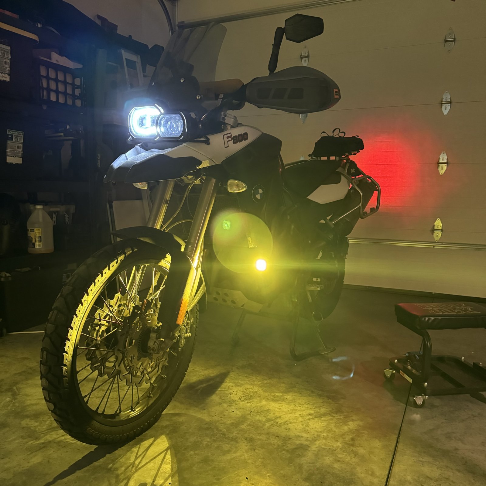

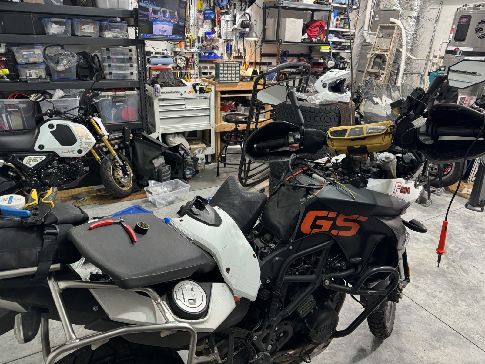

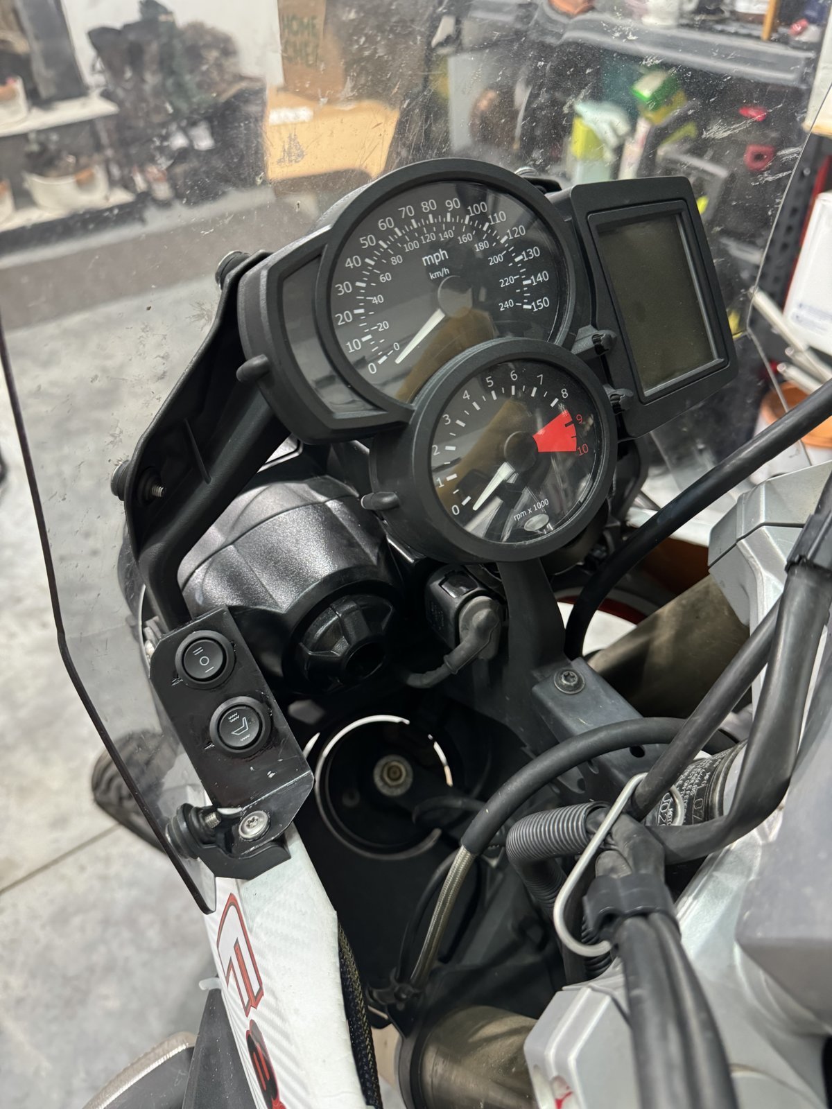

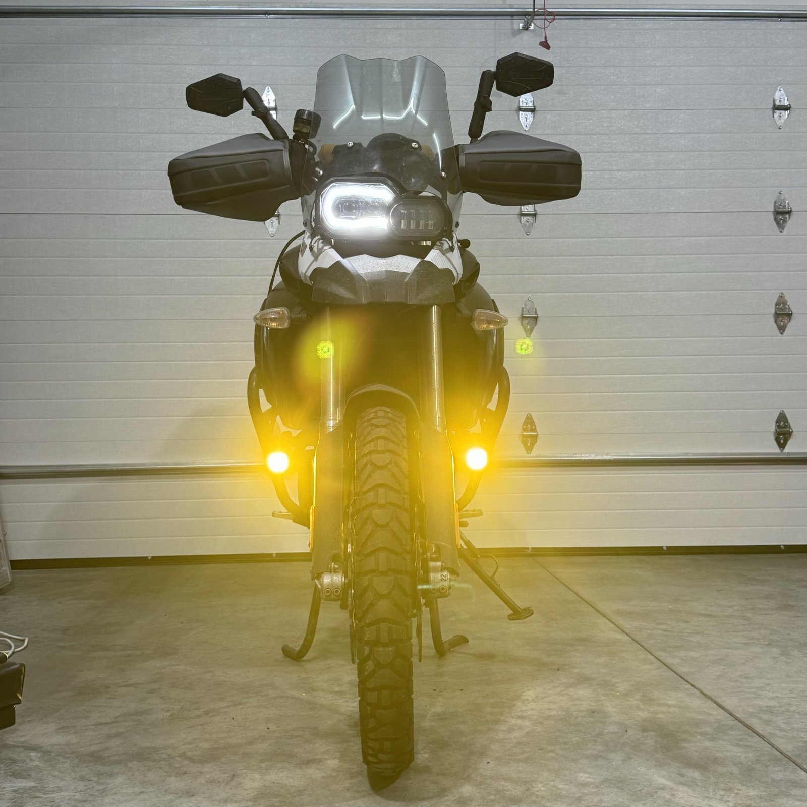

    Lights are done! Didn’t do the relay harness to clean up my terminals and add in an ignition relay, but I did at least make a little bracket for my buttons.
    Really happy with the lights and how it came out, even if I did have to hack up a $40 harness.
    Edit: two quick notes 1) I bent the bracket around a bit more to match the angle of the dash better and 2) thats just my DRL, again. I'll try to get some pattern pics at some point soon.
