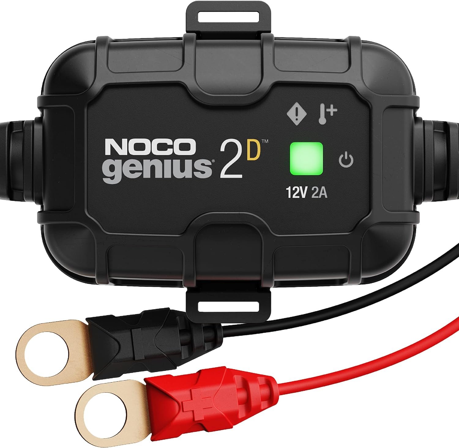

    Phil, The pictured charger (Genius 2D) is a direct mount charger, which means it will always be attached to the bike. Unless you disconnect it from the battery. Also that one is for the standard lead acid, flooded and AGM batteries. If you are going with the Noco Lithium battery.. Go with Standard, Genius 2. That will cover all batteries, plus the Lithium. Also the G2 comes with alligator clips, but you can unscrew the wire from the alligator clips and hard wire straight to the battery. the pigtail disconnects from the charger itself too.

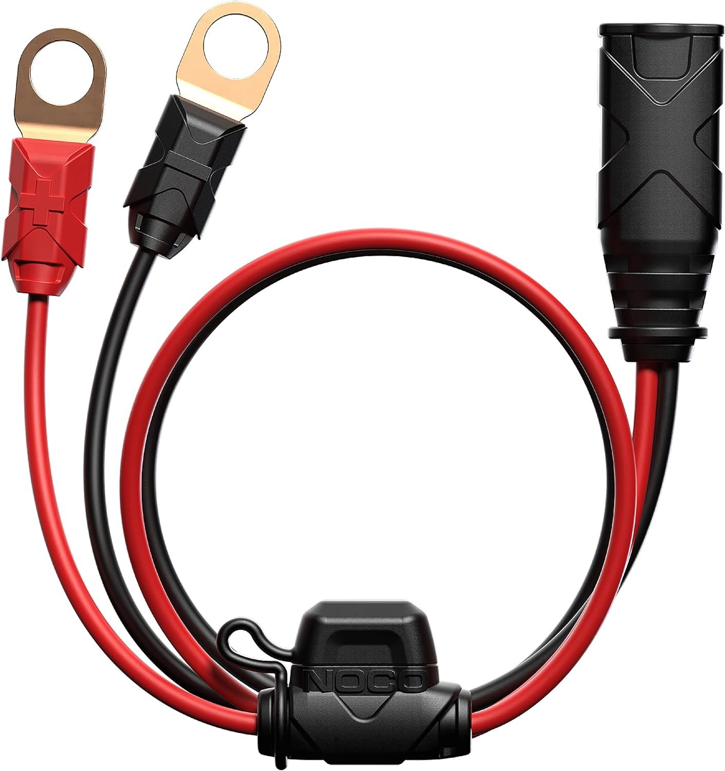

    Also of note: The X-connect isn't as useful as a standard SAE lead, but you can adapt between the two. With a standard SAE lead you can plug in heated gear, usb converters, voltmeters, etc. There's a whole ecosystem there. X-connect has some of that, but its not nearly as common.
    For example, I have SAE leads on two of my 4 bikes and can easily use these on them: https://www.amazon.com/dp/B00DJ5KEF4
    But then use this: https://www.amazon.com/GC009-X-Connect-Accessory-Genius-Chargers/dp/B005DUMADC to then use my NOCO chargers.
    The other two I only charge and never connect accessories, so I just have the x-connect harnesses on those.

    That goes the opposite way, unfortunately, from bike SAE to Noco charger. SAE is a flippable connecter with no plug and receptacle (male/female) ends just the one style, which can be dangerous if you aren't keeping track of your polarity when plugging things together, but X-Connect is not and has male and female ends.
