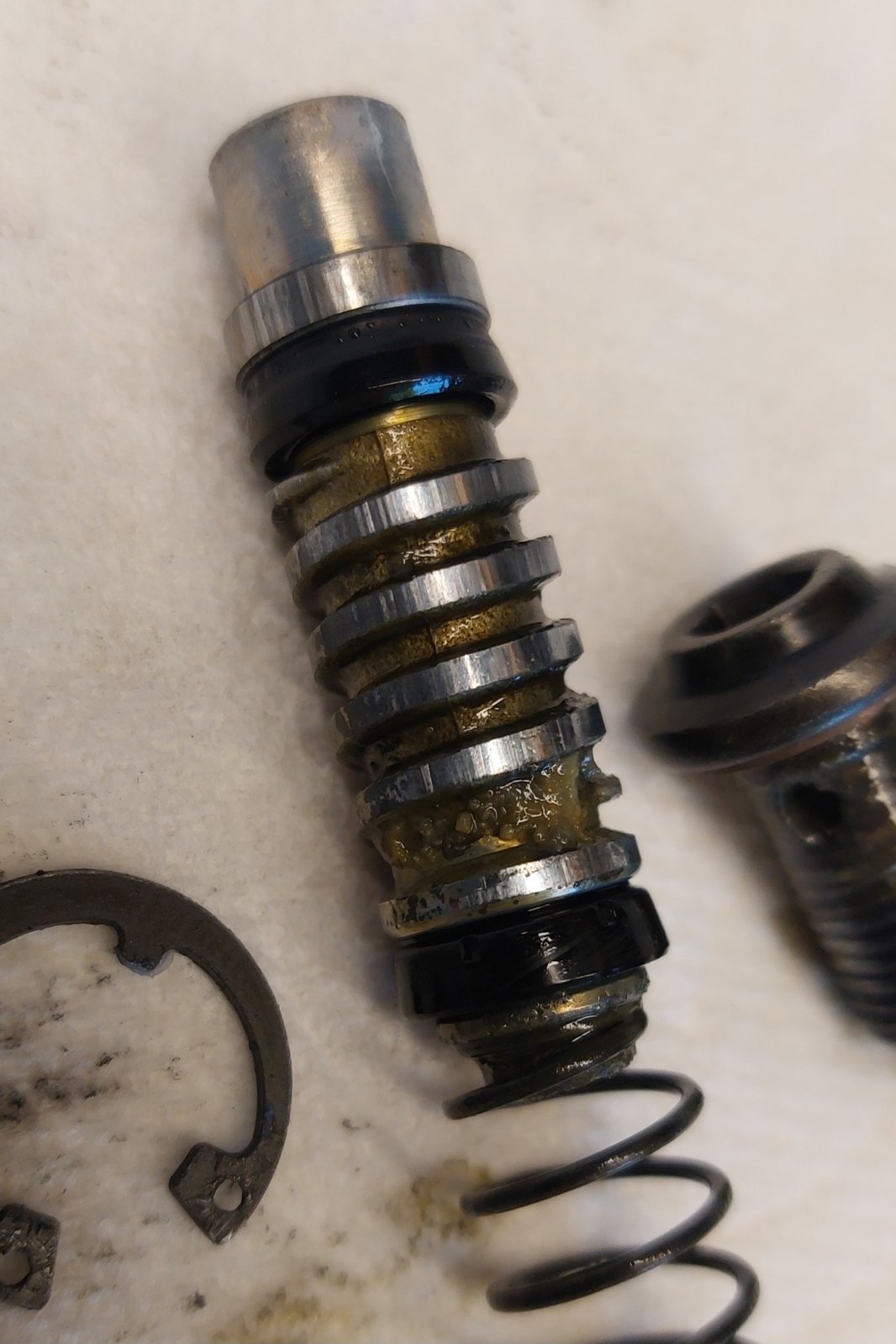

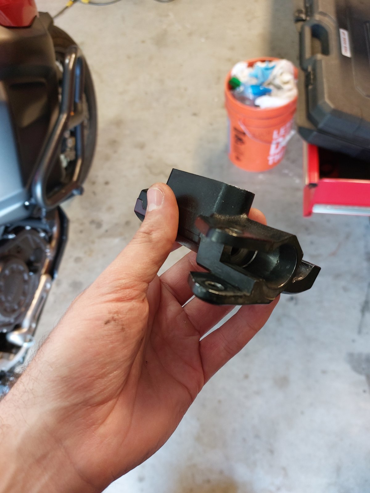

    Been meaning to do this for awhile. Clutch master cylinder rebuild. Never done one before.
    I have had the rebuild kit ($30ish) for a few months and when I got the super tenere a little over a year ago the clutch fluid was DISGUSTING.... Most certainly was the original fluid with 7yrs and 21k miles (at the time) on it. So I flushed the hell out of it a year ago but I had a good hunch based on others who have seen the same that there would be lots junk and piston wear that if not caught quick enough can take out the slave cylinder, which no one offers a rebuild kit for and the unit as a whole is a rareish part that is $$$.
    Pulled it and was definitely glad I did. You can see all the crud n junk by the seal near the spring and that was only about half of it.
    Fully stripped and brake cleaner cleaned out.
    I got it all back together and am in the process of bleeding the air out... My dumb ass sucked air in with low master rez level right as things were looking air free. DOH!
    @but why tho ... Check your clutch n brake fluids and flush em! Actually that goes for EVERYONE here... It's such an overlooked maintenance item.

    Realistically.... (With the super tenere) at least.
    This stuff was not needed, the clutch master was designed to hold crud in a low spot to hopefully not introduce it into the slave, but I didn't want that possibly in the back of my mind.
    95% of the "out side of standard maintenance" stuff I have done on the bike would be unneeded for a normal person riding it till easily 100k mi on the clock. I am probably one of the hardest riders a super tenere has ever seen it lives it's normal life in the canyons getting flogged - red line and revlimiter seen probably multiple times every outing, and find myself by myself in remote places often. Higher stakes stuff.
    I'm also just a stickler and worry wart. I need to know things are damn near 100% best to my knowledge and covered and good before fully trusting a mechanical thing (and realistically most things in life) which is why I do weird stuff like this even if it's functioning fine.
    The ONLY thing outside of standard fluid maintenance (which still everyone SHOULD ABSOLUTELY FLUSH BRAKES AND HYDRAULIC CLUTCH systems) which NEEDED to be done has been a retorquing of the steering stem bearing preload nut.

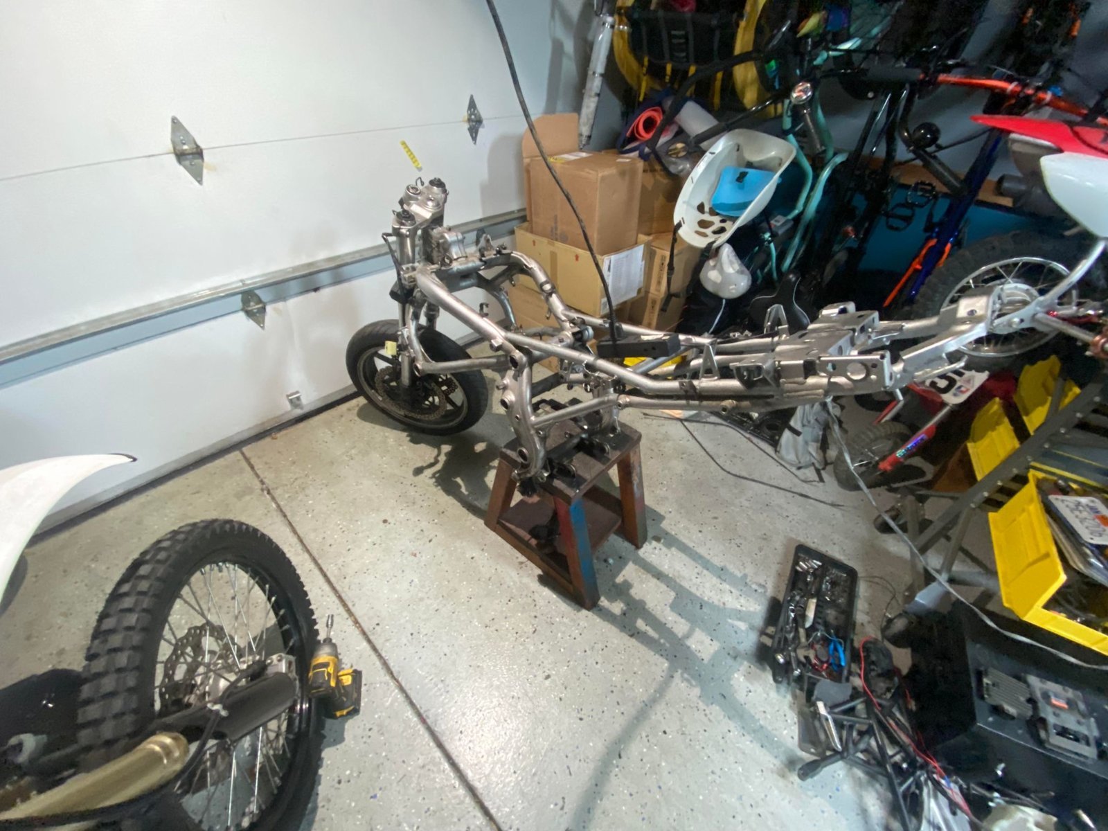

    So... the guy who picked it up has been sending me pics. I don't think it's going to run again. :p
    He builds other bikes and wanted the parts to harvest, so it'll still live on in some other bikes. Dude is SUPER cool, has a 2017 Super Tenere and wants to go riding. Best of all, he lives a mile away from me! So I might have gotten a riding/wrenching buddy out of it?
