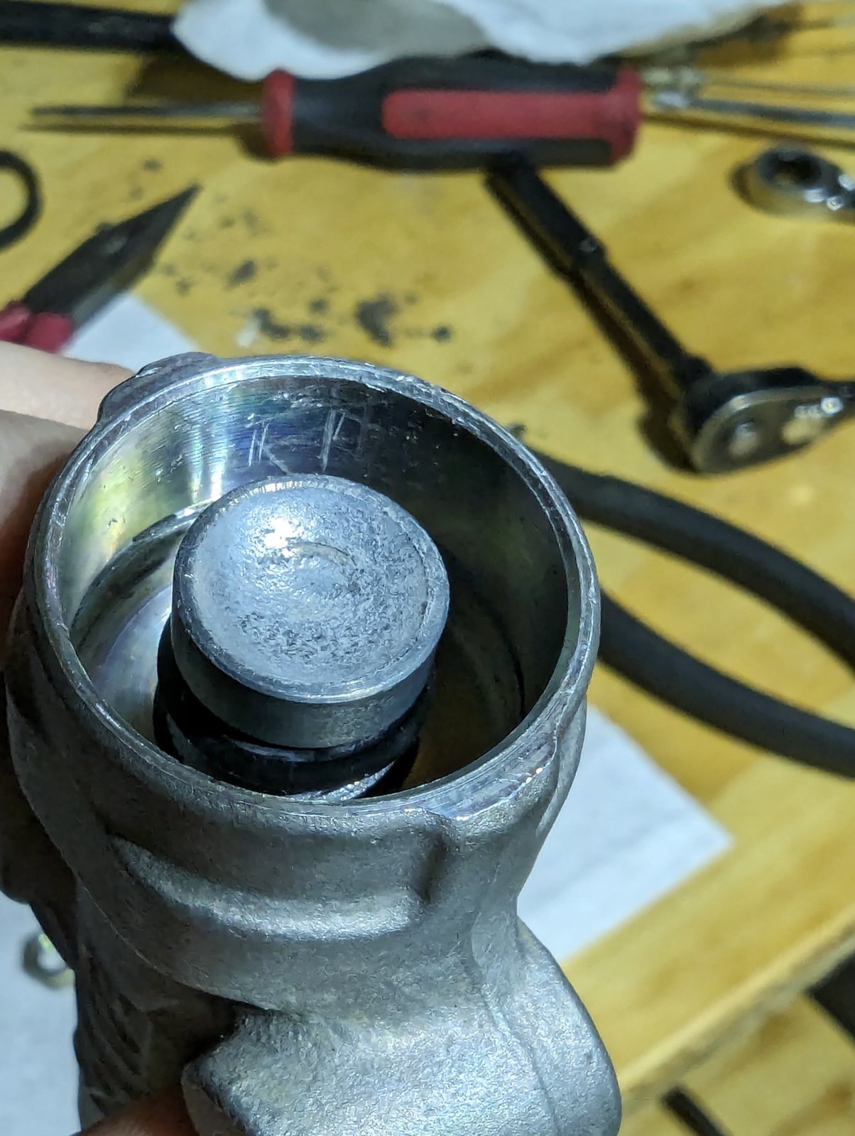

    Should be able to use a pick?

    Take a pic of the master looking down the bore. I have ideas.

    atm out currently to get a non crappy snap ring pliers (i have the ones that you can swap the head on) im also not sure about a pick with how stiff this snap ring is but when i get back ill take a pic

    But here is the pic you asked for. I also couldn't find the style of snap rings I wanted so I settled with these from harbor freight got a few other things I'd been wanting for awhile plus a chair to scoot around on while working on bikes.

    Get the snap ring started in the bore. (Hard corner flat side facing up).
    Then use a socket to gently tap it down in if your snap ring pliers can't make it down into the bore (this was my problem on the clutch master rebuild)

    I'll give it a shot but first dishes and pasta! Also is it normal for the master to be full of black gunk and corrosion?

    Oh yeah, brake fluid being hydroscopic loves to collect moisture in the low spots which causes all sorts of corrosion and gunk buildup paired with metal on metal rubbing in the master makes for nasty buildup. My clutch master on the super tenere was NASTY.... I should probably do the front brake master but I REALLY do not wanna bleed a full abs system, fluid is nice and fresh and lever is firm so I'll leave it be.

    Ah I gotcha ya mine had a lot of black sludge in it and crap so took a bit to clean it

    Oil changed, air filter re oiled(will need cleaned tomorrow), and finally it has a rear brake again! The rebuild was tbh easy and so much cheaper at 20 bucks!
