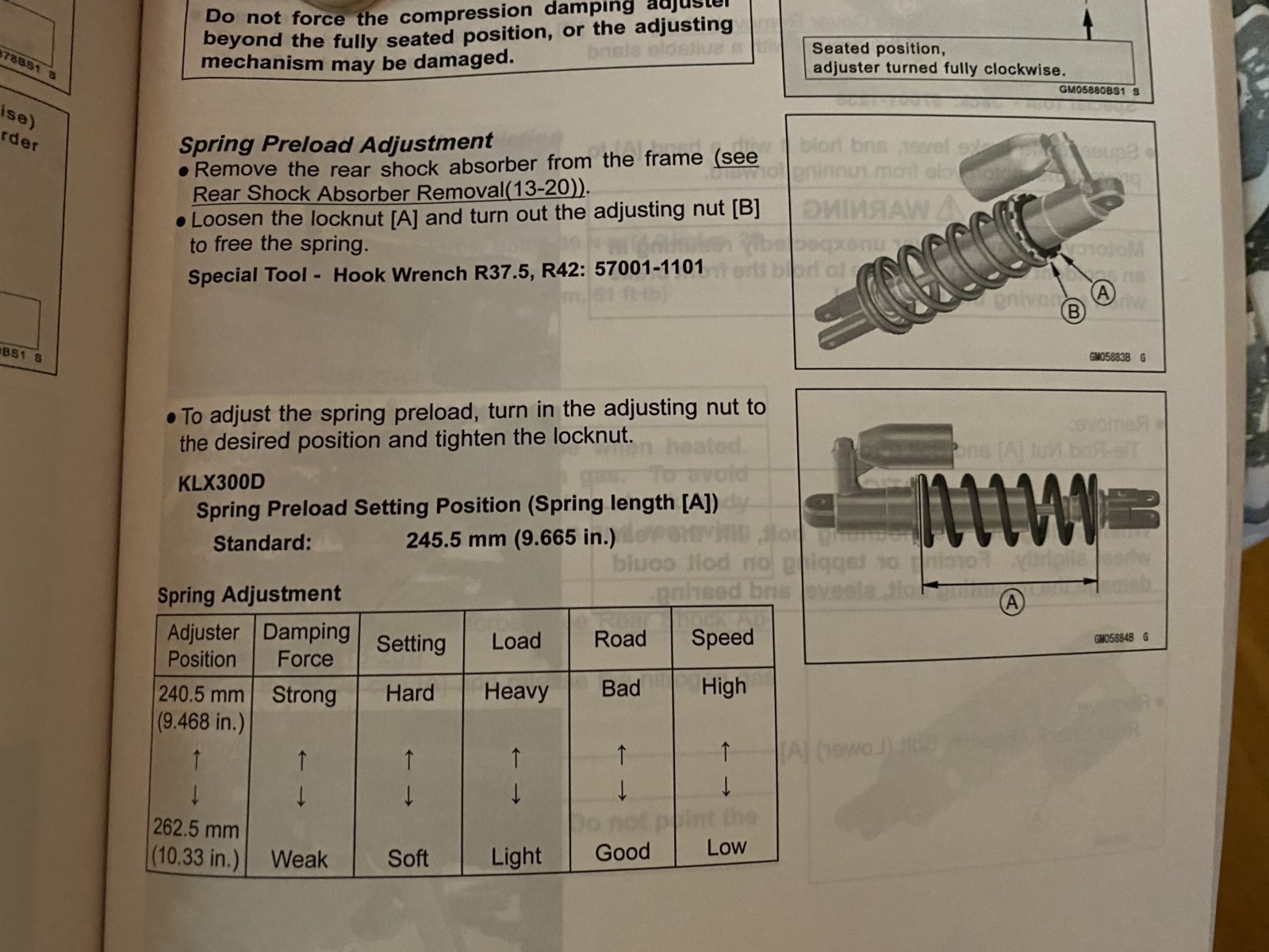

    Rite rite. That's exactly what I just came across a little while ago. Sag should be set in the top (as close to) 30% of the spring compression. Looks like we are on the same page. :thumbsup:
    Thanks for taking the time to look and help a moron.
    Yup. I was going through my service manual for preload adjustments.
    You are correct for the front as well. I haven’t played with the front yet.
    pic from the SM.
    Edit: Race Tech doesn’t have a heavy enough spring for my fat ass. So, if I do upgrade.. I’ll go with the heaviest the have.

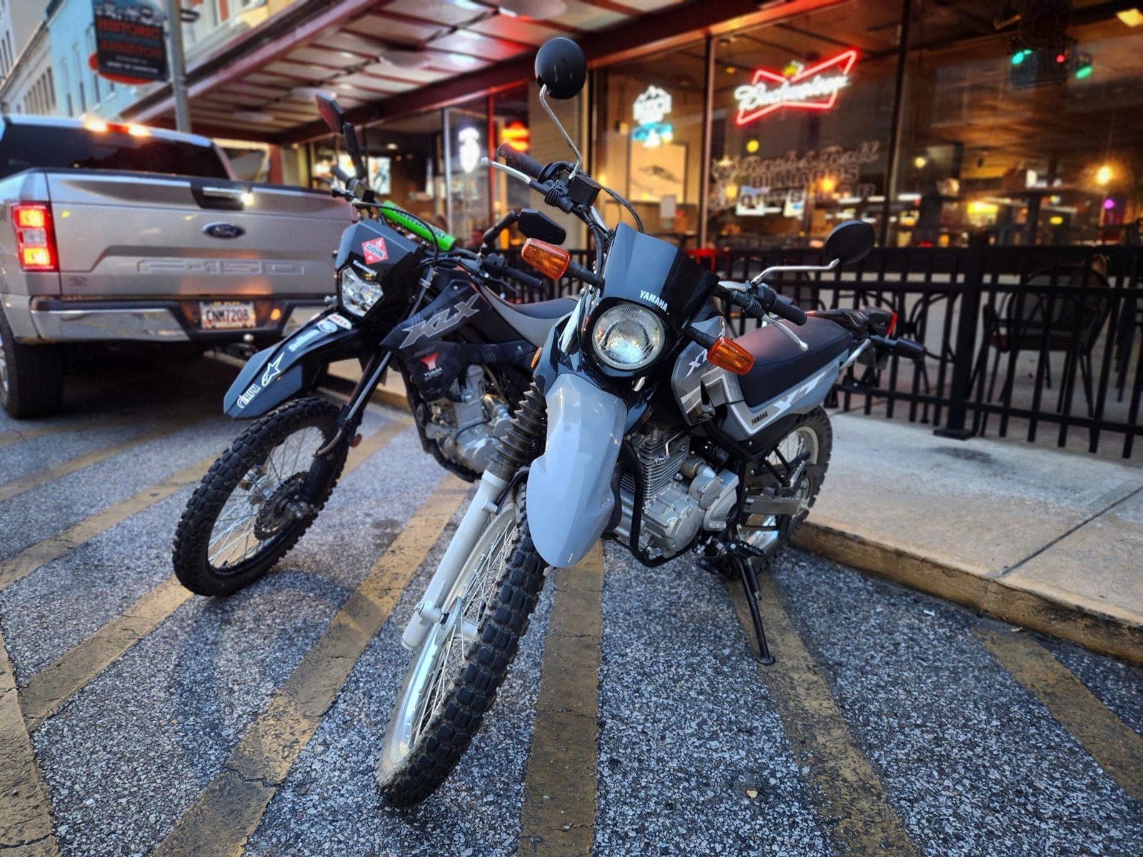

    Back in the saddle y’all! They can’t keep me down for too long.

    What a great pair! Looks like a great evening.

    It was! It’s actually been a good day all day. Finally opened the show that’s been kicking my ass last night, so I finally got a day off with a huge weight off my back. Plus feeling good enough in the shoulder to get back on a bike gave me a big spike in self-confidence again. The weather was nice all day, just hate it’s supposed to storm tomorrow.
