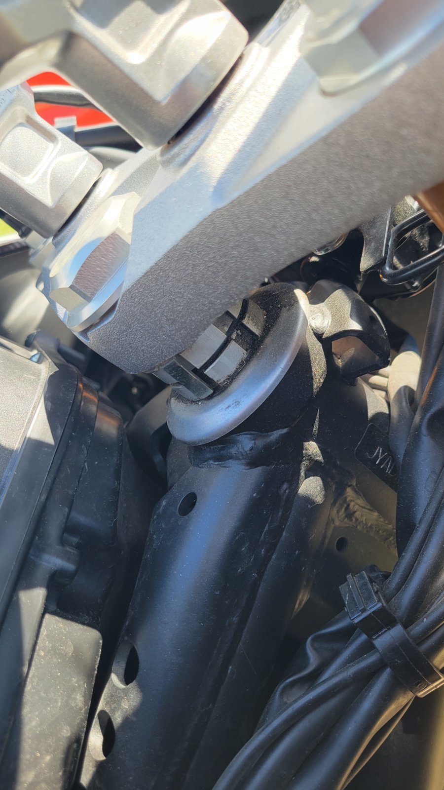

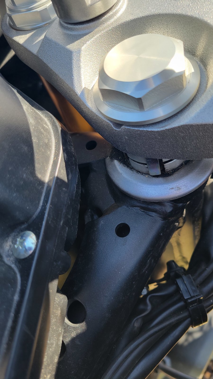

    You are good, thats just some excess grease from the bearings. At some point id recommend at the very least to pull the top triple clamp and do the proper torque sequence on the steering stem bearing preload (preferably add some grease to upper and lower stem bearings as well... but thats a bit more difficult without pulling the front tire/forks etc). There is a rubber washer of sorts between the two lock washers under the top triple that over time gets smooshed and lets the steering stem bearing preload get a little loose which is not good for bearing life or safe handling.
    I have the fancy finger socket for this job and would be happy to lend it out. (Its actually worked on all of my Yamaha motorcycles!)

    is yamaha just not good with neck bearings then? my bolt is starting to get that shimmy so its neck bearing will need to be replaced soon which is a common issue with them for some dumb reason! but i did know that going into getting this bike so oh well lol

    Don't be so quick to replace the neck bearings. Recheck them for proper torque and it will very likely clear that up. I do think for some reason this pops up more on Yamaha than other brands. The FJR1300 has this issue as well but I've now had 3 of those and have yet to replace neck bearings on any of them. Torque per the manual and just ride it.

    No, I have never had any issues with the yamaha stem/neck bearings in any of my bikes, just need to be re-torqued after many many miles. If im not mistaken the bolt being a budget bike uses for whatever reason uses standard ball bearings for the stem vs much preferred tapered roller bearings. There are definitely kits to replace them with tapered bearings which are much better.

    so its a common issue with the bolts that the neck bearings are just junk and they will start to wobble if you are not careful. atm mine will wobble if you let go of the bars fully but i can only do it for a few seconds before it gets bad. now its starting to wobble a little bit under slow speeds i notice it more.

    ah i gotcha i just know my buddy had issues with his t7 and another yamaha he had so was wondering if it was just something common with the brand in itself. you are correct about the bolts bearing ive been looking into the kits to replace it. atm its not bad but its getting there so instead of like i was wanting to replace it in winter it looks like i might have to do it sometime this summer but we will see. i know someone on here said they had a kit they would sell me but cant remember who it was?
