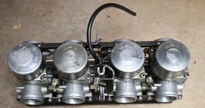

    Been trying to locate a decent photo and I think this eBay auction shows the crossovers as well as anything I've found.
    https://www.ebay.com/itm/3352301865...MIiKzj_tTWhgMV8UtHAR18igvnEAQYASABEgJjjfD_BwE
    They're all vapor blasted and super clean so this might help

    They appear to be fuel inlets ports as they enter those center 2 carbs at the same height as the crossover tubes coming out the other sides of the carb bodies to feed the outside carbs. A few pictures I looked at it looked like the early CB750 must have split the fuel line coming off the petcock into 2 fuel lines. My CB400F, that's where it has a T fitting and uses a single fuel line. I couldn't recall your year so just looked to try and find a clear pic that might be useful. Those are off a 1976.

    Thanks. Mines a 1981 CB750k. I have one main fuel line from the petcock between the first and 2nd carb.
    From this photo I found there is a T there and also to the right is where my main fuel line is(yellow square). I feel this is where it was leaking. But I still don't know if this is an overflow line?

    If that is the main fuel line coming from the tank there will be O-rings on each side to seal that T fitting to the carb bodies. They can flatten out over time and no longer seal or split and obviously no longer seal. One thing you can try is if you can get close to it is take some baby powder and put on both sides and then open the fuel petcock and you should see where it gets wet

    That being said, work through the PDF I linked the other day, see where the individual pieces are and maybe that'll help you get everything sorted back in place. I'm with Chuck in thinking that it would be an o-ring on your main fuel inlet. Any overflow would be at the bowls themselves.
