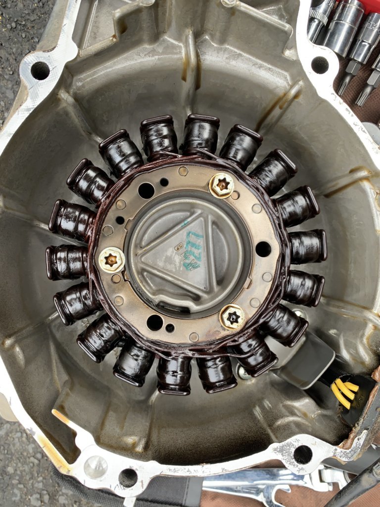

    Based on my experience with my S1K going through the same thing about a year and a half ago, I'm gonna guess you'll need both a new stator and battery, along with a new rectifier. Hopefully not all 3 but that's what I had to replace. Glad you made it through unscathed though, that's scary for it to go out mid turn lol. When mine went, it shut off on the offramp just before I got to work, and once more as I was pulling into work. Got it to start once or twice more when I was about to head home but it wouldn't stay on, so I had to tow it back. Thankfully I have AAA
    this is what my old one looked like after being pulled lol

    Even if it's just the battery, next time I do the stator I will probably do the RR anyway too. I've heard going from the stock shunt to a series RR helps keep them alive longer. If I really cared, I'd change to the vented flywheel, too. Apparently they don't get enough oil to stay cool in this engine design and cook themselves to death.
    Edit: I'm really thinking it's just the battery, though. The way it's dying super suddenly makes me think the BMS on it is starting to go and instantly cutting voltage to everything, rather than a slow drop in voltage like I'd expect. It has that "Re-Start" system and I think it's that that is acting up. Idk, more to come after I have a chance to dig into it.

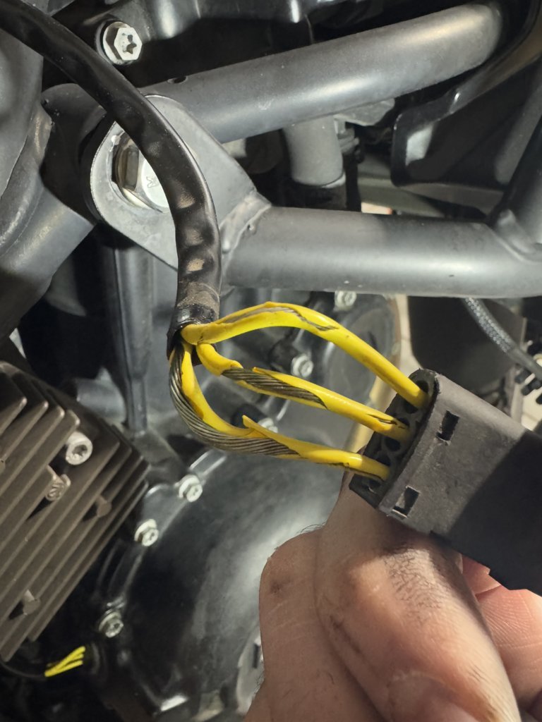

    Well this isn't what I expected..
    Resistances metered out fine, but uh, zero voltage when running. Wonder why. Going to order up the stator and the gasket, and pray the R/R was spared. Battery was sitting at 13.1, charged up fine to 13.3 and held, so I think the BMS was actually protecting it when it was shutting down like it should have!
    Ugh.

    YUP... would of NEVER guessed insulation on wires doing that.... wtf!

    Right? Real weird. Never had insulation shit the bed so hard like that before. I have a few theories, but it'll all have to wait until I get a new stator in hand and can test the RR afterwards. I'm wondering if my summer blast across washington in 100 degree heat for 7 or 8 hours just cooked it hard, and now with the weather getting cold and dry it cracked apart. Either that, or did the RR go bad and just try to suck all the freaking current it could out of the stator and fry wires that way. Or did the stator ground and just heat everything up. Idk. We'll find out in a couple weeks.

    Its not black or discolored in any fashion that I would expect with a burned wire. Looks like it just cracked/rubbed through maybe

    Exactly what I was thinking.
