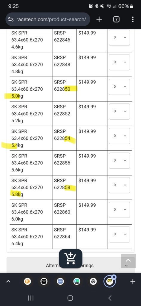

    What are you trying to get info for?

    Changing my springs for my weight and gear. Dual sport riding,.

    I used their recommended rate on my drz. Id just put the info in their calculator and buy the recommendation. Finally set sag appropriately

    I was trying to figure out what all the numbers meant lol Ill probably just call them.

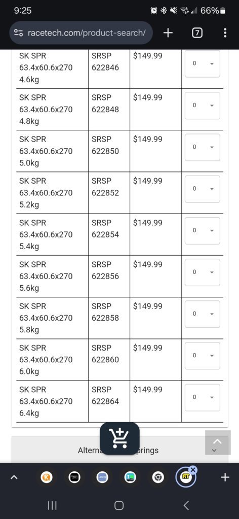

    These numbers?
    AAxBBxCC?
    AA and BB are typically ID of the spring. Idk if kawasaki uses some spring that is different or something. I wouldnt really get hung up on that
    AAxBBxlength

    Yep thanks, it was reccomending something not on website. Ill have to call them lol. Like a 7.2 kg spring lol

    Post up what they say. A guy on another forum needed a heavier rear spring as well. Got with Race Tech, and they sent him a spring from Eibach. I didn’t find out what the poundage was, but think (pretty sure) the last two of the part number is the weight in kilograms (freakin metric system). See highlighted pic borrowed from @Sacrifice
    That said, Eibach’s site appears to follow suit, minus the last number.
    I punched in rough numbers for me.
    https://eibach.com/moto-search?year=2023&make=Kawasaki&model=KLX300.
    I have been meaning to call both to find out more info, but have yet to.
    Back to the spring itself.. if it is measured anything like spring weight (aftermarket) on vehicles, cool deal. The varried set weight Lbs per compressed inch. But instead.. in kilograms per millimeters. On the mm side, I do not know they compress too with out googling it.
