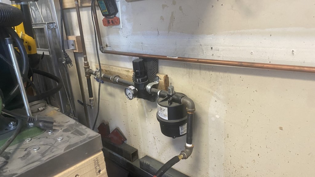

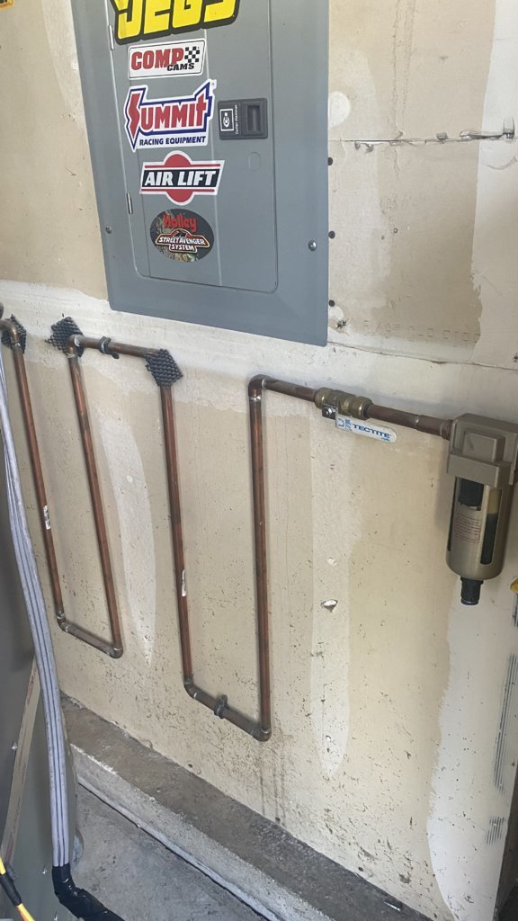

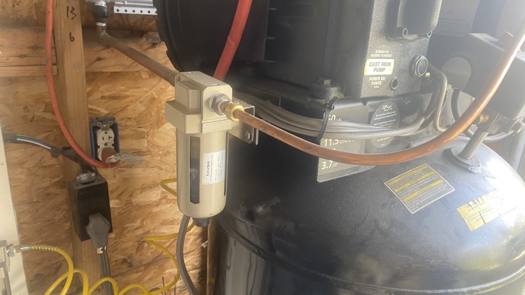

    Another thing you will need is a water trap. You don’t want moisture getting into the blast media.
    I have a copper line coming from the compressor into a radiator to help cool the air, then into a water separator then into the tank. Out of the tank it goes into a long U shape piping with a water trap at the bottom of each pipe. Then into the the hose reel. That is just for the air that I use for tools and such. Then I have another section that I can unplug the hose reel and plug a flex line into that runs 10+feet first through a water separator into copper pipe that is in u shaped then travels to another water trap. Then into a pressure regulator into a water filter. I use this for sand blasting, paint gun and powder gun. Also when I am blasting my 60 gal compressor runs the entire time.
    IMG_5291.jpg IMG_5290.jpg IMG_5292.jpg IMG_5293.jpg IMG_5294.jpg IMG_5295.jpg IMG_5287.jpg

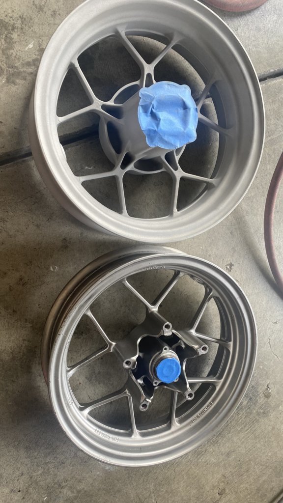

    Got one monkey wheel blasted. Took an hour so now I am taking a break and letting the compressor cool down and getting something to eat. I will go back out and blast the other when I am done. Here are pics of progress between on that’s blasted and not blasted.

    The setup i bought has a moisture trap on it. For $90 im content. It did what i needed to just sucks the media cant be recovered cause its all over the yard, haha

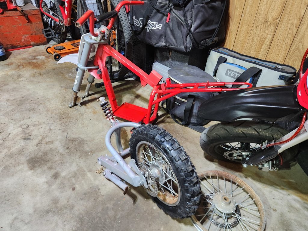

    Blasted the rust off and welded up a crack and some support where the frame had been bent somehow. Spray painted and then mounted a new tire on the rear wheel. Ordered a new tire for the front and then ill list it on fb. Dont mind spending the stuff on the tools because i needed them for the truck anyways.
    Hopefully get $200 out of it. Bought it for $75.

    Oh for some reason I thought you had a cabinet. Ya that can get expensive if you are doing it outside often.

    Got both wheels done. Also the rear fender, exhaust shield, handle bar risers and front turn signal mounts blasted. That was about 4 hrs total of blast time. Lots of labor just getting parts ready. Still have another 4hrs worth of blasting left. Then the fun part.

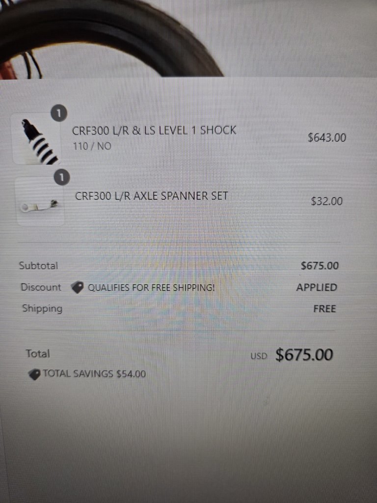

    Ordered my Rally Raid rear shock
