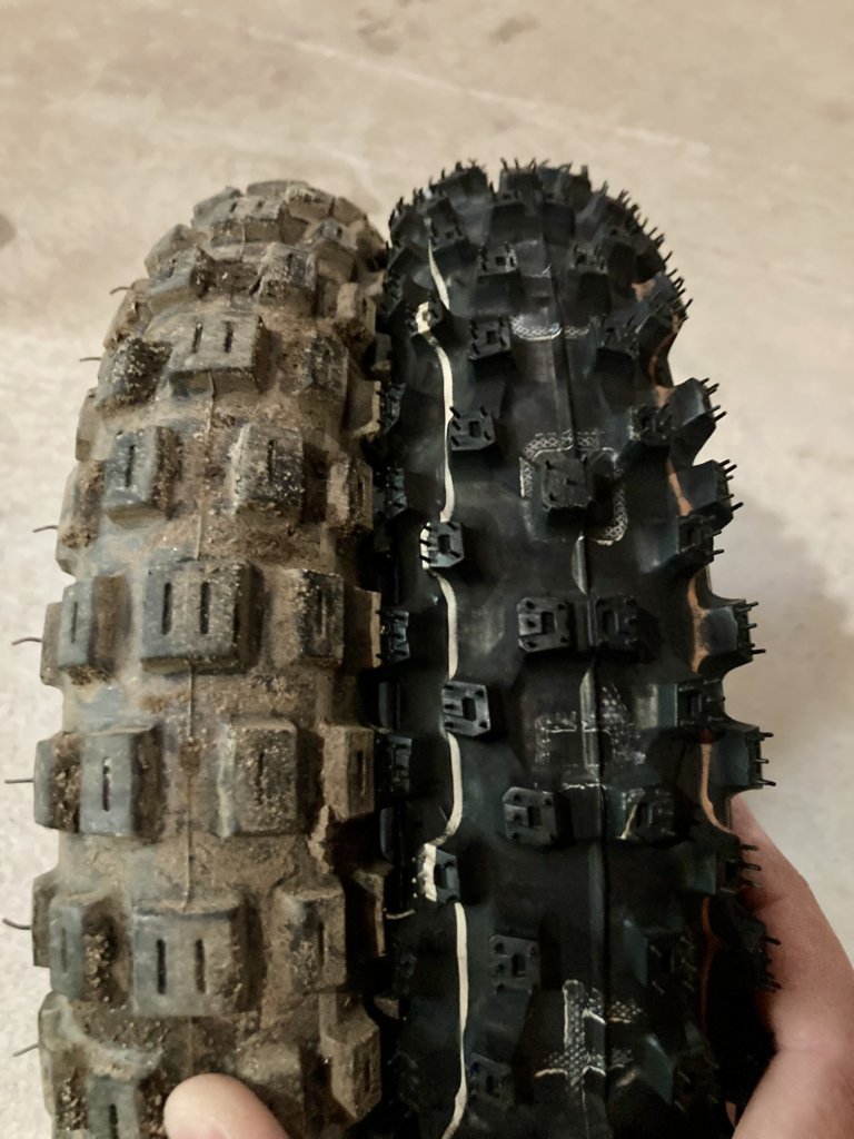

    Easy compared to a Grom tire!

    dunlops? great tire, huge upgrade over the stock pw50 tire :thumbsup:

    Yep, Geomax MX53. Going to run a MX34 on the back flipped backwards

    Smaller tires are always more difficult.
    I'm getting ready to put my dirt tires back on my WR, its nice having a road bike finally. Tires offroad make a massive difference.

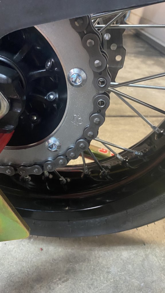

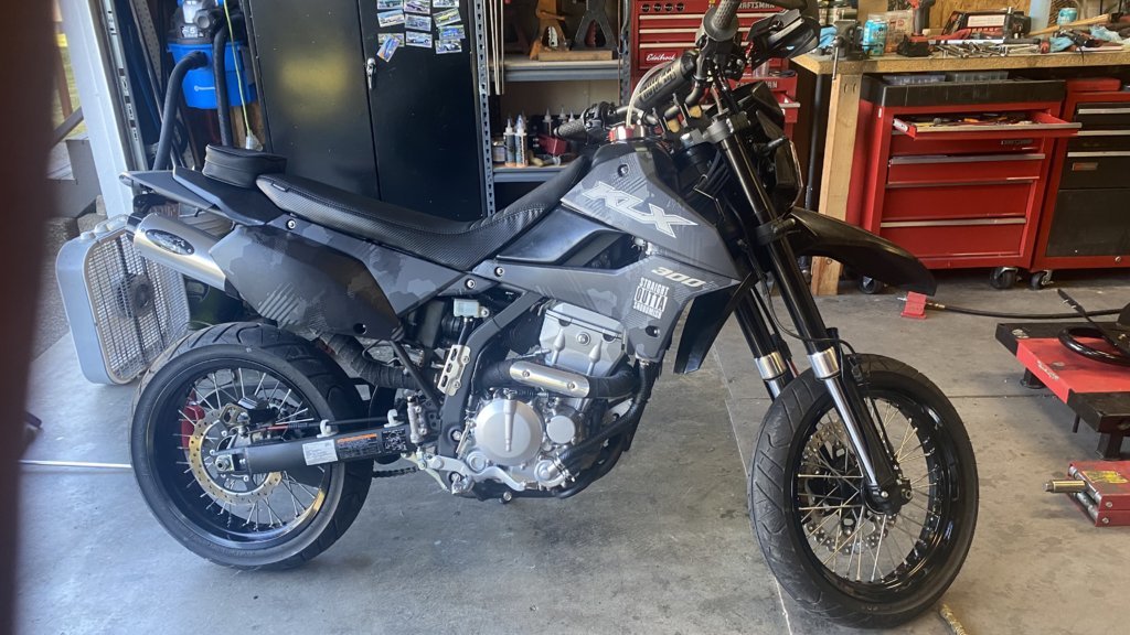

    Well the DS to SM swap is completed. Got his bike done in about 2 1/2 hours. Had to do a bit of modification to the side stand but nothing too hard. Then they left and I worked on mine. Got mine put together in about an hour and a half. I ran into one snag that won’t let me ride yet. The DS has a longer chain compared to the SM because of the rear sprocket size. His bike fit and had just enough to fit and get good chain slack. Mine on the other hand is too long. Pulled all the way back it is still not close to tight. So I can either order a new chain that can be here tomorrow or a master link and brake my chain down a couple links. I will make that decision in an hour or so. I need a shower. lol
    Anyway here is a pic. I love the way it looks and can’t wait to ride it.

    New chain.
    What size are those wheels? Tires look tiny on them

    Looking good!
    We all know what you’re going to do!
    Or… you could get bigger sprocket and wheelie machine!

    The gearing is good for the power upgrades I have. It’s real close to what I had.
    I order a new master link. The chain is still good and only needs a couple links removed. $15 vs $100.

    Throwing this out there.. the DS has 106 links. and the SM has 104 links, per the book. This may save you some time.

    Yes knew that information . I was just hoping the 106 would work but obviously didn’t.

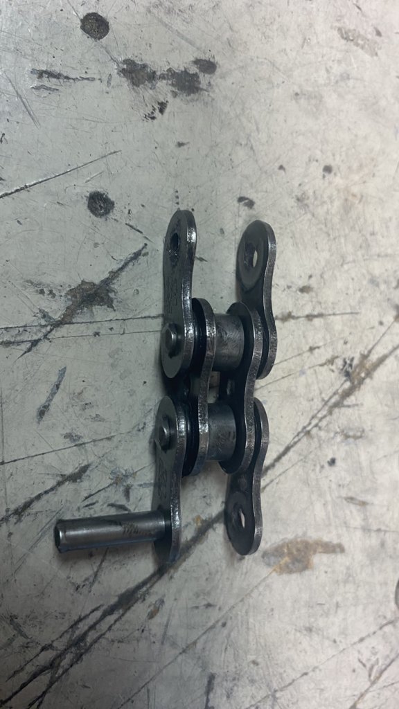

    Chain broke and ready for master link that will be here in the AM. Easy work with the motion pro tool.
