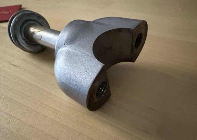

    Had 2 buddies point out I had a loose clamp bolt on my bar, found out the threads were damaged.
    It's amazing how something so small can cause your riding season to get disrupted.
    Working on sourcing a new one, but for now I think I'm gonna fix the threads deeper in the bracket and use longer bolts.

    Helicoils are cheap

    It would touch the bar it’s too close, I’ll still consider it once I’m at work on Monday and see how it looks but it’s not ideal

    You could always drill all the way through and put a nut on the back

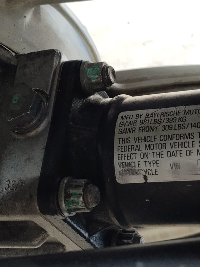

    BMW r65ls driveshaft filler bolt stripped the final drive aluminum so dealing with that. IMG_20250607_095651070.jpg bolt on the left.
    Going from a M12 to an M14 drilling out and re-taping. Now that's because I need to remove to replace the gear oil so that's why no heli-coil. If I were to use anything it would be a Time Sert, they are ment to expand during insertion. New tap $12.00 drill bit $7.00 new bolt $ 12.00.
    For what's it worth you might just need to re-tap/repair the threads.
