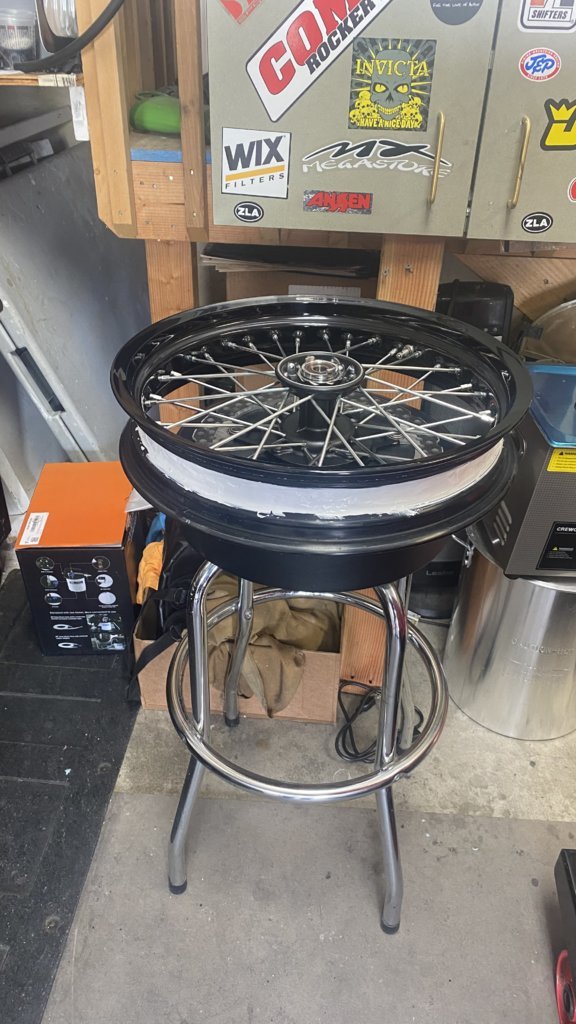

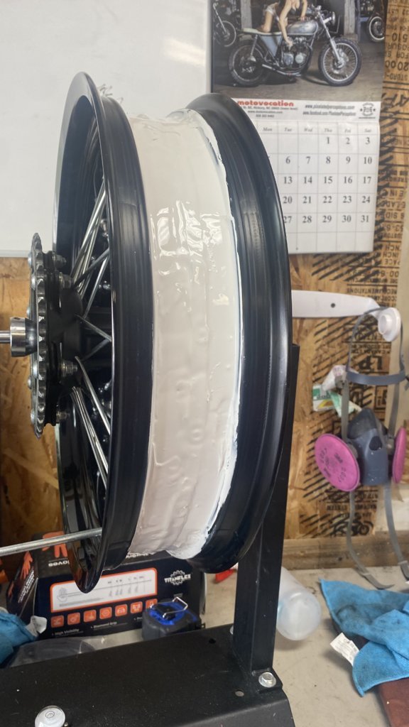

    Sealant is done. First I hit all the nipples and make sure they are covered. Then I apply a top coat with a putty knife. Doesn’t have to be pretty. Now just let it cure.
    Also tighten any loose sounding spokes. This is NOT the fast cure so it can take up to 7 days to fully cure. I read if you keep it misted with water it will help it cure faster. Not a big deal because I will be riding the Harley next week when my friend shows up.

    Wouldnt you want to cover up the spoke nipples so they dont get sealant in them?

    Probably. There are a bunch of different ways to seal them and this is the way I chose. Is it the right way? I doubt it but it should work. It worked on the Harley wheel I did and also the DNA front wheel I have on the Harley was done this way. It just needs to hold air. I am sure if the spokes ever need to be adjusted I will have a problem.?? IDK They have a tape kit but it would have cost over 100 bucks to do both wheels. I went cheap.
