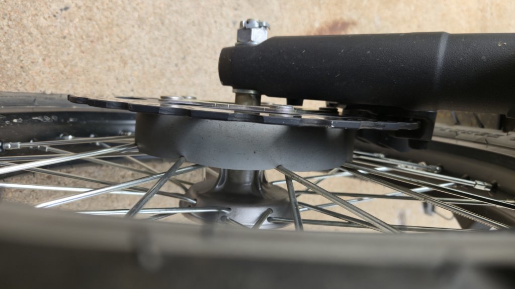

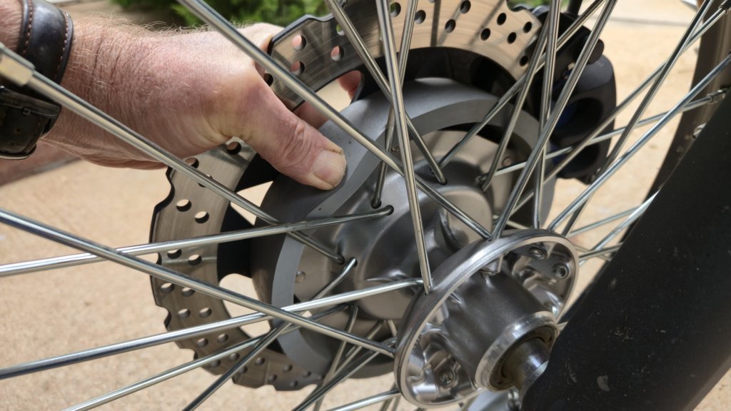

    Yes, but for what reason? I noticed it the day I brought it home, and after googling, decided to leave it until more info was available.
    It's not even pictured in the service manual...

    And it's far from being centered, prolly not enough weight being so close to the hub to throw it out of balance. But being wedged against the spokes, that doesn't seem right.

    Not being in the service manual makes me think it might be even more important. Was probably added to address some weird vibration that bothered folks, but wasn't found out until after release. Prolly one of those things most people wouldn't even notice though. I read so many people complaining about the vibration on my bike, i've only noticed it in a very limited RPM range, and it's NOTHING compared to the old ATVs i'd ride where your feet and legs were numb by the time you got off, lol.

    I'm going to bet it's some BS safety thing that was their fix cus one person had a problem, or a noise thing cus someone complained of pinging spokes.
    Get rid of it.

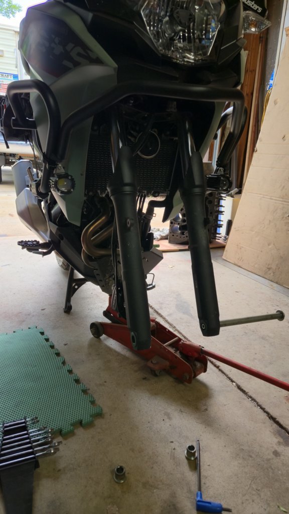

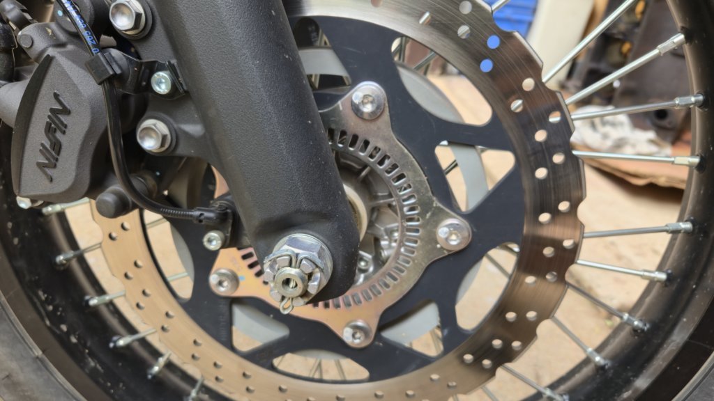

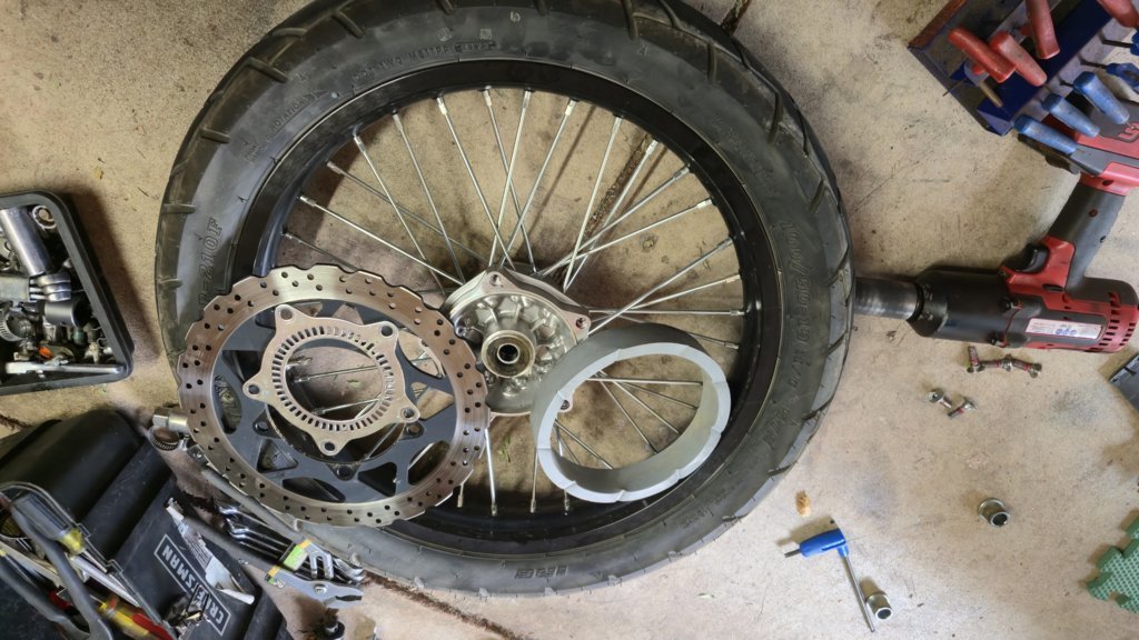

    Let's call this a learning moment, or getting to know the bike. Really was quite simple to remove.
    Just need to find the proper torque specs for the brake rotor and I'll send it.
    Now I know what it takes to get the front wheel off for a tube patch...

    20 ft-lb is awfully light, but that's where it's at, with Loctite.

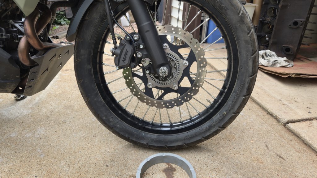

    I noticed no difference at all. Brakes don't pulsate, no weird noises, front wheel didn't fall off. Took it around the reservoir where there are a few steep downhill areas so I could ride the front brake, worked like it did before. I think it was meant for shipping. :notsure:

    High end sport bikes have floating rotors, meaning they jingle and have a fair bit of movement. I'm sure it's just a shipping thing, until you have a warranty claim and they lost their mind over a missing foam donut

    Supposedly it’s for possible brake rotor squeal. I would guess that it has happened enough that, that was the fix for it.

    It self aligns within the pads a bit better. Kinda like axial vs radial mounted calipers (but i think thats more beneficial)
