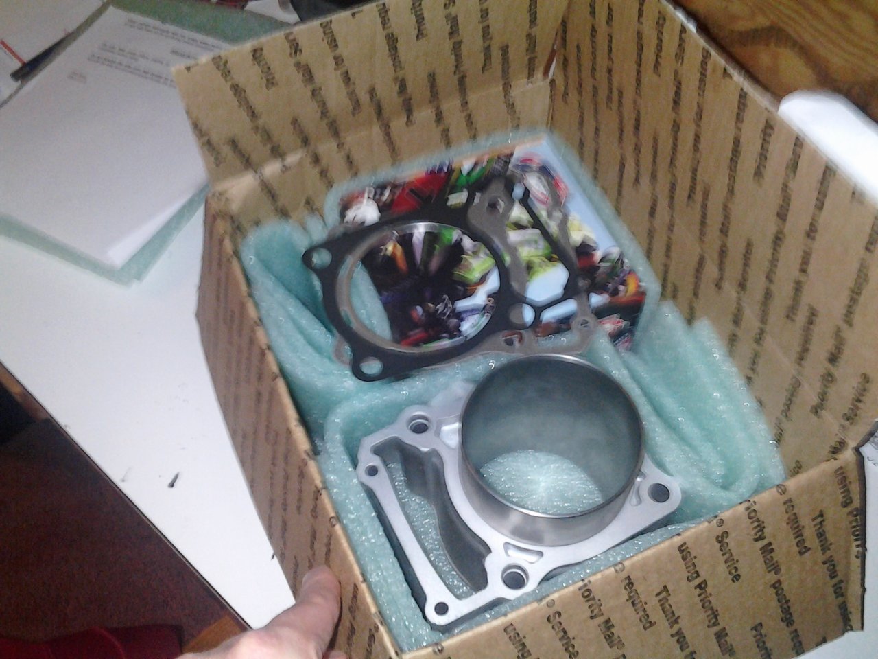

  13. Nov 16, 2017 at 4:00 AM
    #6593
    Stockmonester
    Stockmonester Well-Known Member
    Aug 26, 2010
    #42256
    1,391
    Nick
    Rome, Ny
    2019 v6 sr 4x4
    in channel vent visors
    This came in last night
    MadTaco461 and Sacrifice[OP] like this.
  14. Nov 16, 2017 at 4:25 AM
    #6594
    Sacrifice
    Sacrifice [OP] Motorcycle Goon
    Oct 8, 2013
    #114093
    15,198
    KS
    DCSB OR 4X4 LT
    Pelfreybilt Front Bumper,BAMF sliders, Airflow Snorkel,Mini D2S Retrofits, ADS Rear Shocks, Deaver U402 Leafsprings, 35s, AllPro +2LT
    check the deck surface to make sure its flat. i know cylinder works had some issues at some point, just saying that as a general precaution (no idea what brand yours is)
    AR15xAR10 likes this.
  15. Nov 16, 2017 at 4:44 AM
    #6595
    Stockmonester
    Aug 26, 2010
    #42256
    1,391
    Nick
    Rome, Ny
    2019 v6 sr 4x4
    B&B 351 kit, dropping it off to the shop tomorrow to get put in and tuned
