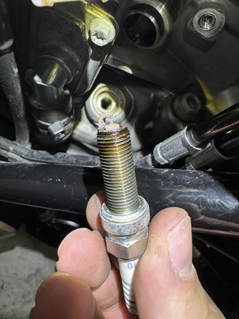

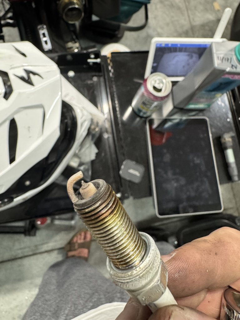

    600ml down on a moto cooling system is A LOT to just vanish. Is the spark plug easy to get to on the 701's? if so you could pop it out and have a look down into the cylinder to see if its been vapor washed by coolant?

    About 600ml, so it'd raise it from bottom of the sight glass to middle of the sight glass, which is about what I'm seeing. I don't know how much oil it's burned, though, smacking myself for not checking it more often.
    I didn't get a look down the cylinder, but pulled both plugs last night.
    Inner:
    Outer:
    Both look gunky, but fine. Not what I'd expect to see if it was a head gasket. I'd be expecting to see the porcelain bright white and less gunk, more clean. I'm assuming these are the original plugs with about 11,000 miles on them and up until a couple months ago the PC6 had a rich AF tune on it meant for a different exhaust.
    I think the plan is to buy the water pump kit, coolant, two sets of filters, and enough oil to do two flush changes to try and get all the coolant out of the oiling system and cross my fingers from there.

    Yeah those plugs dont look like they have been seeing coolant. Solid plan to change water pump seals and do a good oil flush.

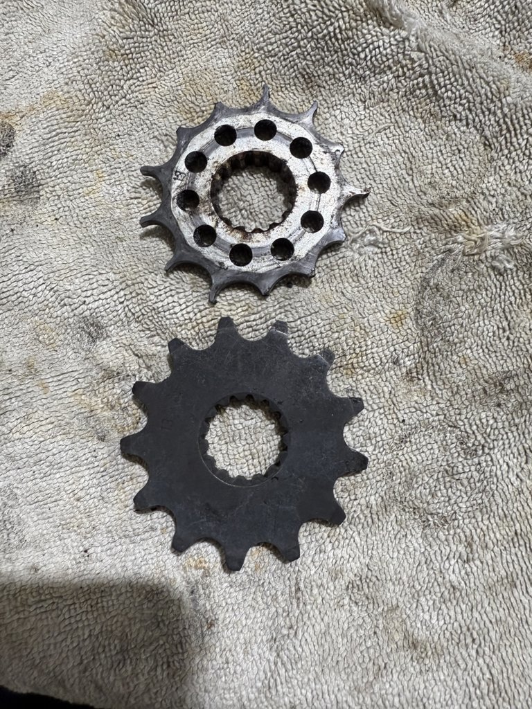

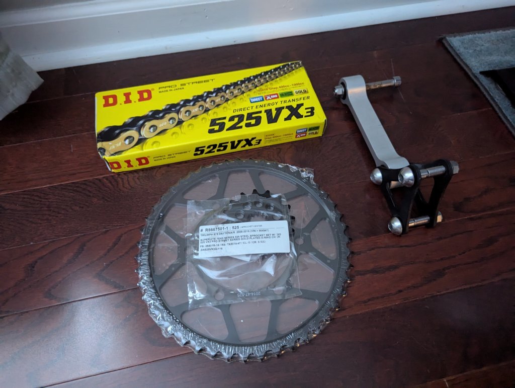

    Well no side stand today. Looks like tomorrow but I did receive the chain and sprockets. The parts pile has began to develop in my home office :thumbsup:
