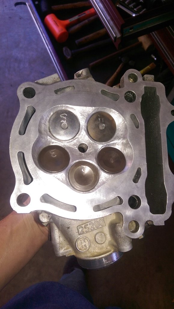

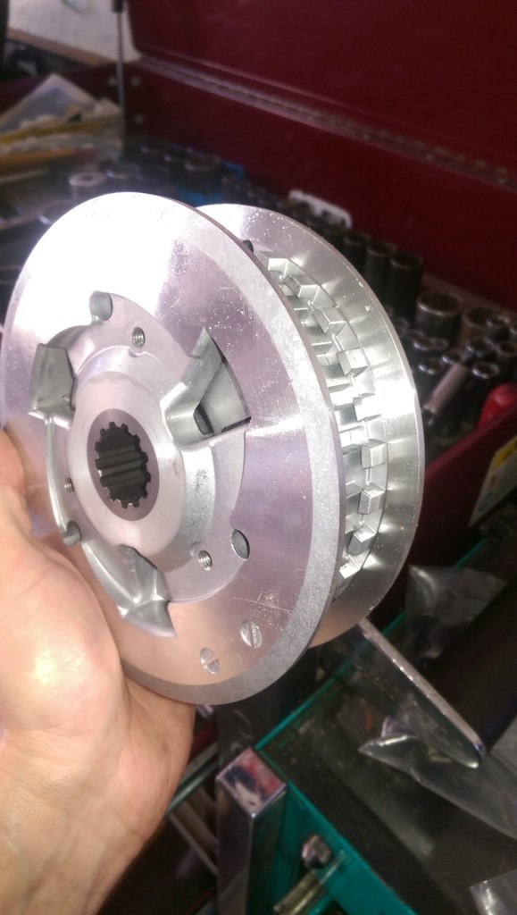

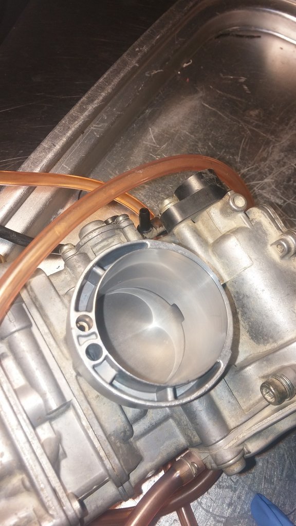

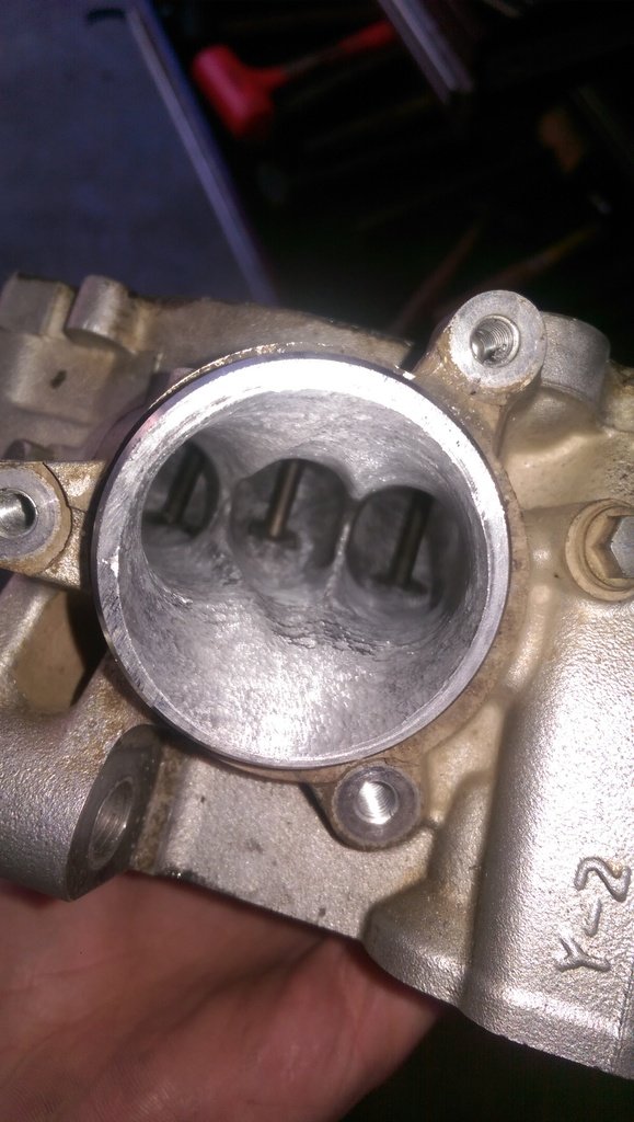

    The 48.80 run it was mostly stock- with the exception of free mods, re-jet, a pro circuit slip on and 2006 yz450 cams.
    Mods this last run were - 13.5:1 piston, carb bored from 39 mm to 44mm, venom ported head, 4239 intake hot cam, 06 yz450 exhaust cam, fmf mega bomb header and a mototasinarri air boot.
    "Other" mods that didnt effect dyno #'s much were: a carillo rod, r&d power bowl 2, a hybrid wr/yz transmission swap (1-2-3 gears are yz spec, 4-5 wr spec), an oem slipper clutch from a 2015 yfz450r atv, brembo radial master cylinder, braking supermoto front caliper, galfer stainless steel brake line and vesrah pads
