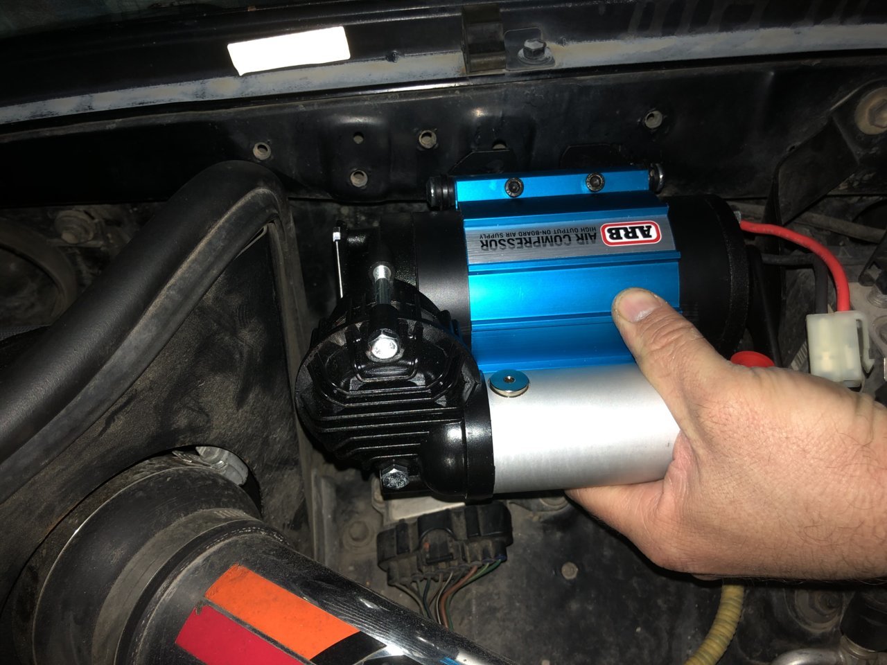

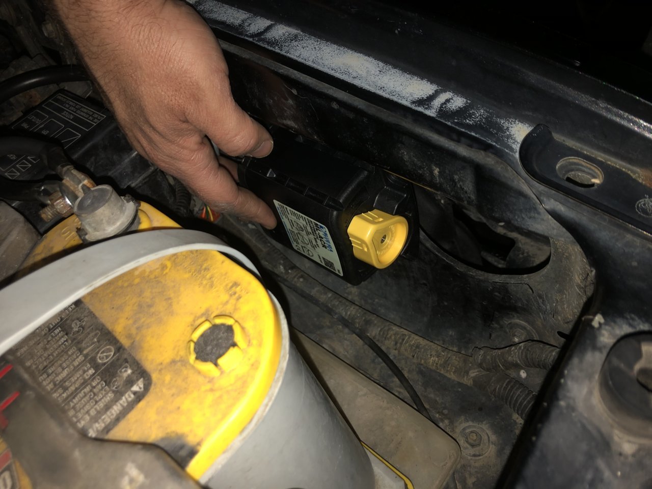

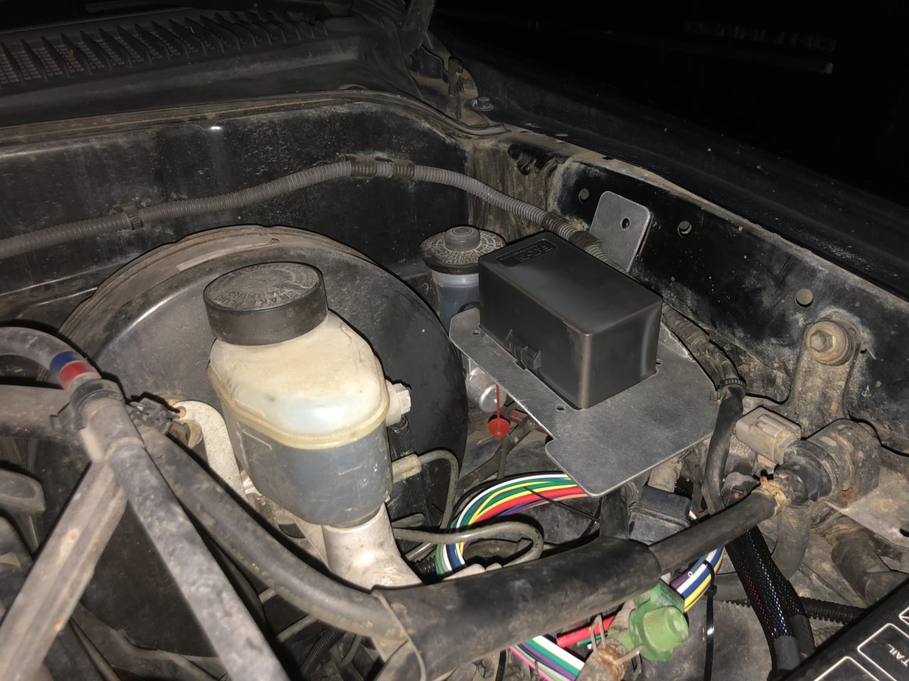

    2003 Tacoma, V6, 5 speed, 4x4.
    Fox 2.0 Coilovers in the front and Fox 2.0’s in the rear, Total Chaos UCA’s, Al-lpro expo leafs, K&N cold air intake, TRD headers,Magnaflow catback exhaust,URD short throw shifter, switched out my 60/40 bench seat for some Tacoma Limited seats, Replaced the vinyl shift boot for a leather one, completely soundproofed the cab w/ Frost King. Replaced stock radio with a Pioneer AVH series head unit. Focal component system w/a 10" sub powered by 2 Alpine amps. Weathertech floor mats. Line-X'd the bed. SCS Ray 10’s, Installed an A.R.E. MX series camper shell. All-Pro Apex front bumper w/ All-Pro skid plates all the way back to the Trans. Low Range fuel skid plate.

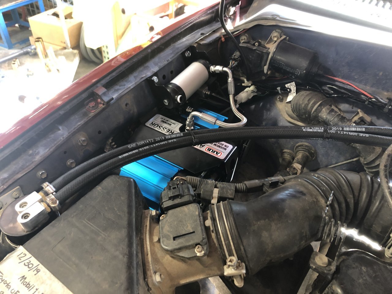

    here is where/how I mounted my twin compressor. Since the single is smaller is should be an easy fit if you don't have cruise control.
    I was meant to be temporary but I haven't found a better spot for it yet. The unistrut is welded to a 3/16 bracket with a piece of ? Gauge sheet metal that the compressor is bolted to. There is a rubber bushing under the bracket to reduce vibration against the inner fender.

    I did the same place as @Wulf but just bolted it right to the fender. two of the holes were already there and I had to drill two more.
    Had to get rid of my cruise control though. I was alright with it considering the controls on my swapped steering wheel don't work with it anyways.
    It's a tight fit, but really the only place in the engine bay for that big unit

    What’s that cylinder you have attached to it?

    Filter?

    It's a manifold with multiple fittings so you can put your ARB solenoids on it since the compressor only has one outlet. Mine has my front ARB solenoid and an air hose quick disconnect in it

    Yea what @Wulf said. for my ARB lockers. The regular smaller ARB compressor has that manifold built in.

    My charcoal canister is in front of the battery where you have your bussman. Wish I could ditch that thing. damn emissions.
