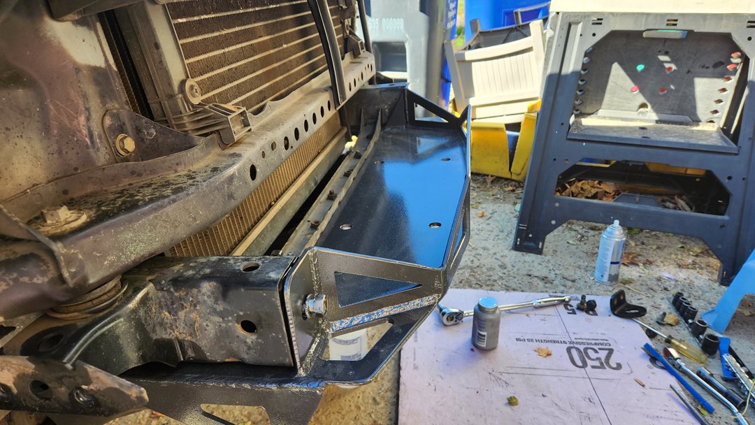

    I have a '98, and the AMP'd up mount.
    here's how it attaches to the frame ends, plus the lower bumper mounts.
    Depending on the winch, whether you remote locate the controller, you may have more or less to cut on the bumper assembly. I would do things a bit different if I were to get a replacement bumper. I am running the more expensive Badlands winch with synthetic rope and did not relocate the controller assembly.
    I originally cut more of the lower bumper than I needed, so I fab'd up a piece of HDPE and use a hinge to mount the license plate, which allows access to the free/spool lever.
    THatt and DenverMoto[OP] like this.
