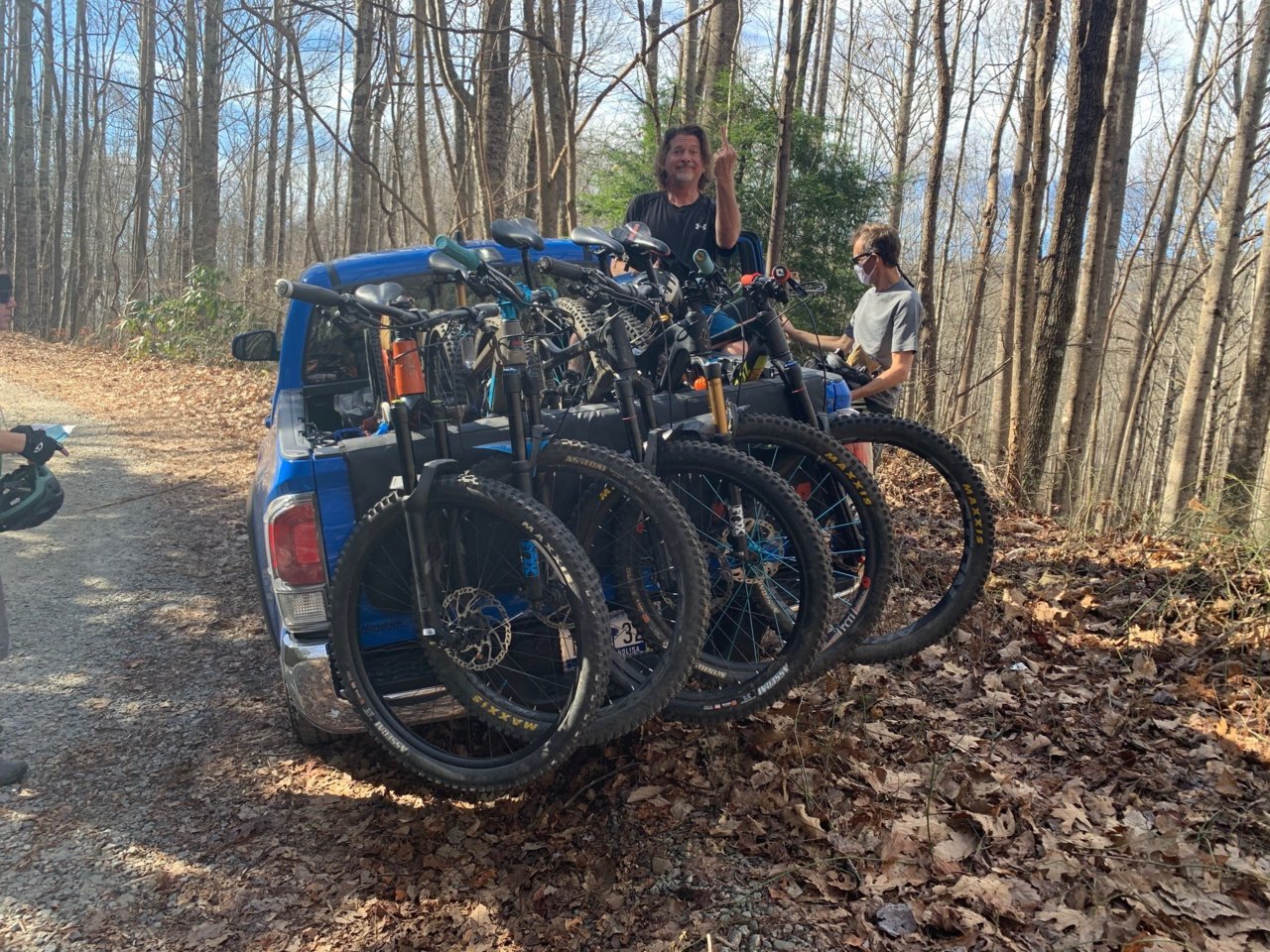

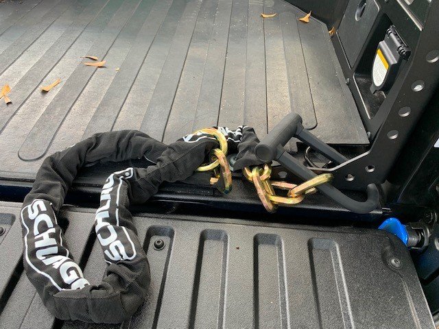

    I use a tailgate pad - ended up with the Yakima one - holds 5 bikes securely. They don't budge, even bouncing for miles up fire roads.
    For security, I added bed stiffeners and lock the bikes to it with hardened chain and a U-lock. It would take a pretty good amount of time with a grinder or torch to get the bike free, so I don't worry about it when I hit up a restaurant or brewery after the ride. Still wouldn't leave it parked overnight, however, but that's just paranoid me.

    Wow I've never seen 5 bikes on a Taco before, you win the prize!

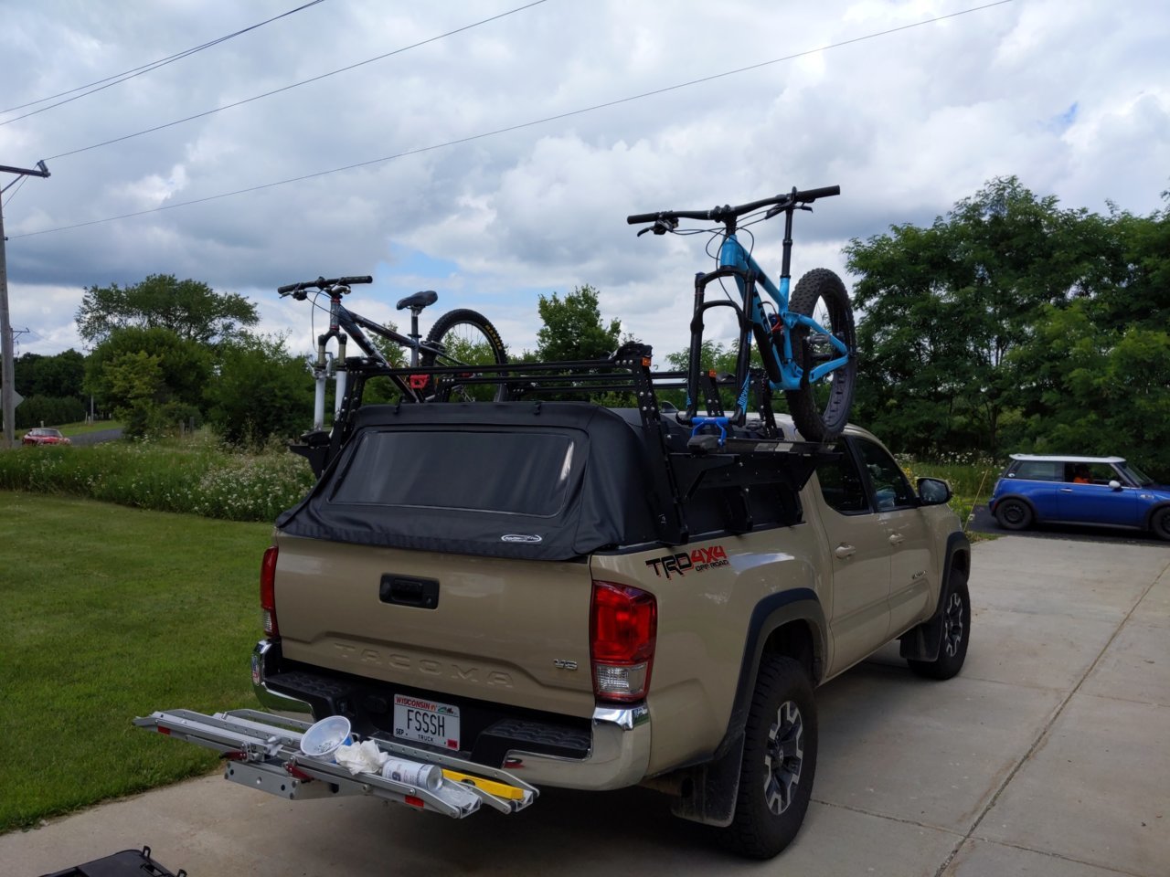

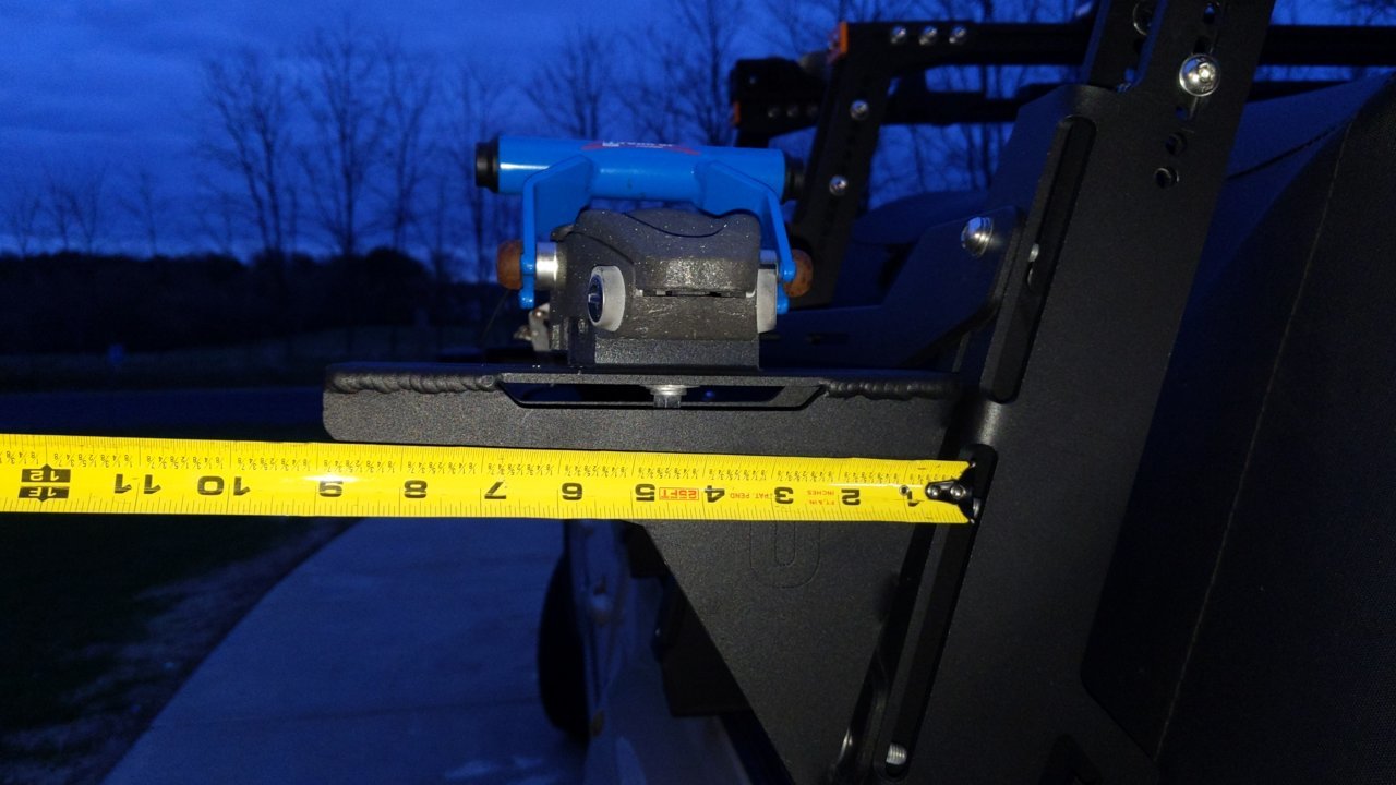

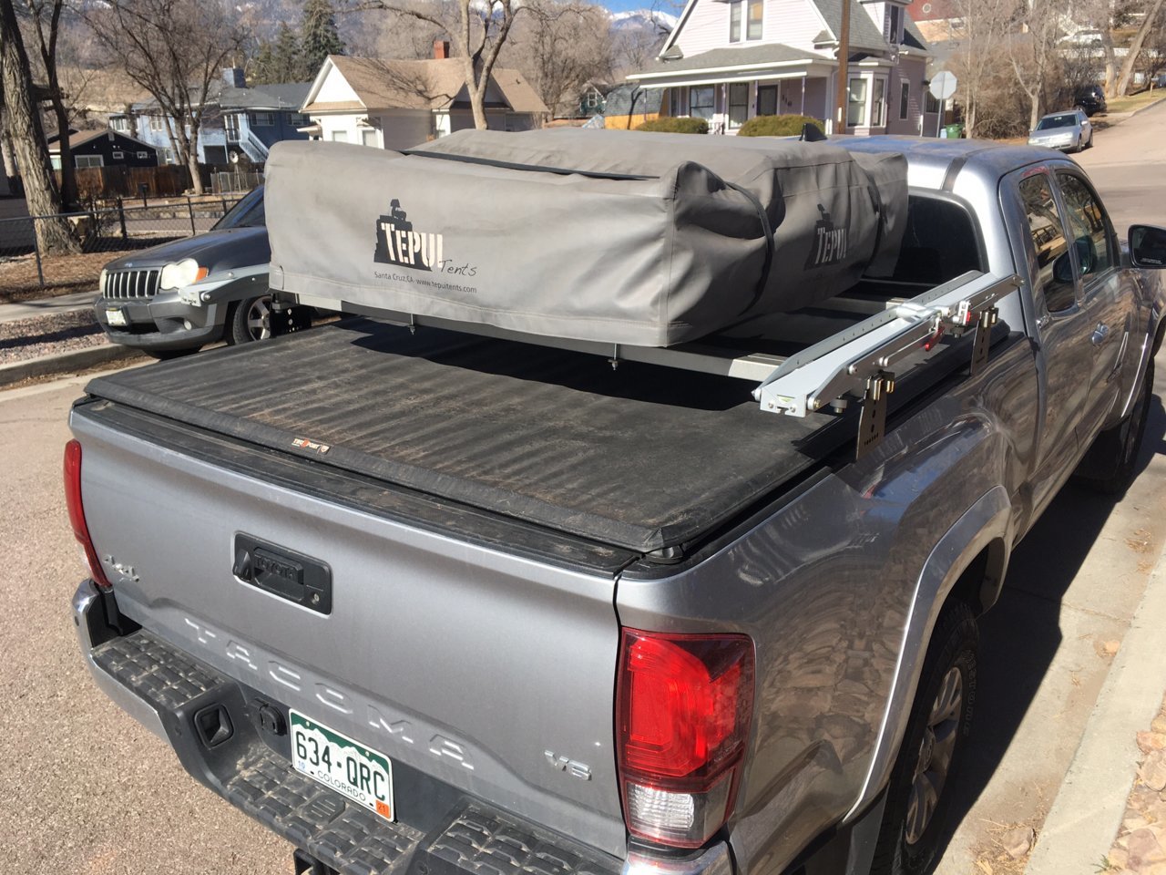

    How far do those mounts stick out on the side?
  7. Apr 15, 2021 at 5:44 PM
    #207
    Slideeslide
    Slideeslide Member
    Apr 2, 2018
    #249145
    23
    Maybe two inches outside of the wheel flare. 16185337931969114537607623783449.jpg

    A comment on security. Hard chain CUTS faster than "soft chain" when using a thin cut wheel on a die grinder. Anyone with a CO2 bottle on their belt (not uncommon in the building trades) can get that chain apart in less than 3 minutes with hardly a sound.
    But On topic, Nice bike carry!

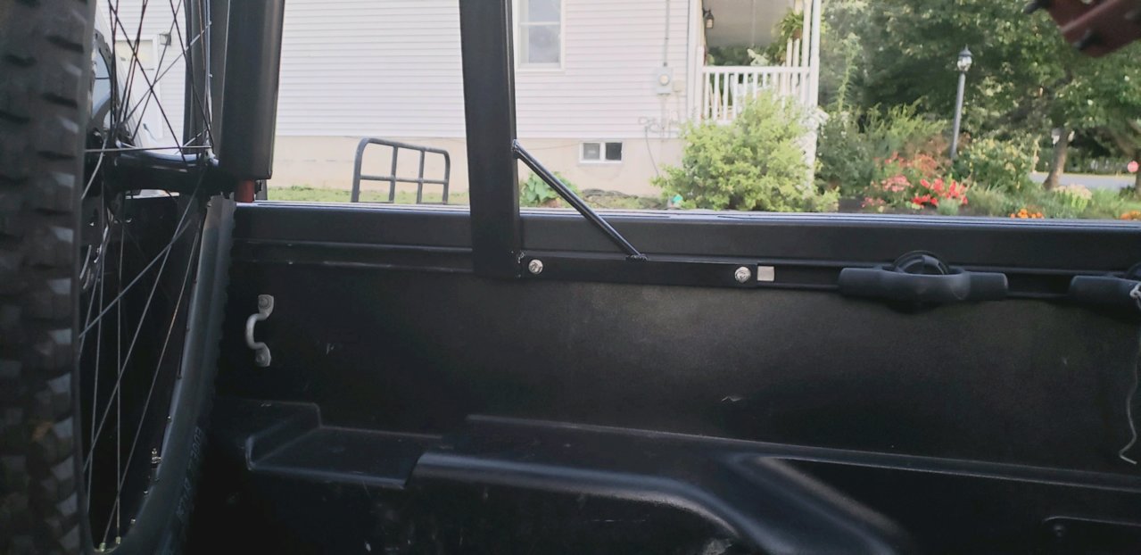

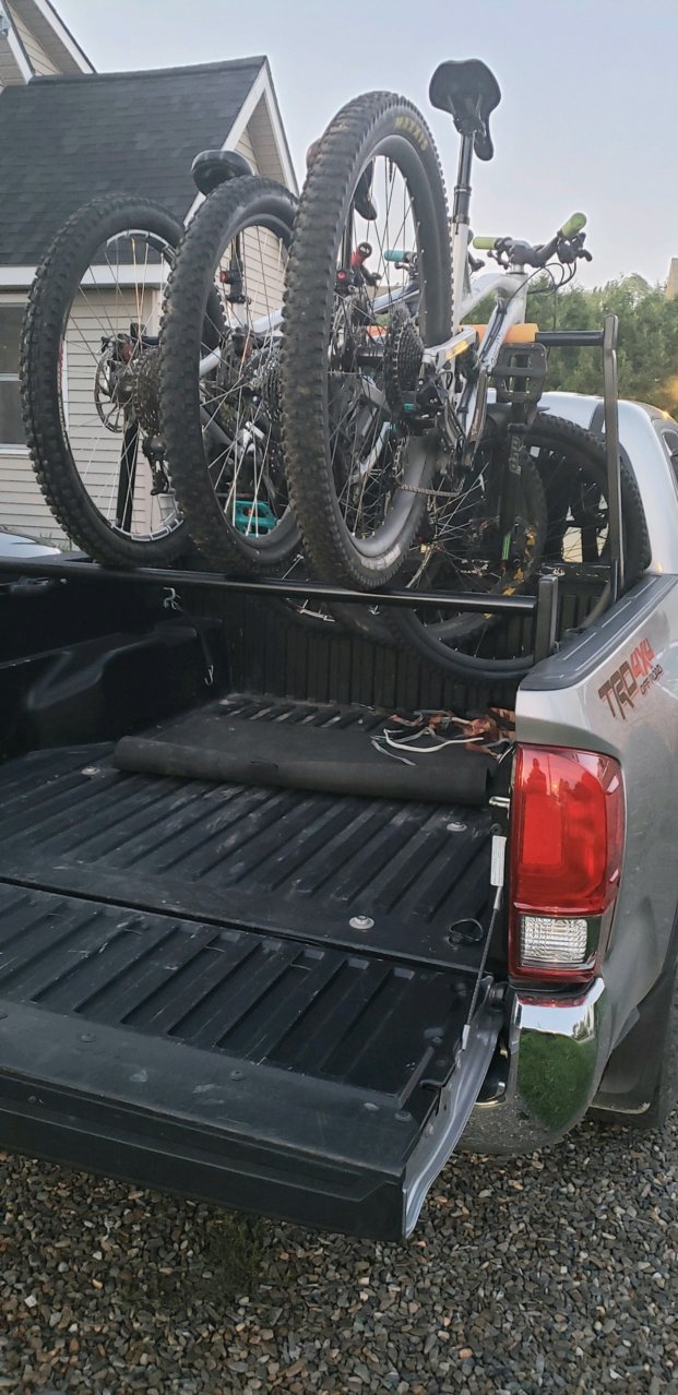

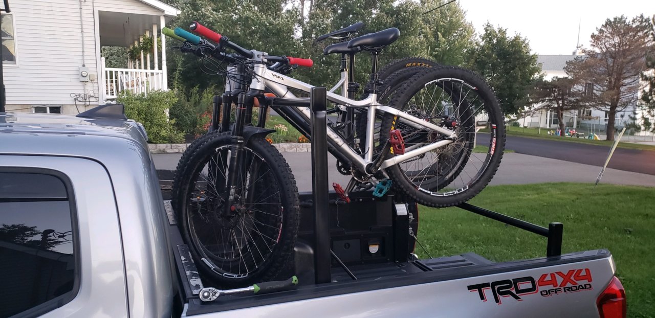

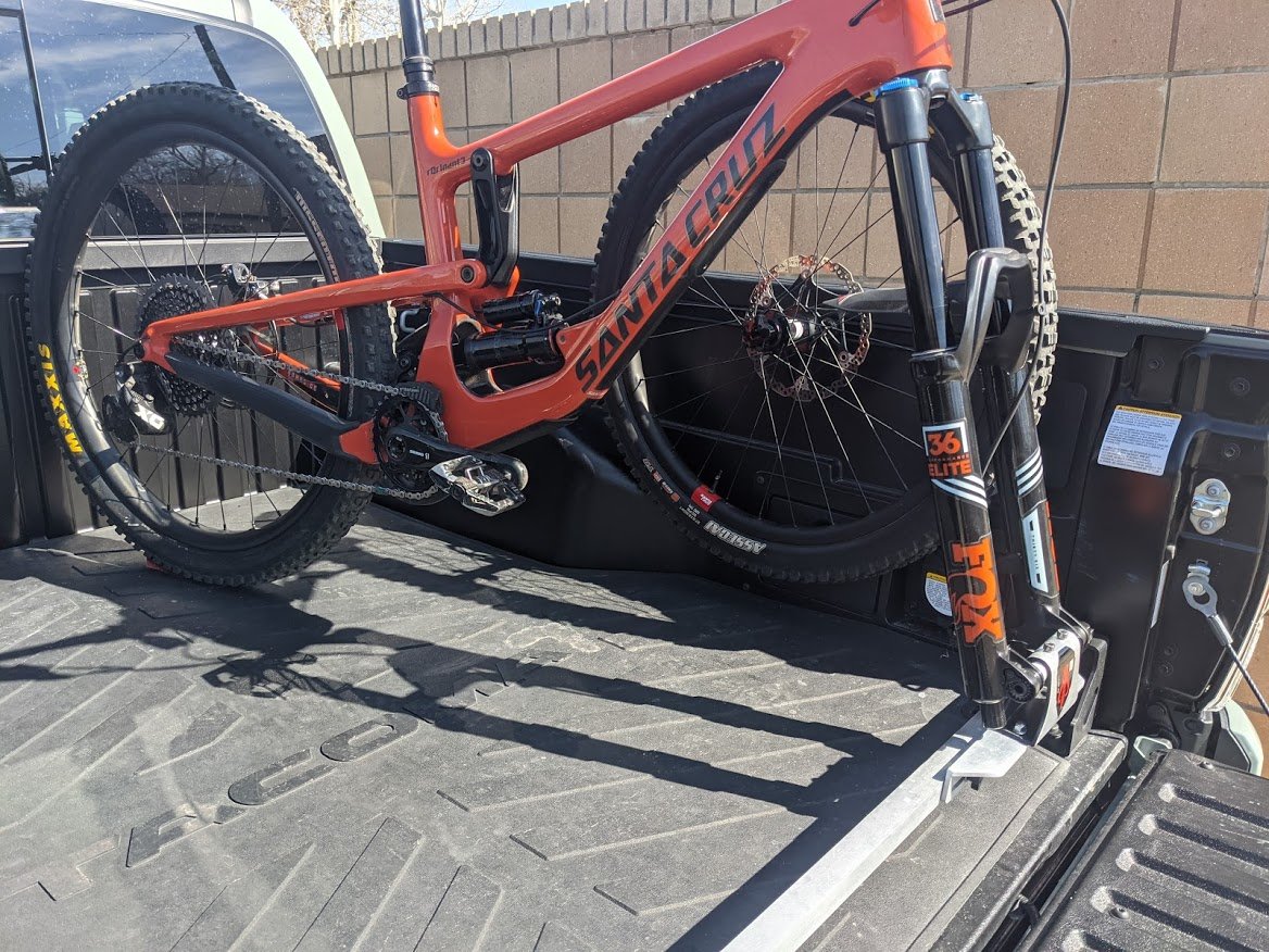

    So the whole thing is built with a set of "Mini Stiffy's" that a guy on here makes and sells. A bar of aluminum tube bolted to the top of the Mini Stiffy's so I can remove the whole ordeal to haul things, two scraps of aluminum angle, a handful of Riv-nuts and a set of Rocky Mounts.
    My buddy is also making and selling wheel mounts that attach to the bed rails.
    https://www.tacomaworld.com/threads/mtb-wheel-hauler-contest-name-this-thing.711725/
    tpOqwoP0l0JRcTo0aih_Gr6djaeiwQQ4n7_VW49p_23d88ceaaf3f7ea4ad12c59dfcd07dce4fa6195b.jpg

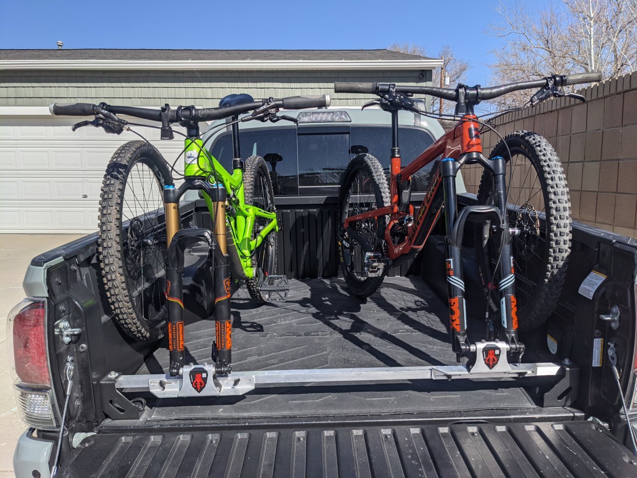

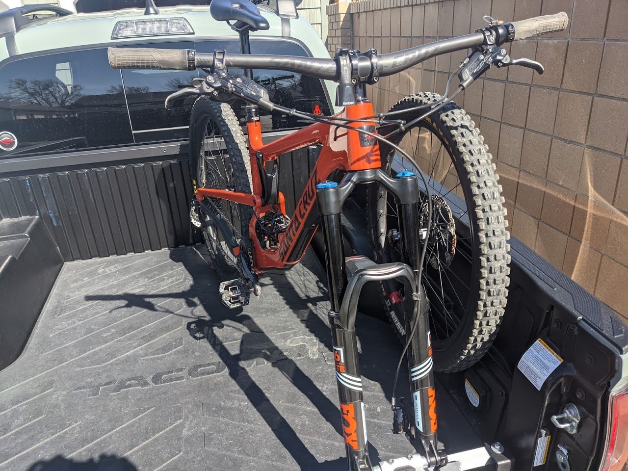

    What do you guesstimate your total cost of this was?
    This is such a clean way of hauling bikes!
  12. Apr 16, 2021 at 11:36 AM
    #212
    R4D4G4ST
    R4D4G4ST Well-Known Member
    Dec 12, 2020
    #349455
    809
    21 LR TRD PRO MT
    Maxxis Militia

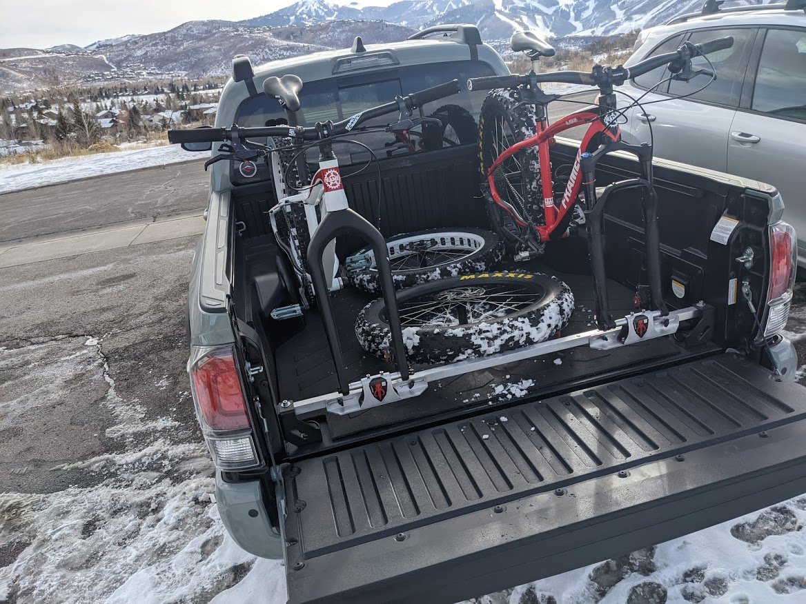

    The most expensive part was the Rocky Mounts, but I already had those, and I prefer them because they work with multiple hubs. I use this setup for Boost, non-boost and Fat Bikes.
    N5mggcHWDWAnK6zOmnGgnXhnHFR-0tyLDcCT4IWK_70c3721d02887a0511b0b588dc2a5cca1f826fe1.jpg
    The price was pretty inconsequential. I got fed up with dealing with tailgate pads, and the scratches that come with them (on the bike and the tailgate), and I got tired of climbing into the bed of the truck to mount the bikes
    But, from memory:
    Mini Stiffy: $50
    Aluminum Bar & Angle: >$20 (not sure as I used scrap's that were kicking around)
    Riv-Nuts: >$10
    Stainless Hardware: $20
    @TMCmakes Wheel Carrier: I helped develop, I don't know if he's set a price yet.
    dZTdBS0noBj9k6fkcwOwCRzKnsM0NNCAo-5BQpI__d0ffd403892fd828bb7bf88eaf87c34d2ac9686e.jpg

    I am loving this set up. No reaching over the side of the truck and trying to thread a through axle! I might have to work on something like this! Thanks for the idea!
