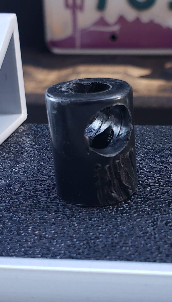

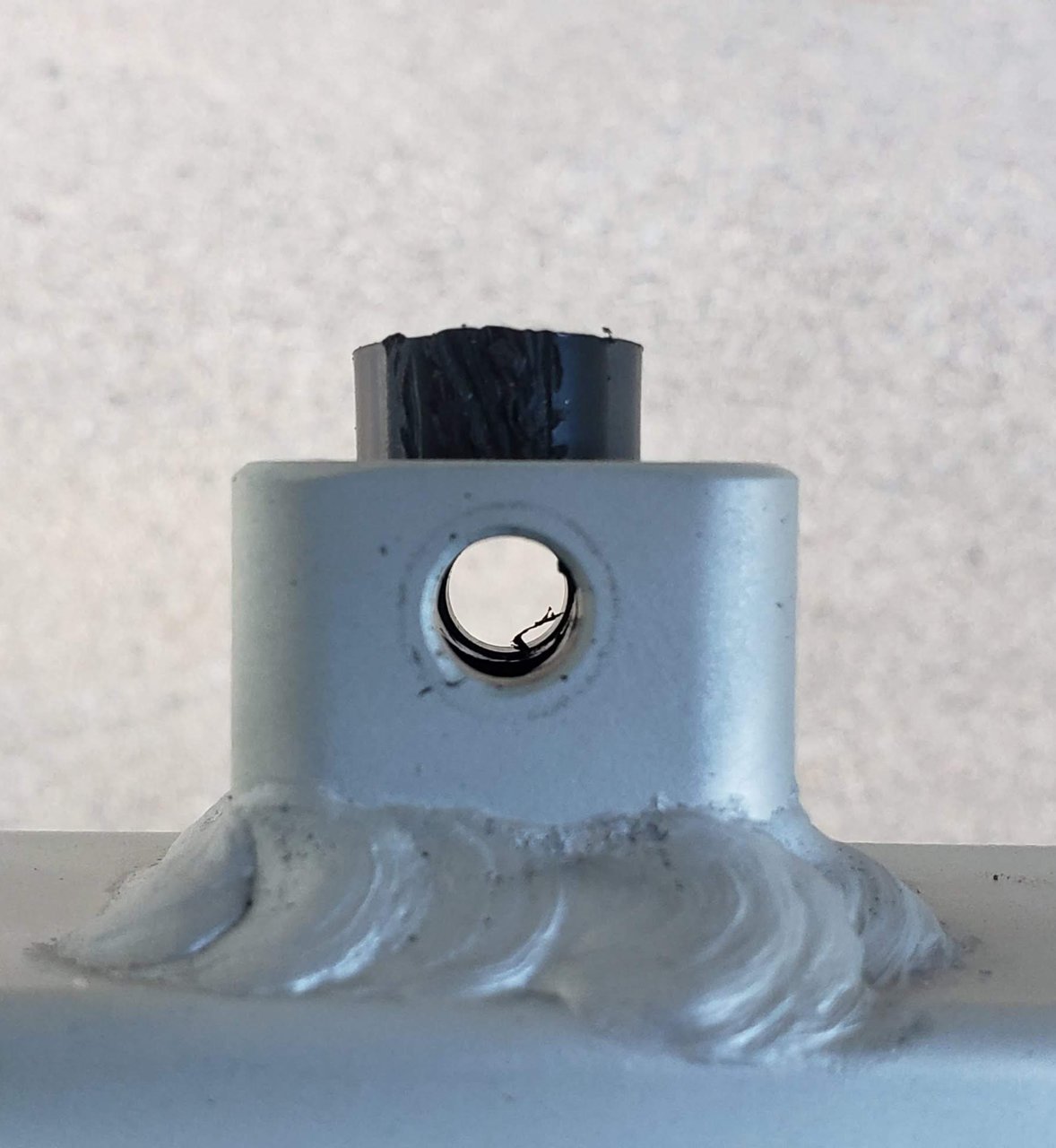

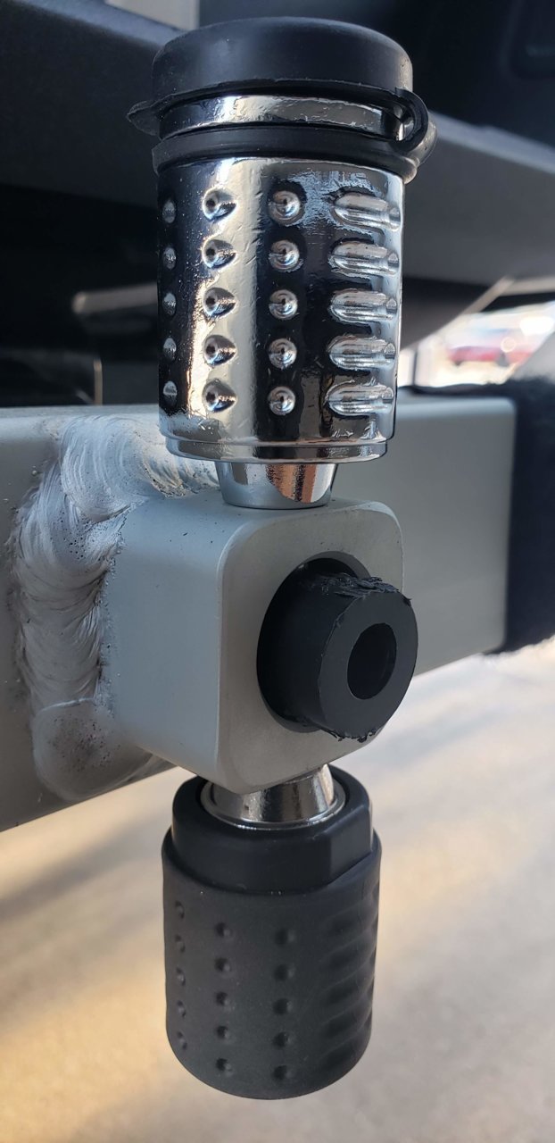

    Thread lock help?

    I actually took a slightly different approach.
    I had a nylon spacer that I use so even though the lock bolt backs out, it can only back out so much. Here's a couple pics.

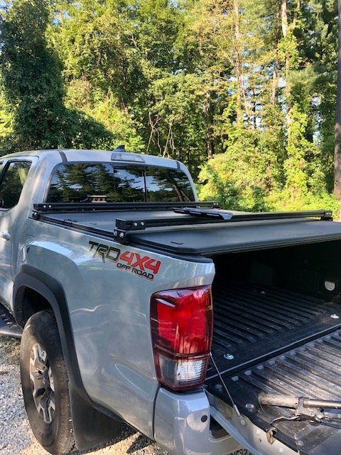

    Pieced together some parts for a low pro above tonneau setup. Sit much lower than Billie Bars or KB Voodoo, and for about half the price

    you should make a write up for this, i can’t be the only one interested. looking to get a similar setup; debating between this or a hitch mounted rack at the moment.

    I like this setup. Would you mind sharing your parts list and source?

    No problem. I used the KB Voodoo tonneau brackets and then everything else I pieced together from TNutz (Aluminum extrusion, hardware, end caps). Then fork mount and rear tire tray and I was done. Crossbars are the Black 15 Series (EX-1530). I found the 64in length for both bars worked perfectly for this setup. For hardware, I used the 15 series drop in tnuts (M6) and then just ended up buying the M6 bolts and washers from my local hardware store. I'm almost certain the bolts were M6 x 16mm. Shoot me a PM if you have any specific questions on anything.
    All in without the fork mount and tire tray I was somewhere in the $260-$275 range, but this was a full year ago. KBV and Tnutz have both raised prices on everything since then.
    Tonneau Brackets: https://www.max-modular.com/attachment-brackets/tonneau-brackets
    Crossbars: https://www.tnutz.com/product/ex-1530-black-2/

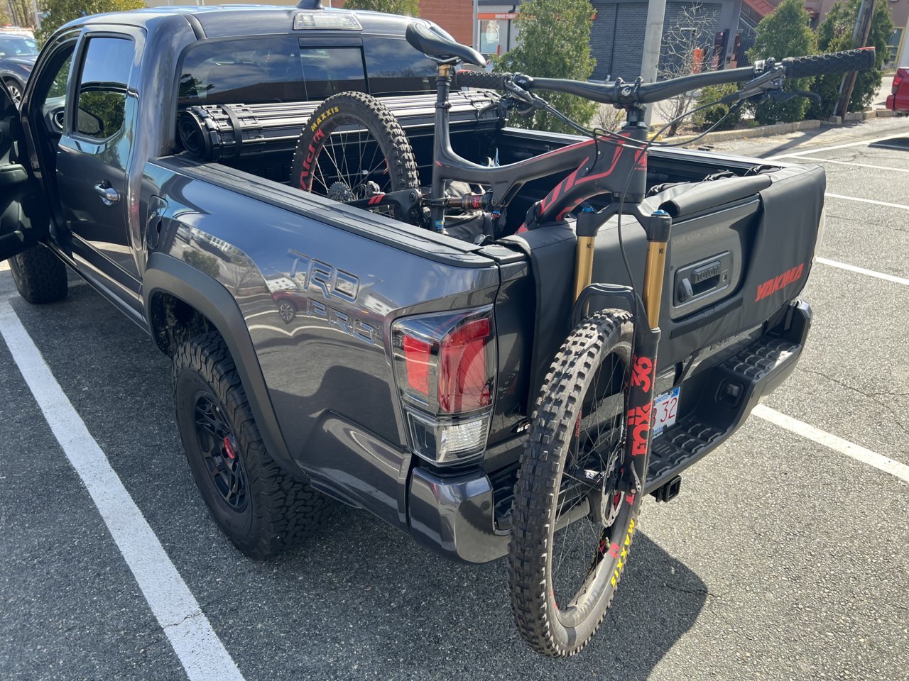

    898A644C-676B-4F97-A61A-143CC0E67DE3.jpg Loving the Yakima so far. Very stable.

    How does it work with the roll top tonneau closed? Is that a Bak Revolver X4s?

    Yeah, it’s an x4s. That has been a bit of a pain in the ass itself but it seems better than other ones so I’m figuring it out. I’ll make a post at some point. It totally clears the rear wheels of my xl pivot so it’s a non issue with bikes on it. I just take the Yakima off to close the cover and chuck it in the bed. You couldn’t close the cover with it on.

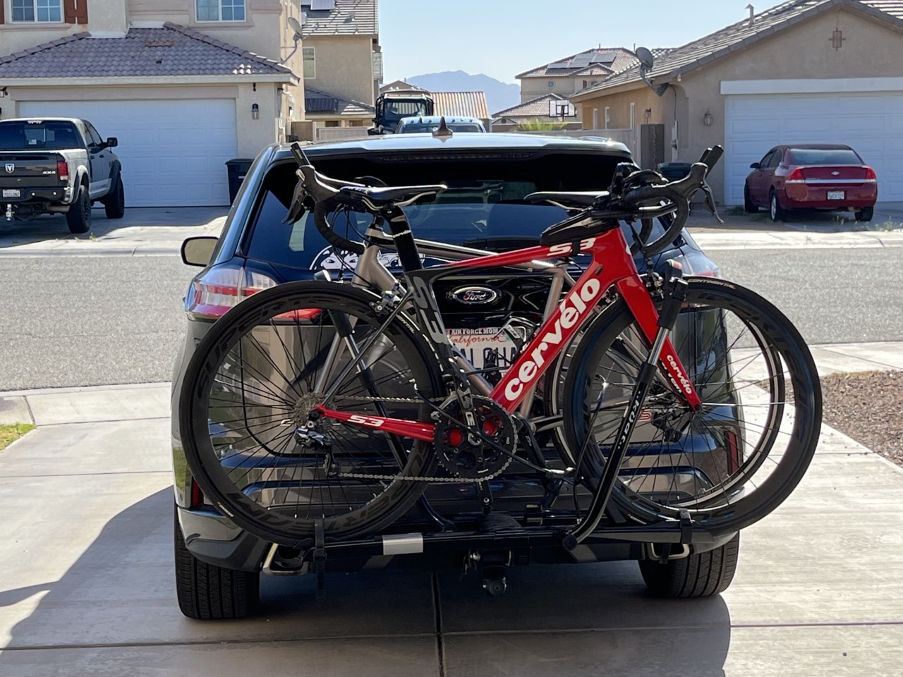

    Work in progress...
    I tried all the other ways and then I figured, all the bikes and miles I travel, just get what Ya need. Kuat, it is really handy because we can take the Wife's vehicle when we want.
