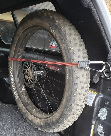

    or the wheel spends a cold night at the trailhead

    Still a far cheaper situation than a bike slammed into the side of the garage. YMMV. Haven't had that sort of senior moment yet, and if I do it might be time for a recumbent tricycle...

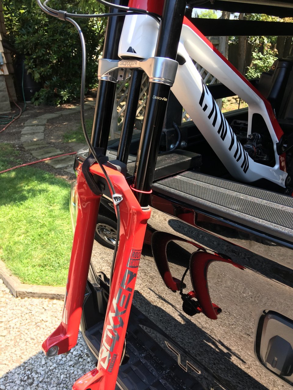

    Thanks @calzonical! I'll dig around the used/spare bike parts bin my wife says to throw away or donate but I tell her no way, this stuff will be useful someday.

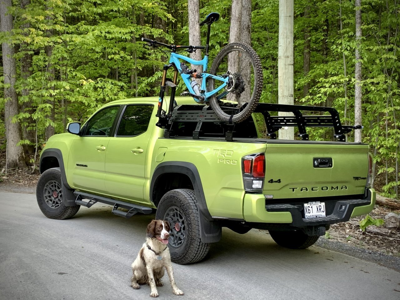

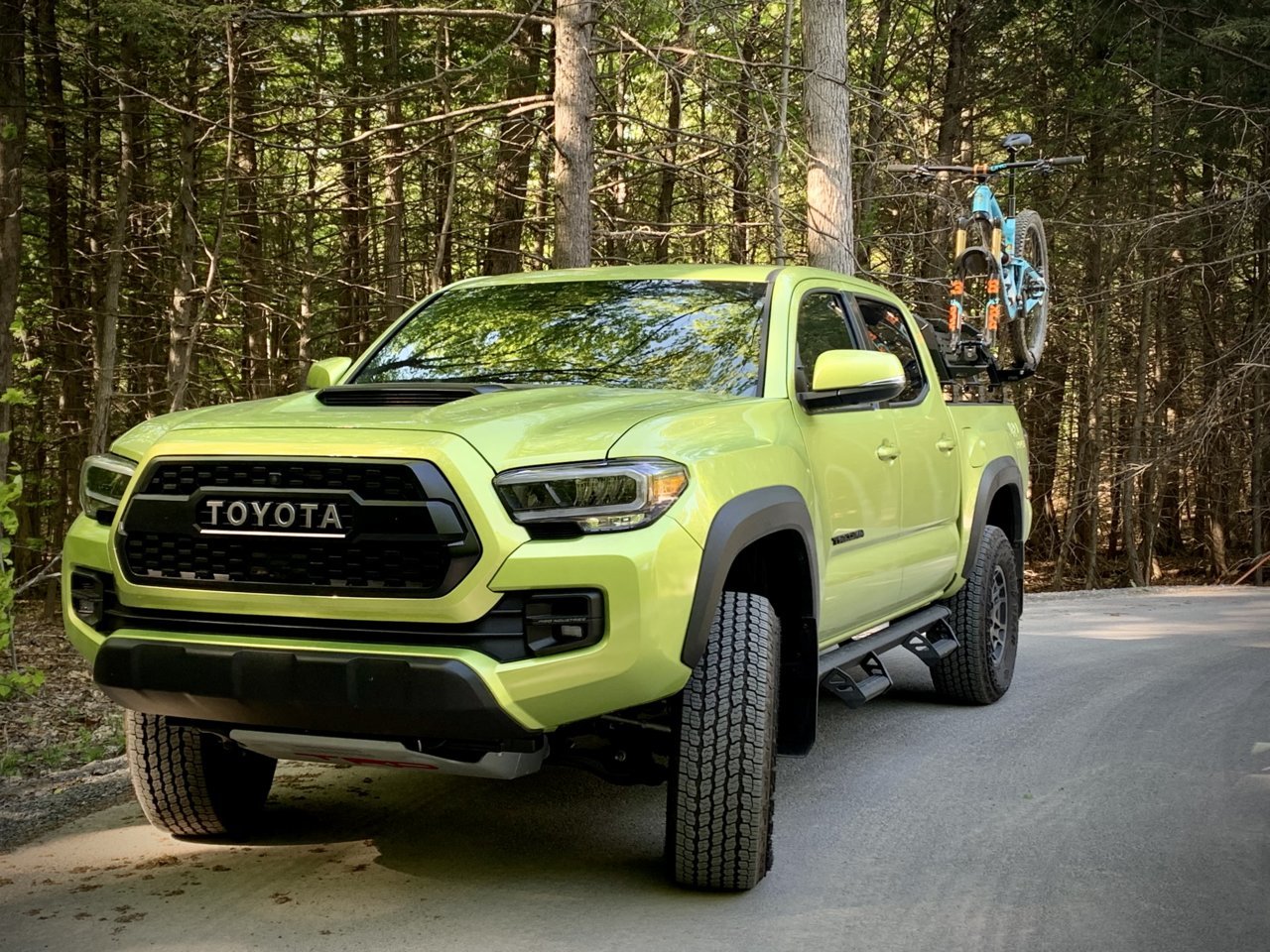

    Finally got the RCI bike mounts. It looks cool for sure.
    Drawbacks are probably that it will take more time to setup (4 times per ride), bike is more exposed to elements (compared to the hitch rack) and I have to think about the wheel. This bike mount feels much safer than the hitch rack, though. Both for stability and crash avoidance.
    My son’s bike is coming this weekend, that should be sick.

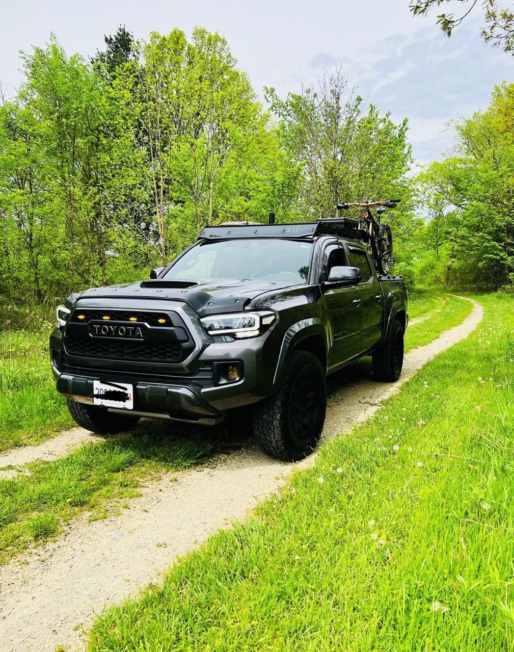

    Nothing crazy!
    Quick ride in the forest preserve close to my house:

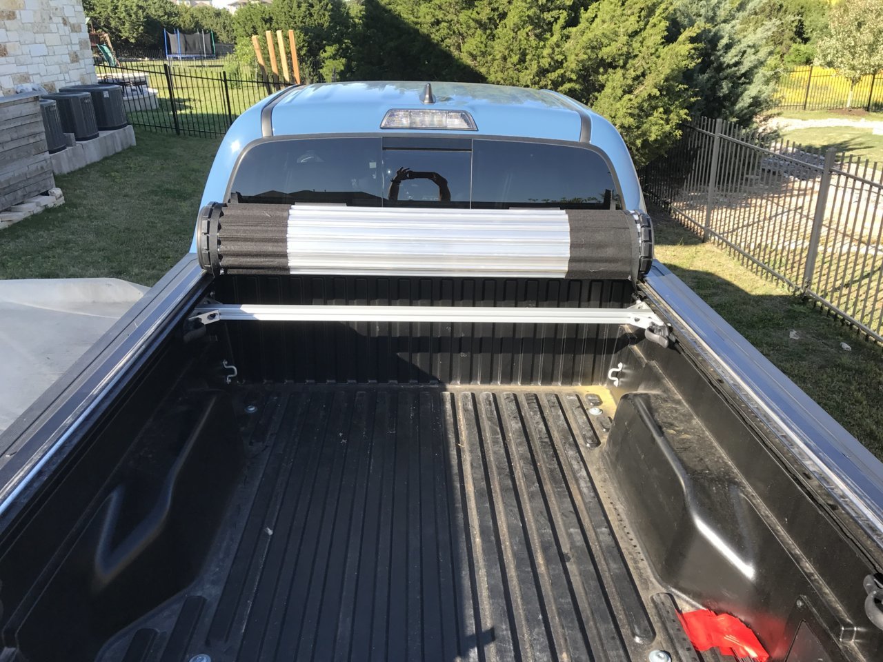

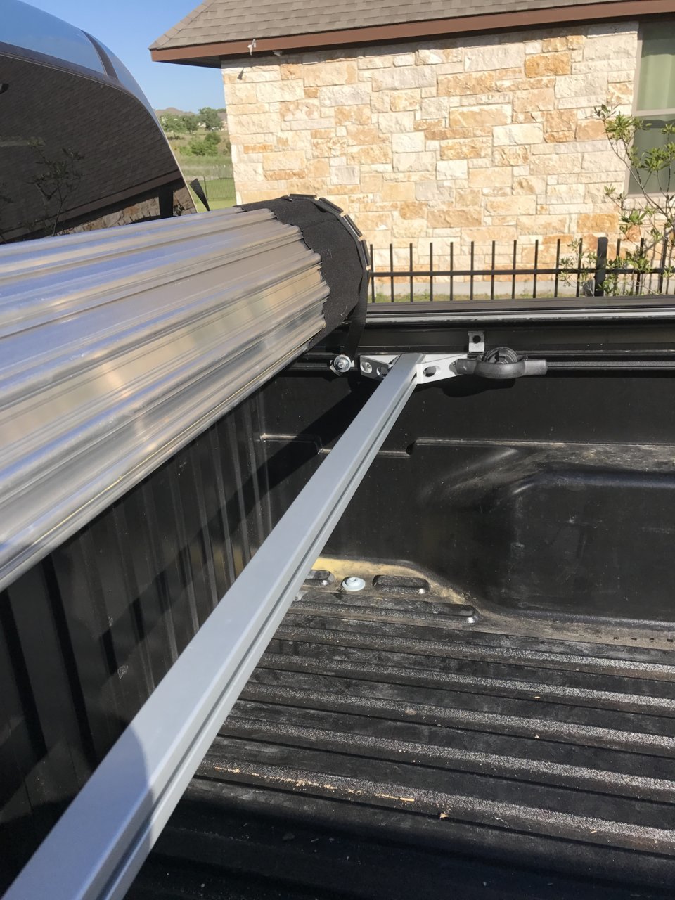

    Had a few people ask about the aluminum crossbar so figured I'd share the info with everyone...
    I got it via Amazon but here's the manufacturer's link:
    https://8020.net/1515-ls.html
    Corner Brackets:
    80/20 Inc, 4336, 15 Series 4 Hole Tall Inside Corner Gusset Bracket
    Crossbar:
    80/20 Inc, 1503-LS, 15 Series, 1.5" x 1.5" Tri-Slot x 60" Aluminum Extrusion
    Fashioned some blocks with t-nut fasteners from an old plastic cutting board that slid into the track and secured everything with security bolts.

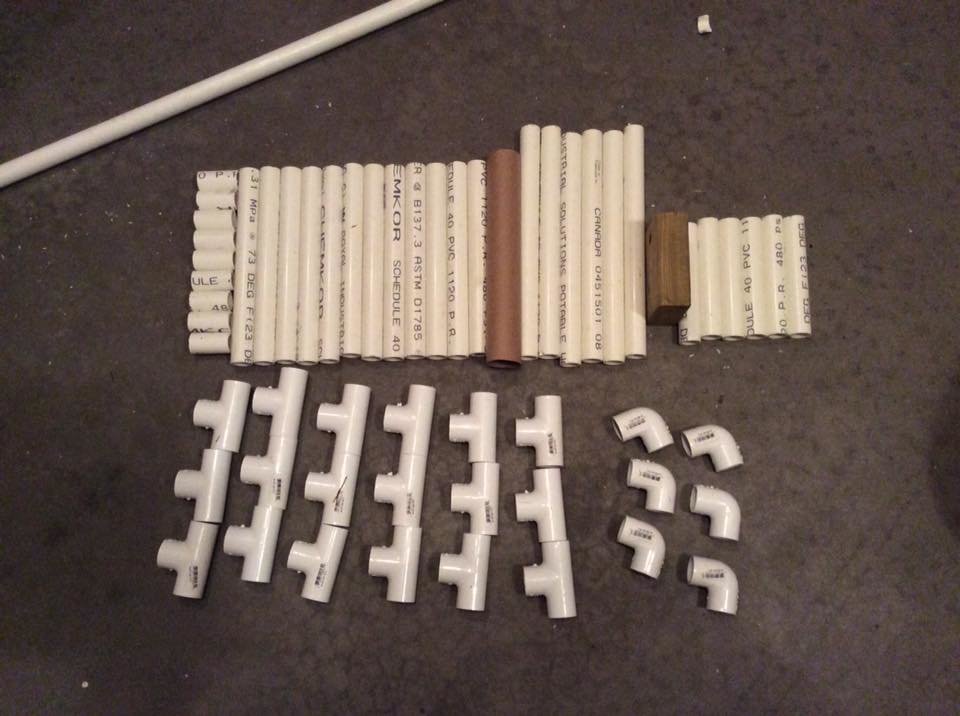

    Years ago, I built a simple bike rack using PVC. It was a fun little project with my (then) 11 year old son. The end result works great, was super cheap and is still going strong.
