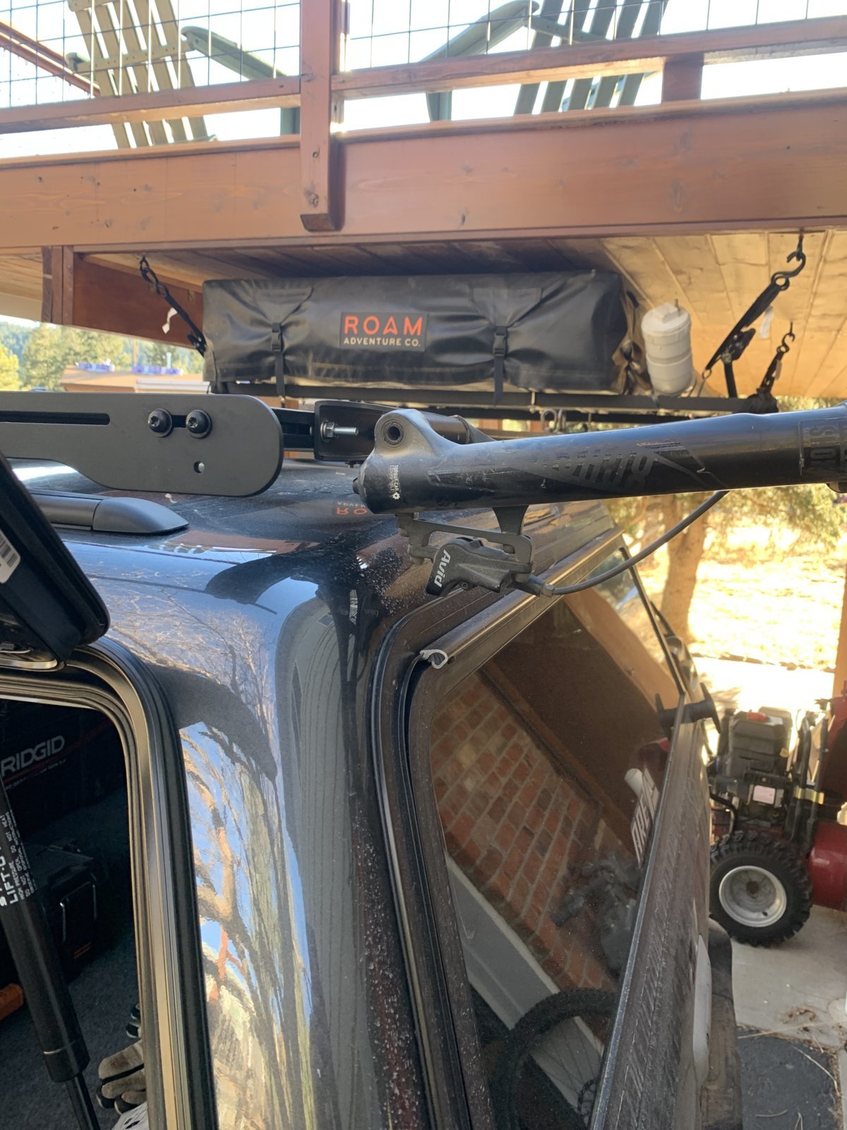

    Have you had any issues with the mount hanging the bike like that? I was thinking of doing something similar of the prinsu top rack on the topper. I have test mounted it but haven’t driven down the road yet. It’s the Rocky Mounts HotRod fork mount. Was thinking I would use a titan strap for the back wheel on the bumper. What’s everyone’s thoughts?

    No issues so far. I also used strap and a little homemade bracket to secure the back wheel.
    Just drove from Ohio to Colorado last month, no issues

    Okay cool, good to know. I’m waiting on a response from Rocky mounts and their thoughts. I like the idea of not having a hitch rack always in the way of the tailgate at camp.

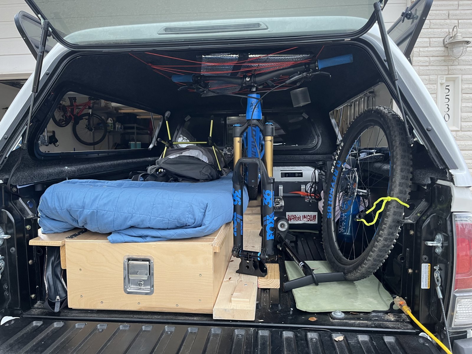

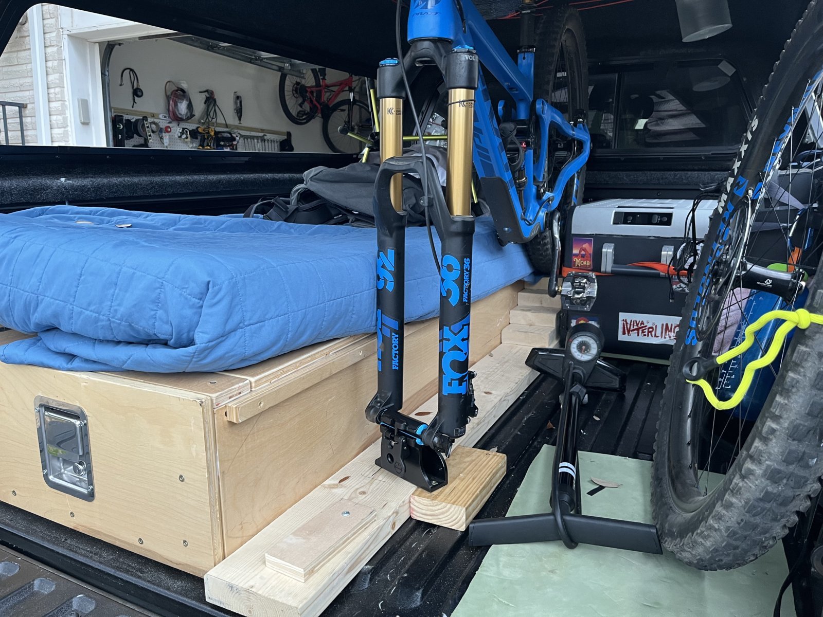

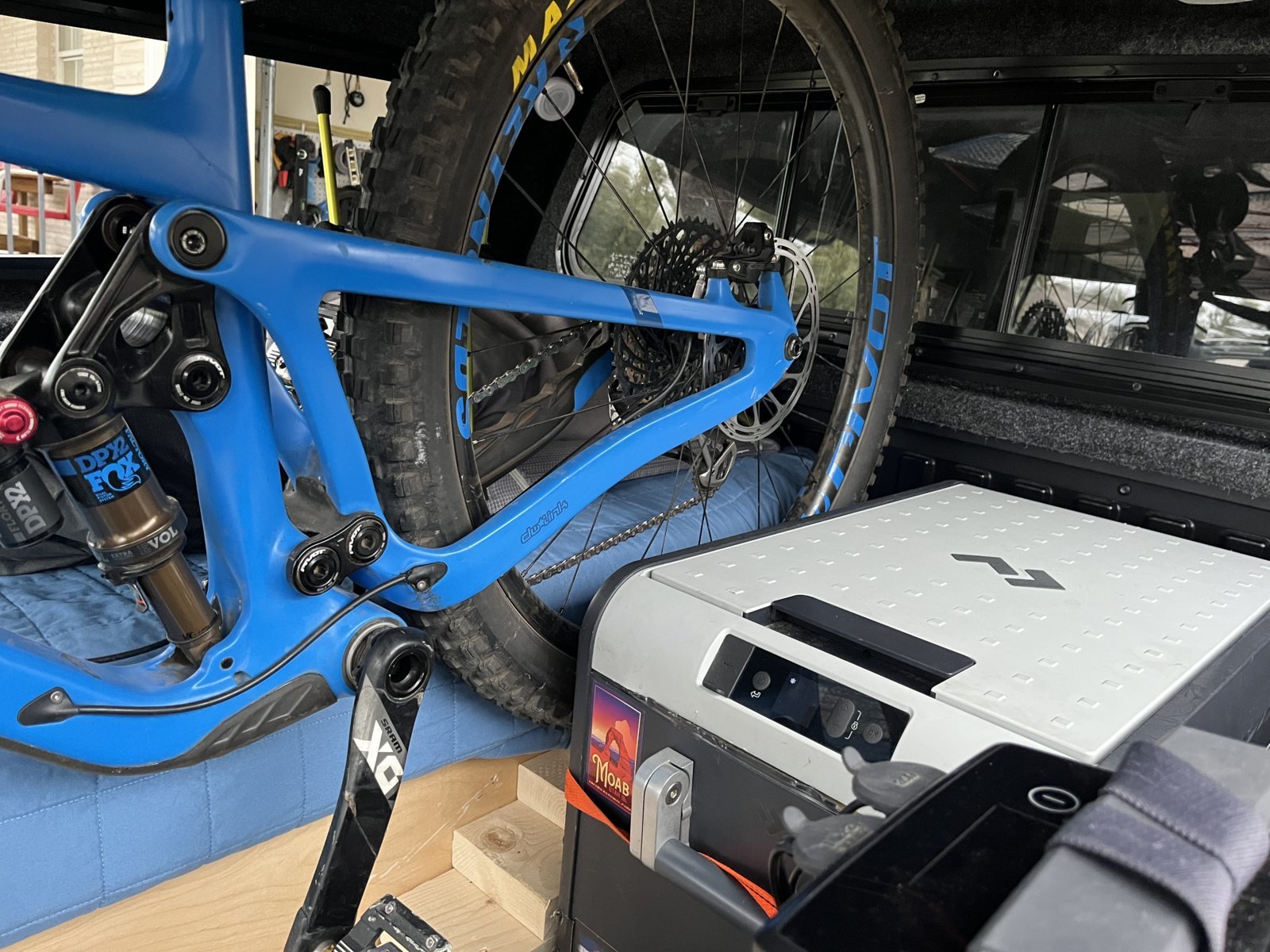

    Cross posted from the “Sleeping in your camper” thread…
    Pivot Switchblade, 29, medium. DCLB.
    This is my set up. The board with the fork mount ramps up under the back tire so the chainstays and derailleur aren’t in contact with the fridge. That same ramped-up section of the board is wedged snug between the fridge and bed and it keeps the rest of the board from tipping or sliding.
    Sometimes I keep the fridge in the truck cab and that gives me more space to move the bike over to the side and have more room if I need to sleep with the bike inside.

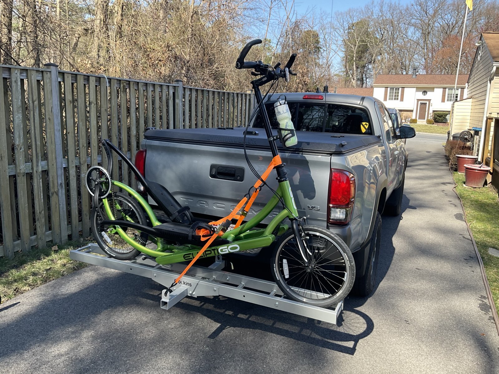

    Not a mountain bike per se, but my ElliptiGO. Use rubber coated wire ties to secure the wheels to the carrier (not shown in pic). Very stable.

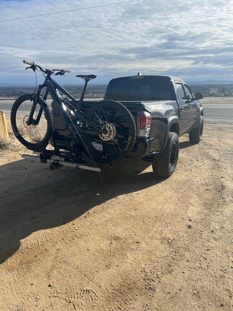

    Nothing crazy!
    Using my 1Up rack for my quick rides.

    how do you have the drawer anchored near the cab? so it doesn't tip when you open the drawer fully.

    A thick eye screw in the side of the cabinet and a turnbuckle attaching it to the D-ring in the truck bed floor. One of those near the cab and one at the tailgate. So it’s only anchored on the left side, the outside.
