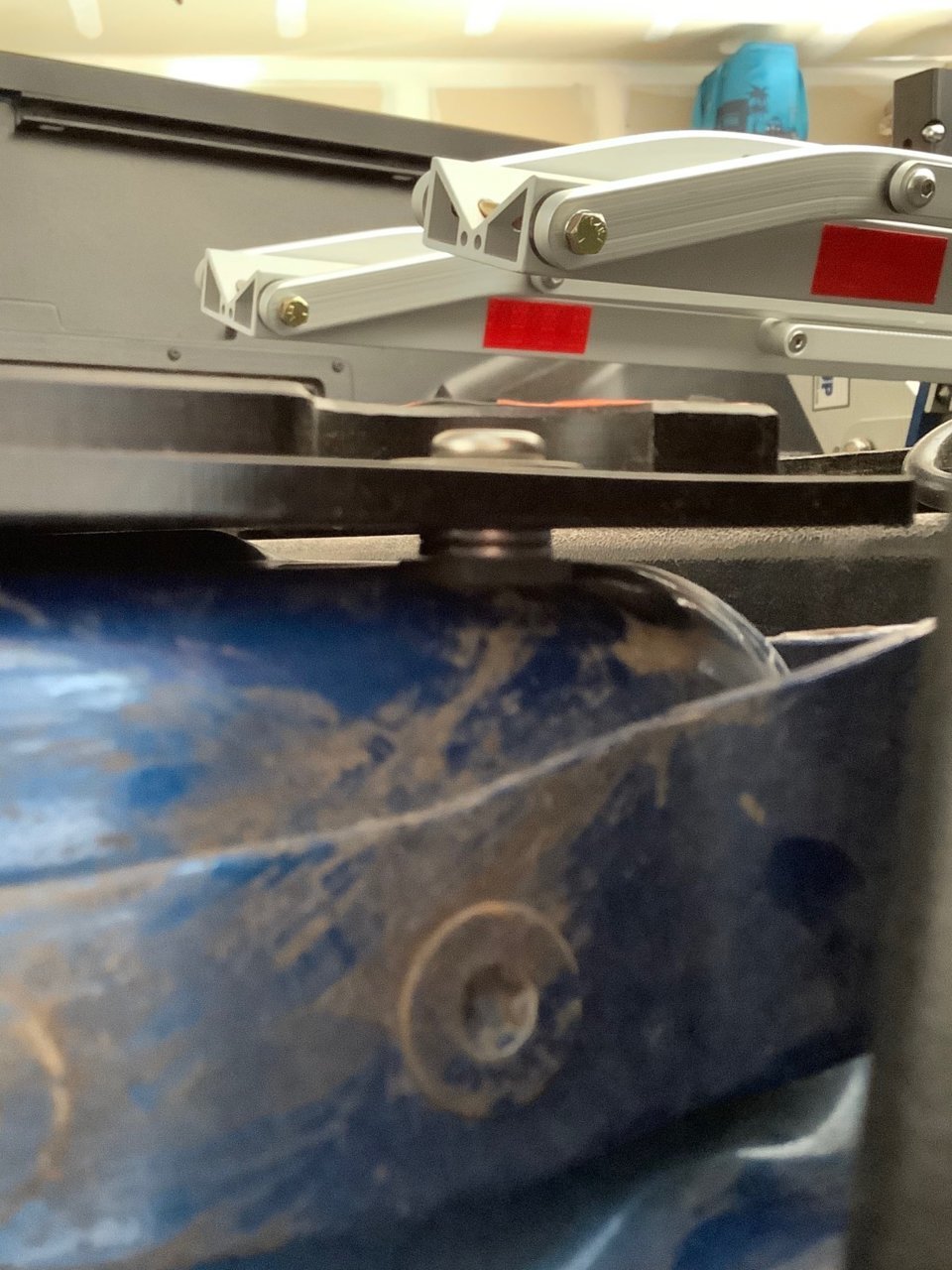

    Yeah, this thing wasn't thought out too good. I ended up using some washers to fill the gap between the tailgate and the Mountain Hatch and purchased longer screws. They should have engineered this better and or provided the right hardware to make it work. I emailed them letting them know that the screws weren't long enough and my Mountain Hatch warped a little and pulled the screws right out. You think they got back to me? Nope! Terrible customer service and highly recommend everyone avoiding this vendor. Eventually their poor design and lack of customer service will catch up to them. mh.jpg
