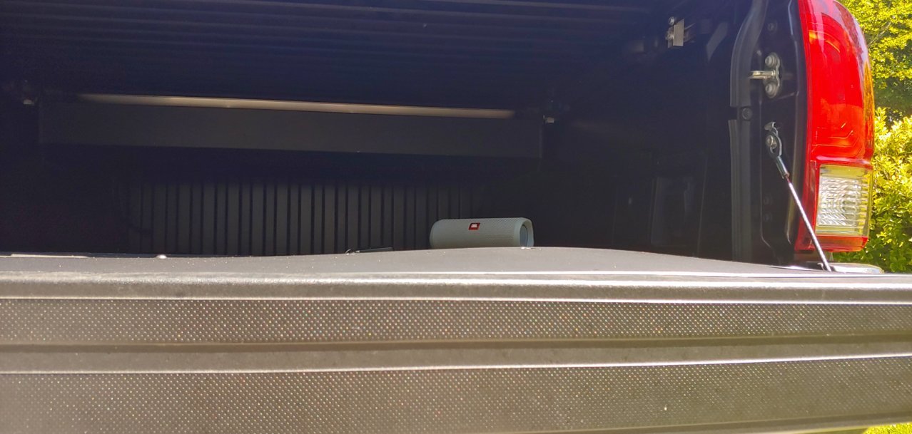

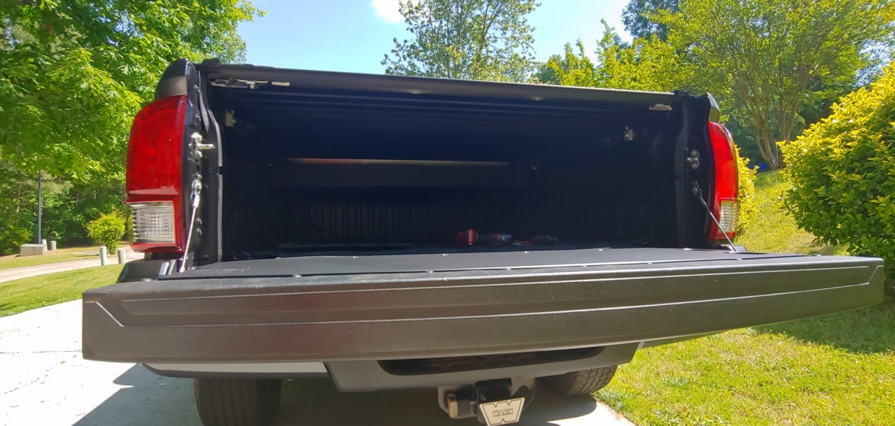

    I recently installed mine. A few months ago they had a sale on the blue hatch. It does not match my trucks color scheme in any way, but that doesn’t bother me too much. It was a good deal and the flat surface is very nice. I think that food grade material drives up the price tho.

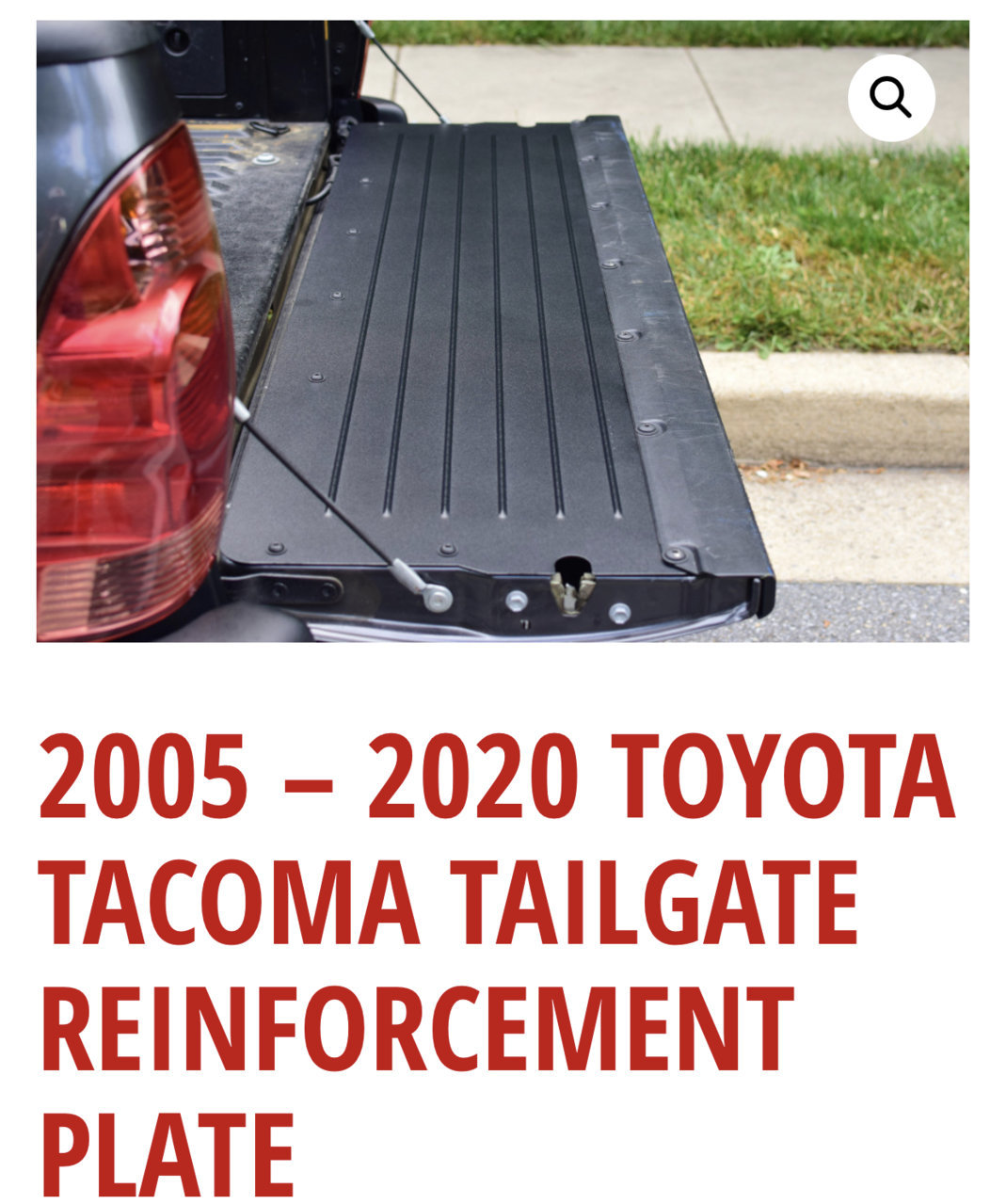

    Recently noticed that mobtown also makes a flat reinforcement tailgate panel for less money made out of metal instead of plastic.
    https://mobtownoffroad.com/product/2005-2015-toyota-tacoma-tailgate-reinforcement-plate/
    Edit: added picture
    Hatch don’t match

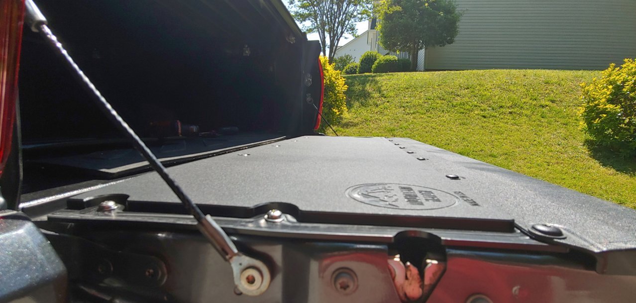

    Anyone have problems with the length of the top screws? I could barely get them to bite. Tailgate sat open in the sun and the panel bowed up and popped out the OEM white plastic nuts. There doesn't seem to be enough of the screw in the nut to flare out the prongs to stay in. I may need longer screws.

    Right, but those ridges aren't gonna do your knees any favors. ;)

    Had the same problem with mine, and ended up buying some longer Philips screws at Ace to go along that bedside long edge. Problem solved.

    I agree with you. The length of the bottom OEM screws (.50”) and their shape, not having enough width to expand the insert. (lag screw and pointed)
    Causing the plastic inserts to pull away from the tailgate.
    The sides / top of the tailgate screws held fine.
    My remedy was replacing the six factory screws with six button head 1/4” -20 x 1” screws & new flat washers.
    Getting the new screws started was a bit of a pain. It’s now 100% secured.
    I used a black sharpie to paint the screws / washers.

    Mobtown can be ordered with or without ribs. Want smooth metal - you can have it (just not as stiff as the one with ribs)

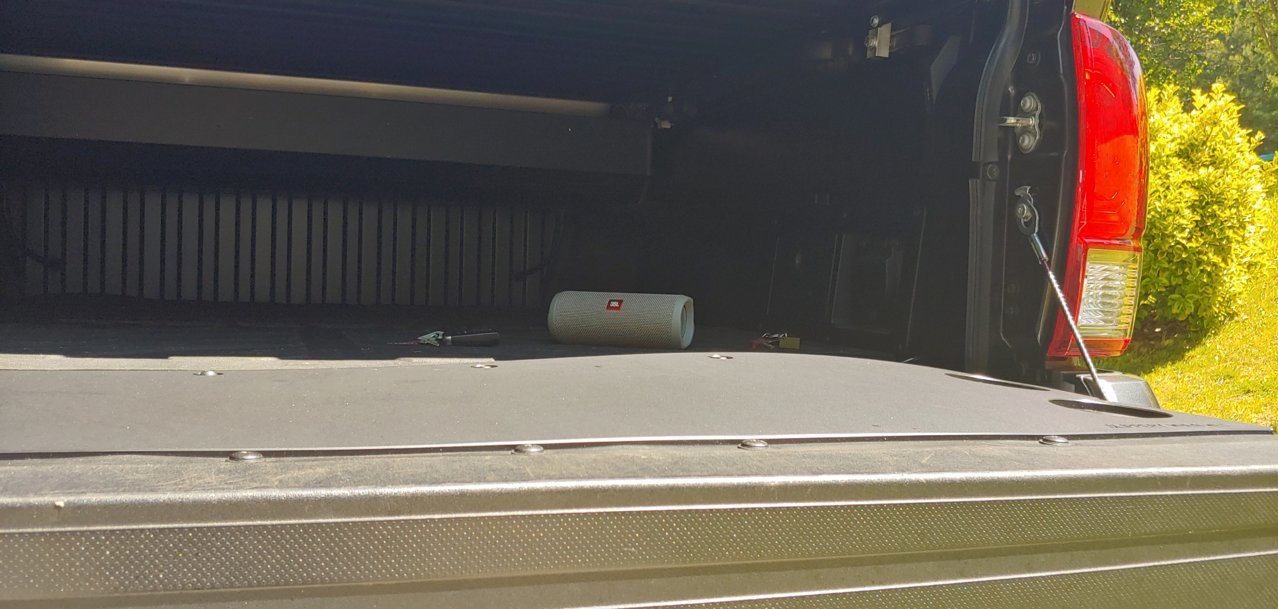

    Fixed. Appreciate the advice.
