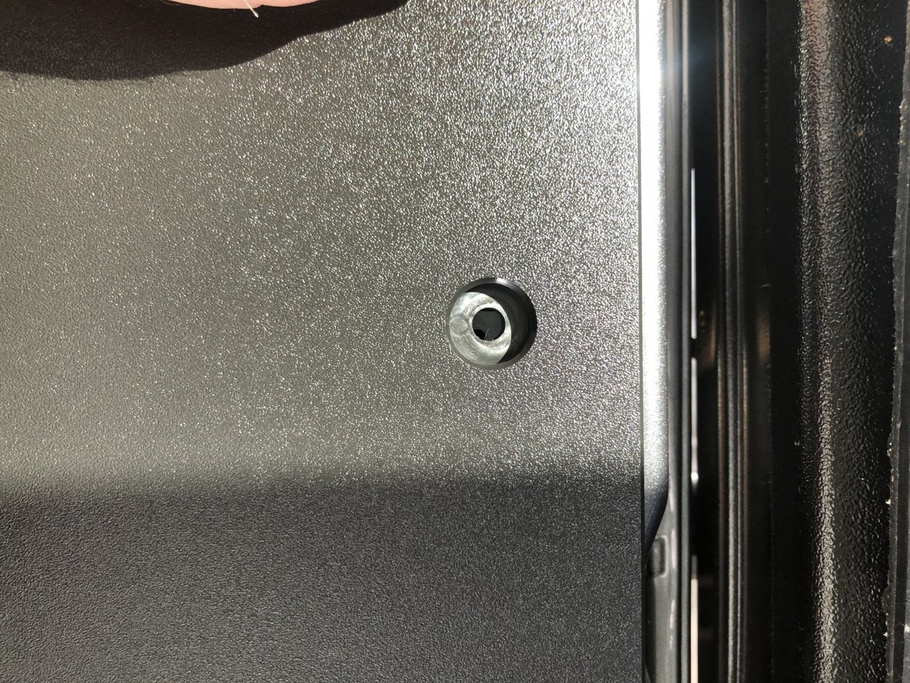

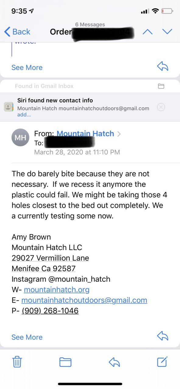

    ive said this before… the holes on the bottom row don’t line up as it lays flat. You are told to start on the corners and angle the screw to the hole (it does work but I don’t think it’s ideal or proper). Then the recesses for the bottom row screws aren’t deep enough to properly engage/thread into the plastic clip nut (it does thread but I can only imagine the first or second threads actually catching) which means the factory hardware maybe too small- now I’ve taken the tailgate panel off many times prior to getting this version hatch so my plastic nuts very well could be worn out so I have some new ones that I’ll replace and see if it grabs better on new nuts. If not then I’ll resort to new/longer screws but ideally I’d like the same exact except longer which maybe hard. The explanation for the shallow screw recesses is to prevent cracking of the panel but I feel as if only 3-5mm wouldn’t compromise strength and be just enough to engage the threads decently.
    those are the only 2 things I have noted and I’ve had it for awhile now (also had another companies plastic panel).
    fitting, bowing, modifying and hardware for your listed negatives are explained in my 2 noted issues. It does fit but the bottom row doesn’t perfectly line up which explains the Bowing because the screws are more at an angle and the fact the recesses are shallow making them possibly pop out thus the bowing. Don’t have to modify the panel just longer screws which if the threads engage better and not pop out then you won’t have the bowing issues.

    couple things on this, when I installed my mountain hatch panel, the holes all lined up perfectly, so not sure what you’re talking about them being off. Secondly, I used an impact putting my screws back in and they all engaged enough to trigger the impact. I think the issue really is, as you said, you’ve worn the plastic nuts by previously removing your panel over and over.
    I have zero warping with my mountain hatch, it fit perfect, and the screws engaged more than enough. I am 100% satisfied with my panel.

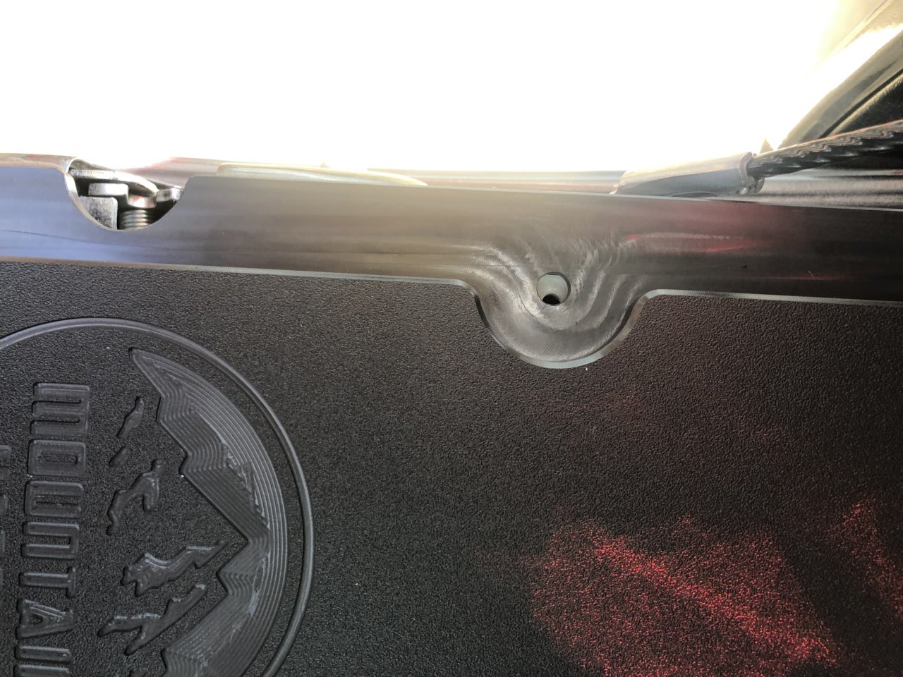

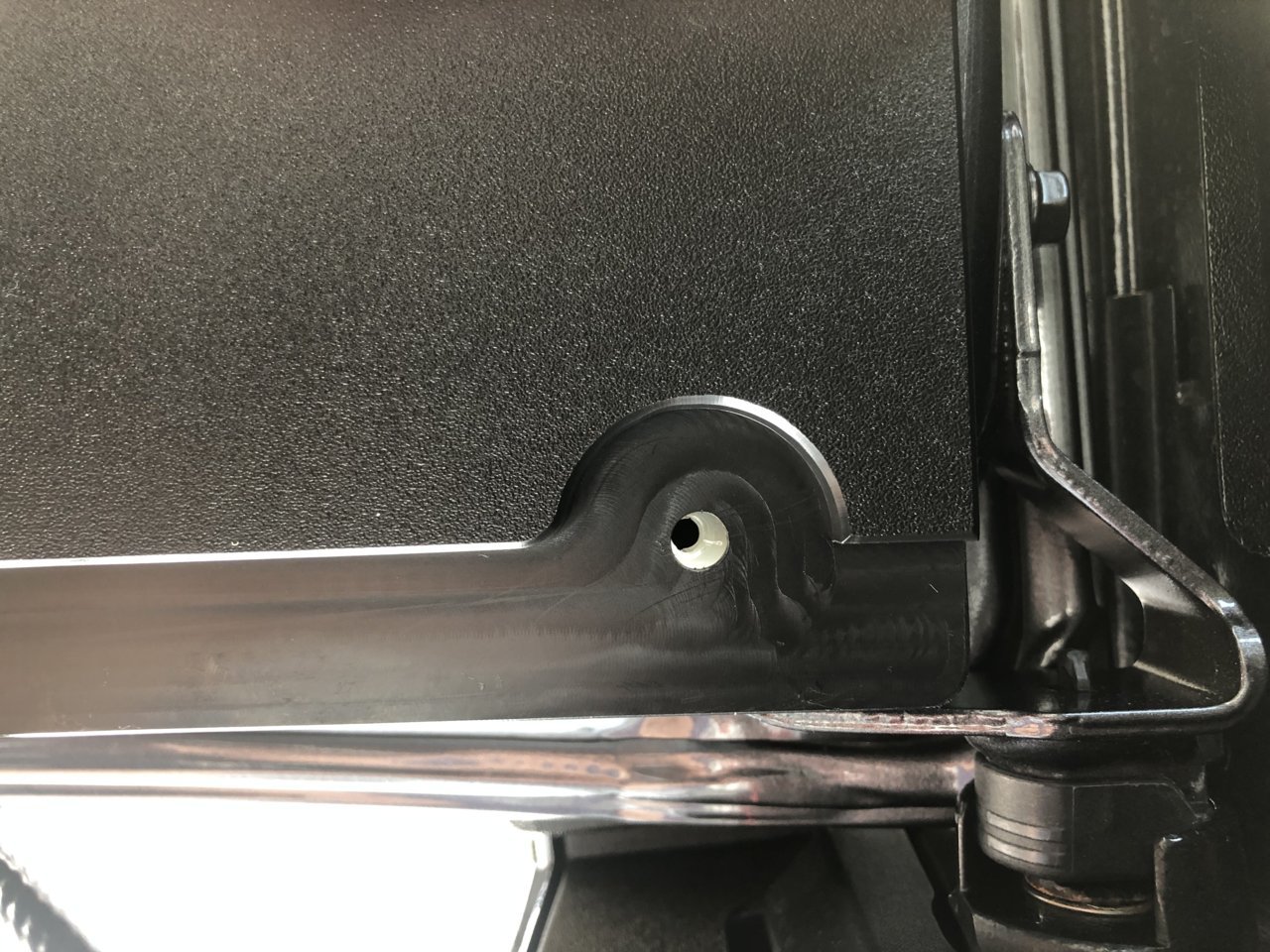

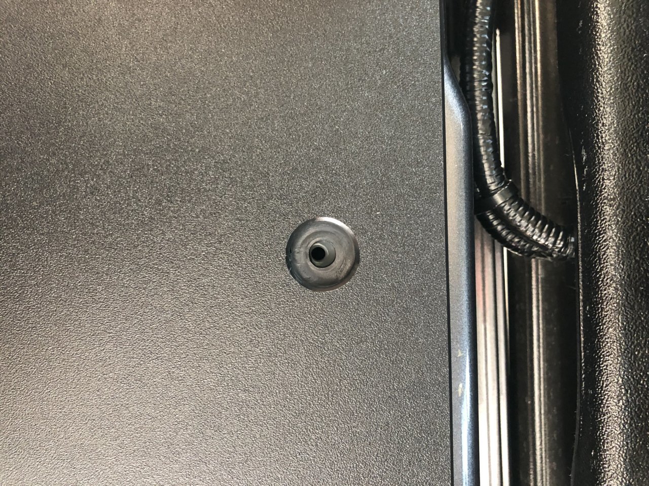

    That is interesting with the holes perfectly lining up…
    Pictures in order starting bottom right
    0F2856E9-49EE-4921-957B-229CBACD5630.jpg 67254F5E-30B4-41A4-B25D-6915BAB31AF8.jpg D5AD04FD-0838-4B42-B374-87C04F7A5E56.jpg B75866F5-308D-4875-B425-990BE10239C8.jpg 5581DF6C-05E4-41D9-9D07-100B9F59282C.jpg 6F2A0CA7-3FA5-4B87-8B43-F2067EA23396.jpg
    ^It does gradually get worse as you can see.
    these next 2 are the middle edges, right then left
    253E02E9-C5E2-4DA2-AD83-903C97AFF460.jpg 913EDBBB-4159-49AA-9581-951E4246363F.jpg
    then the angle of the screws because of the way it lined up (They did all lay flat I believe when tightened).

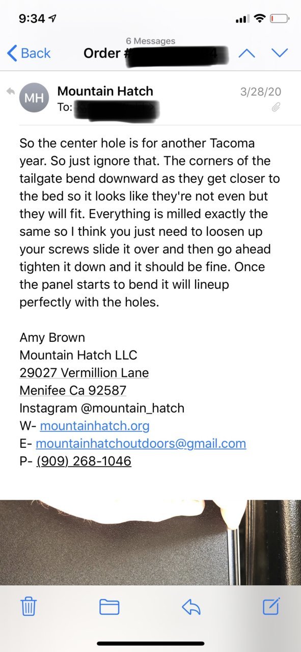

    This is the response when I inquired…
    And to be far, I think when these pictures were taken I had tightened all the top screws and then when I loosened them to do the bottoms (as the email suggested) it maybe wasn’t as bad. I didn’t use an impact because I was worried about stripping and since the install, 1 of the screws did pop so the threads aren’t engaged. I agree, not many people would be taking that panel off/on as many times as I have so I’m sure the nuts are worn and could be at least part of my issue (I know I stripped some on the top from the old panel from tightening it down to much). I really need to swap them over and test it out (will update when I do).

    Nah, tailgates are the same (I mean there’s always possible slight variations but can’t be too much I’d imagine). And based on the emailed response saying all are milled exactly the same (minus I requested no cup holders), I also assumed everyone’s lined up the same
